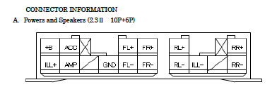

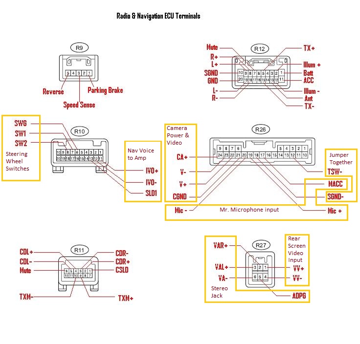

I ran into the same problem when I did the install over the summer, you need to connect pins 2 (ILL+) and 12(ILL-) from the R12 connector (20 pin harness on the vehicle side) to their corresponding pins on the 10P+6P (ILL+ and ILL-) on the head unit side. See the pics below for reference.
Also, you can use a multi-meter to verify by probing pins 2 and 12 on the vehicle harness. With the headlights on you it should read +12-13v and with the headlights off it should read 0v.
Hope this helps.

So not to be confused, pin 2 & 12 are on the factory 4runner harness and 10P+6P are the FRS pins on the head unit correct?
