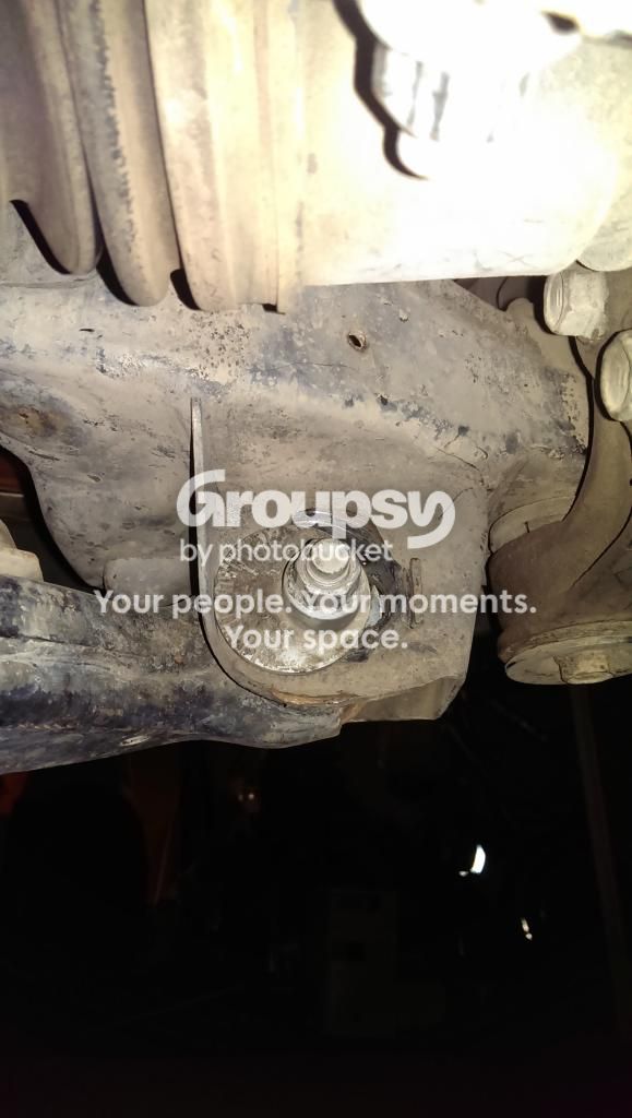

I finally got to do some work on the rig tonight. I've had one hell of a time keeping it aligned. I've got a 3 year alignment contract with Sears (no firestone here) and it seems to work for a while and then it's off and my tires keep wearing more on the inside and feathering. It is irritating. At least they're cheap tires right?
Anyways I've had a clunking on the passenger side sometimes and I hadn't been able to diagnose it. I got it aligned on a road trip about a month ago and it still had problems wandering so I got under her and had my wife shake the wheel. There was tons of play in the passenger side lca. Bushings were shot.
February of '13 I rebuilt the front end but had a hell of a time with my lca bushings on the drivers side and I thought about doing the passenger side and said screw it. They looked fine. Live and learn.
So tonight isn't too bad, it's only 86* at 2am. I started around 10pm. The only problem I had with the replacement was I couldn't get the cam sleeve and bolt out of the rear without unbolting the steering rack. When I undid the boot look what I saw:
IMAG0136_zpszajsbjji.jpg~original

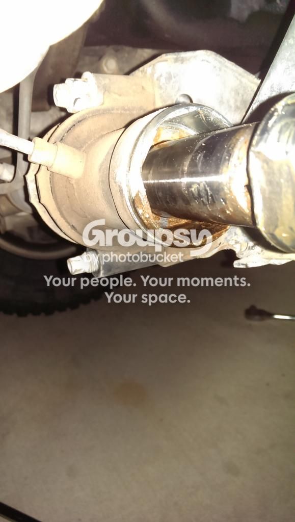

So I think that pool of atf tells me replacing a steering rack is in my future.
Everything else was a breeze. The cam sleeves slid off like they were buttered. There are some things that are really great about living in the desert. The old bushings popped right out and the new ones slid right in. I used a bottle jack between the bushings to press them out and then I used my bench vice with 2 pairs of pliers to press the new ones in. My sister helped and 2 sets of hands were very nice.
When I did the front end work I used Autozone lbj's and one already crapped out on me so I replaced this one with an OEM while I had everything apart.

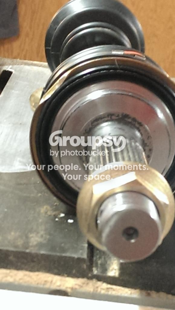

Then as I was reassembling everything I noticed I tore a mighty fine hole in my cv boot. Crap. Well I won't be driving her till I get it rebooted. Maybe next tues or wed. I thought about getting a whole new napa axle and then rebooting later to have a spare, but I think I'll reboot now and buy a spare later.
Lastly I wanted to see how the drivers side cams were lined up. I think I found out why the alignment was off:
IMAG0138_zpsmcpquhgw.jpg~original
The cam isn't even between the tabs. Think sears will compensate my unevenly worn tires?

Practice makes perfect- glad to see the rt lower control arm was a 'breeze'.
Wish I'd kept my oe cvs and rebooted them rather than get the rebuilds. Ah well, now I've got a junkyard axle off a lower mileage yota for a spare plus those rebuilt axles off the 96 for the 99.

I figured I'd go napa reman and then reboot this one and then put is on the drivers side (boots don't look good either) then reboot than one and have a spare.

I looked more at that cam adjuster and the cam on the sleeve (front side of the above picture) is off 180* from the cam nut that is in the picture. How that works I don't know. They are keyed to fit only one way. Damn sears in Provo (last alignment shop).

Only one of the trucks will fit the spare cvs I have, finally went manual hubs on the 96, got sick of chewing boots, though stretching them helped immensely. I'll also be able to unlock and drive home to repair in the comfort of my own driveway. Less worries for the 96 and more cvs for the 99. :D

Well I finally got the rig back on the road. I did hit a small problem when I was putting the replacement in. It came like this.
IMAG0155_zpsapmugzsq.jpg~original
After research and starting a thread, the consensus is to just bend it back where it wont scrape the add engagement tube and put it in. Seems to have worked so far.
I got it aligned yesterday and it drives straight and doesn't have super squeaky bushings, which is nice. I told the shop about the cam adjuster being 180* out of phase but haven't checked to see if they fixed it. I was out hunting when it got done and I didn't pick it up. They also didn't give me an alignment report. Lame. I'll have to swing by and get one today.

Hab - When you stretched the boots, what kind of new clamps did you use? Also with all those extra cv's for the 99 are you going to get out and break some? I know you said that it had some big updates coming but I haven't seen any yet. Did he decide he still likes volvos better?

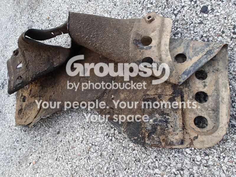

The hubby crumpled the 99's rear stock skid into a ball when we went wheeling this weekend, I think he's trying to tell me something.... :D

So far neither of us has broken a cv, just me and my stupid boots. Knock on wood! I used small thin hose clamps out of a Land Rover Discovery (boneyard freebie) and wire rather than trying to glue them as others have done. Did the trick for me alright. All I needed to do was get the lobes generally apart so they'd stop eating holes in each other.
Now that I've changed out hubs I leave them unlocked (not turning) until needed. I like that even better.

Good to hear you're driving straight again and hope you get something resembling sleep soon! I agree with that little dust shield just needing a little bending, have done the same.
That stinks about the gas tank. Lil skips?

Ah, sorry, it's that little skid just past the front one. Not supposed to look like:

That sleep was really good, and that skid is really not. What kind did you end up going with?
