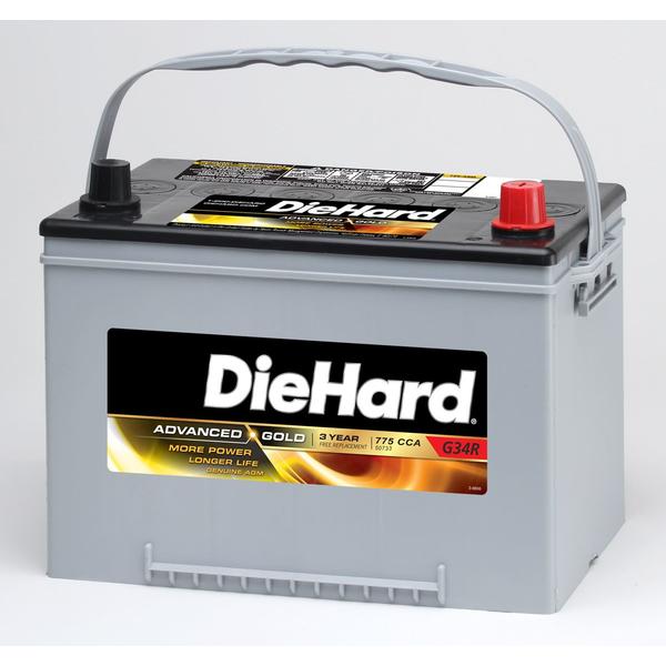

In other news I needed a new battery. I could have sworn that my Duralast gold 24F-DLG was less than 3 years old so I was in for a free replacement. When I checked my records I found It was installed in February of 2010, so just slightly out of warranty, time flies. I would get a huge $12.50 credit at autozone for it, so that wasn't a huge consideration on the new battery.
I did a lot of research and since most of the time I am by myself out in the desert I don't mind spending money to get a good battery since jump starts in the middle of nowhere are few and far between.
I wanted a sealed battery so either gel or AGM. I narrowed it down to the Duralast Platinum 34R AGM, the Diehard Platinum P-1 AGM deep cycle, or the Diehard Advanced Gold 34R AGM.
The duralast and the advanced gold were about the same pricepoint, with the Platinum about $50 more. Then I decided I didn't want rewire things for the Platinum (terminals reversed from where they need to be.) Several people had good things to say about the Duralast, but I had a credit at Sears, so I went with the Diehard.
spin_prod_601732701
It uses a spacer to bring it up to the height needed for the battery hold down, and it is still about 1/8" short on the front side, but I can add an additional spacer very easy. It has 775 cold cranking amps and 120 minutes of reserve capacitiy. The duralast has the same reserve capacity and 25 less CCA.
I haven't seen any 4runner specific reviews, but I didn't find anything bad about them, so I'll update this after a while but for right now the car starts up much faster. Also my doors all lock now, which is a plus.
