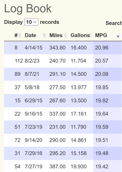

Just completed the first road trip with the new gears and I had wondered how it would fare with the change in RPM as it turns at about 2900 RPM on our interstates around here. On the full tank of gas we got, drum roll please...
20.57 MPG!
That's not only my best tank of gas with CA 91 E10 gas ever, it's the second best tank mileage I have ever got! Not only did the gears not decrease mileage, it actually decreased. My engine now never downshifts even up steep grades over 8% and the torque converter stays locked almost full-time now. All this with 500 lbs of extra people and gear in the 4Runner.

Note: CA switched to E10 back in 2016 so you'll see a lot of higher tanks before that. Many people saw about a 5-10% decrease in MPG immediately after the fuel change.

How the hell did you have a 20 gallon fill up?
