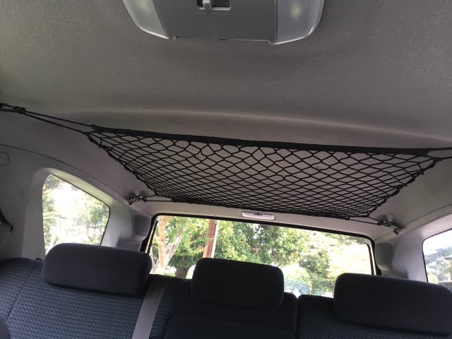

Installed a storage net as an attic today. It's a 9 Moon net I got on Amazon.

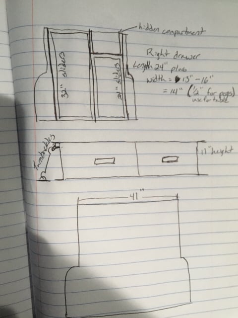

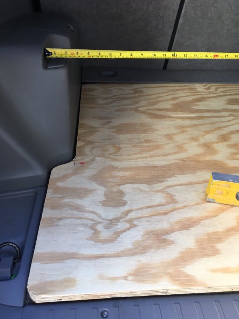

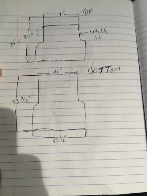

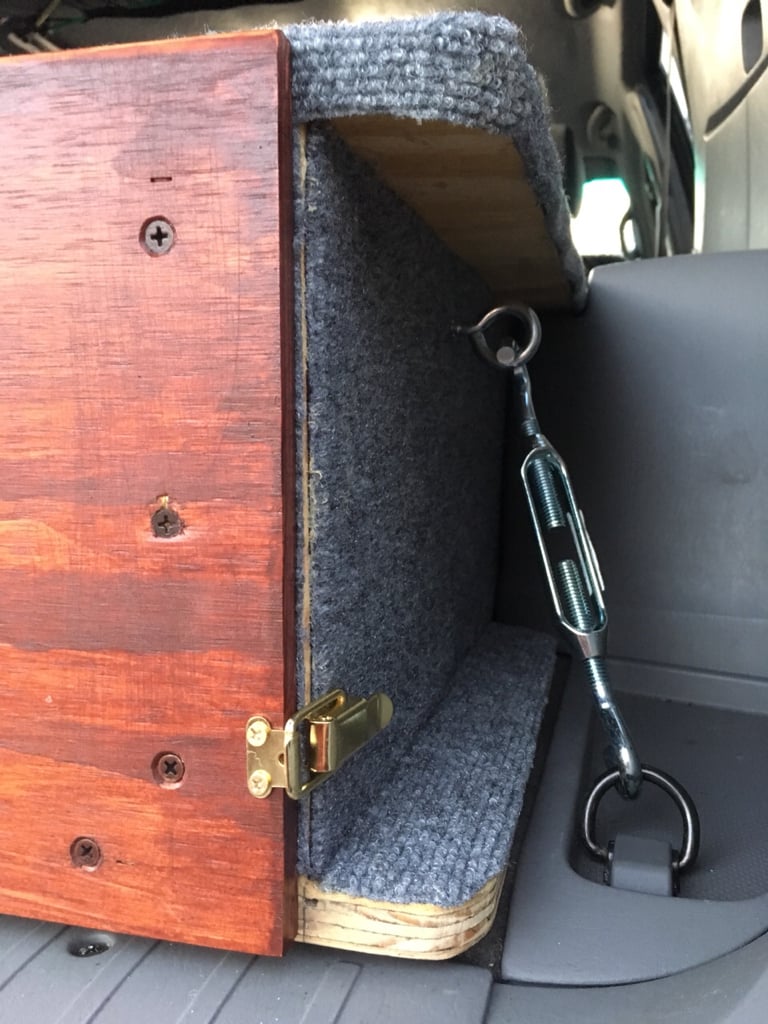

Started gathering what I would need so that my neighbor and I can build a Storage Drawer / Sleep system. I decided I want one drawer to be slightly wider than my Coleman Classic Grill (about 13"). This drawer wouldn't need to have a guide rail as long as the other side, so I went with a 24" guide rail from Home Depot and will build that drawer at 28", and should leave an open compartment roughly 6" deep. The other drawer will use the 34" Firgelli guide rail.
Shopping List:
1 - 4x8 pine 3/4" plywood (local hardware store $40.49)
1 - 4x8 pine 1/2" plywood (local hardware store $30.79)
1 - 1 1/4" wood screws (Home Depot $6.47)
1 - 24" guide rails (Home Depot $19.98)
https://www.homedepot.com/p/Liberty...xtension-Drawer-Slide-1-Pair-942405/205171306
1 - 32" guide rails @ 400 lbs (Amazon Firgelli 800MM-32ZN $42)
https://www.amazon.com/gp/product/B00GP28IOC/ref=oh_aui_detailpage_o02_s00?ie=UTF8&psc=1
2 - drawer handles
4 - mounts to tie-down cooler or other items
4 - turnbuckles
Here's the current drawings - some measurements aren't correct in pics:

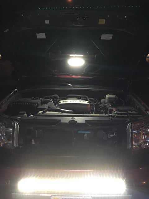

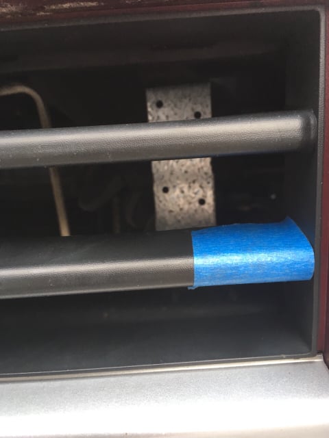

I ordered the MicTuning 32" LED light bar, harness and Push Switch for Toyota.
MicTuning 32" LED Light Bar (Amazon $35.99)
https://www.amazon.com/gp/product/B00CLHGGVC/ref=oh_aui_detailpage_o03_s02?ie=UTF8&psc=1
MicTuning Wiring Harness
https://www.amazon.com/gp/product/B00PTQOF4W/ref=oh_aui_detailpage_o03_s00?ie=UTF8&psc=1
MicTuning Push Switch for Toyota
https://www.amazon.com/gp/product/B0117B1J3W/ref=oh_aui_detailpage_o03_s01?ie=UTF8&psc=1
2 - 4" L brackets (Home Depot $4.57 each)
2 - Bolt, nut and washer (Local hardware store, $4.68 total)
1 - Self tapping screws (Local hardware store, $1.99)
1 - Dremel EZ Lock Kit (Home Depot $14.97)

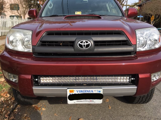

I'm going to cut the grill to fit the light bar.
I cut the grill, used different L brackets, and installed everything.

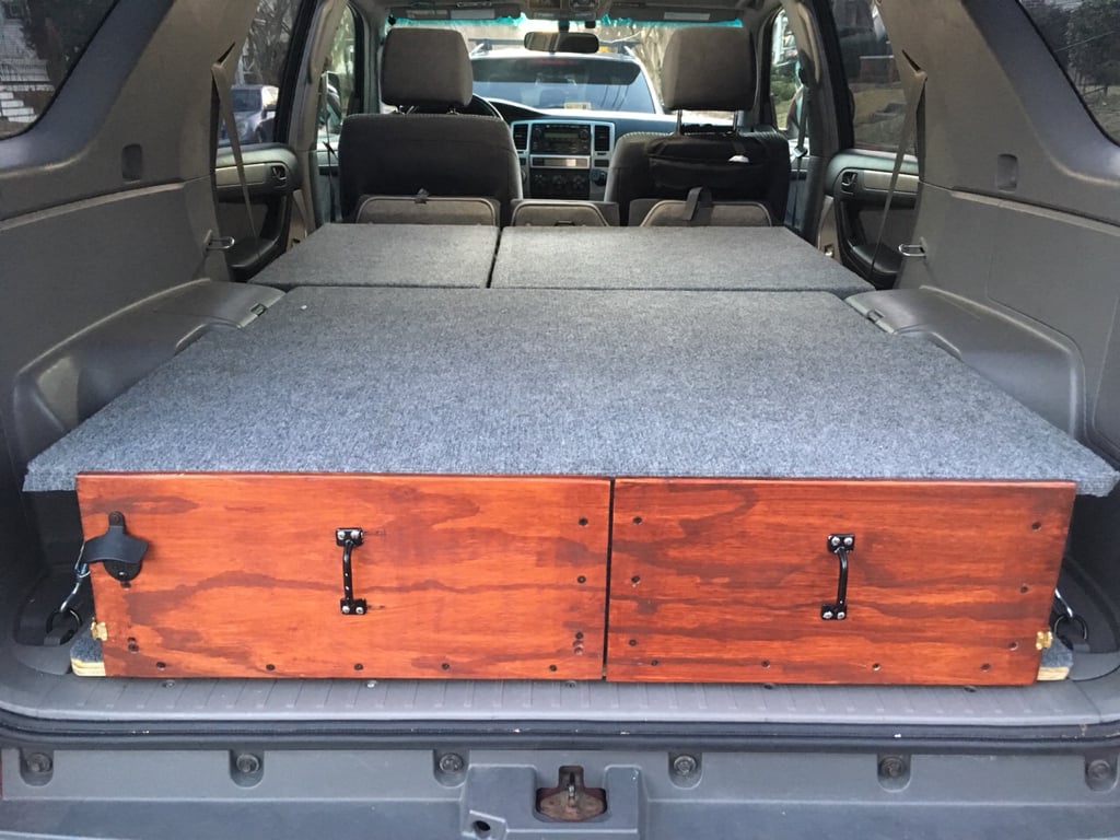

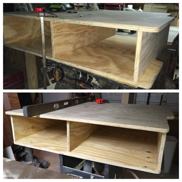

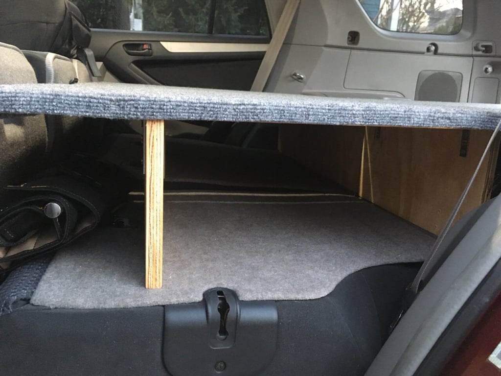

I finally finished my Drawer Sleep System. I used some Ace Hardware $5 Catch latches (2 1/8”), so far they seem ok holding the drawers in place while driving. The section over the rear seats, I used Home Depot corner brackets and L brackets to secure the supports.

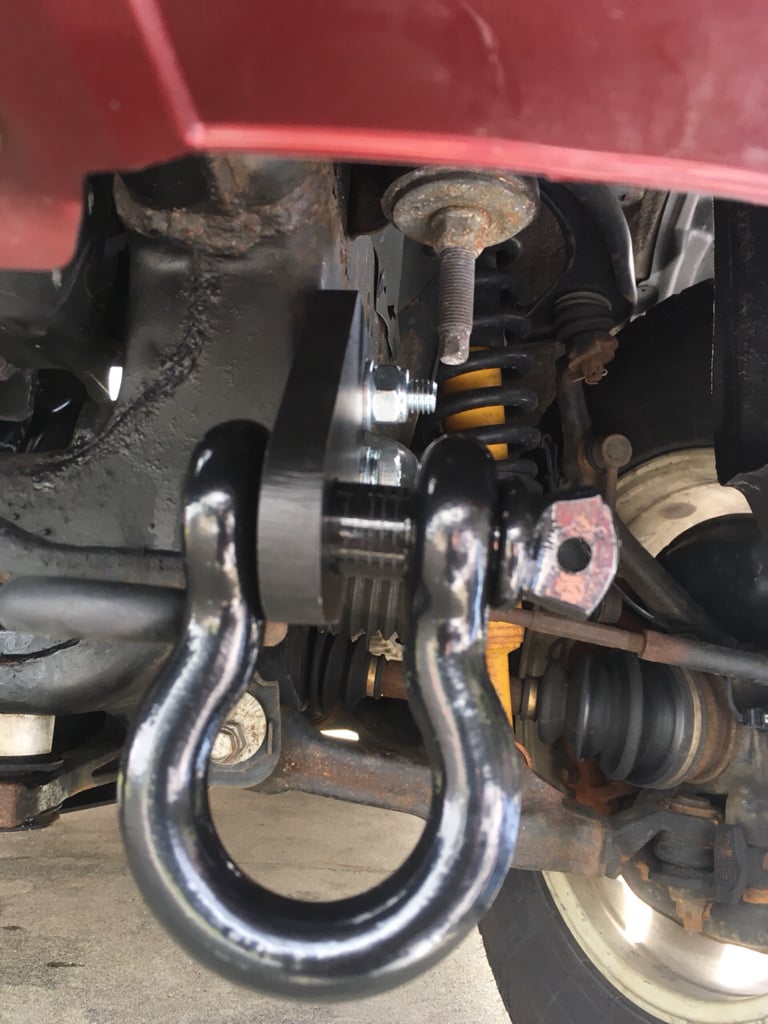

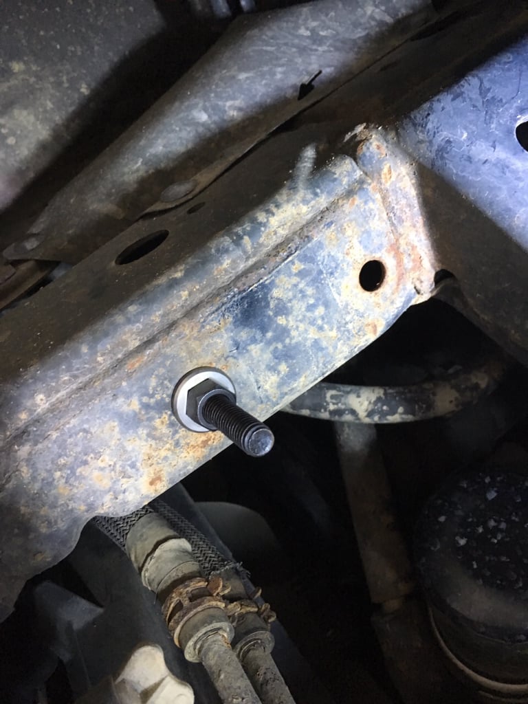

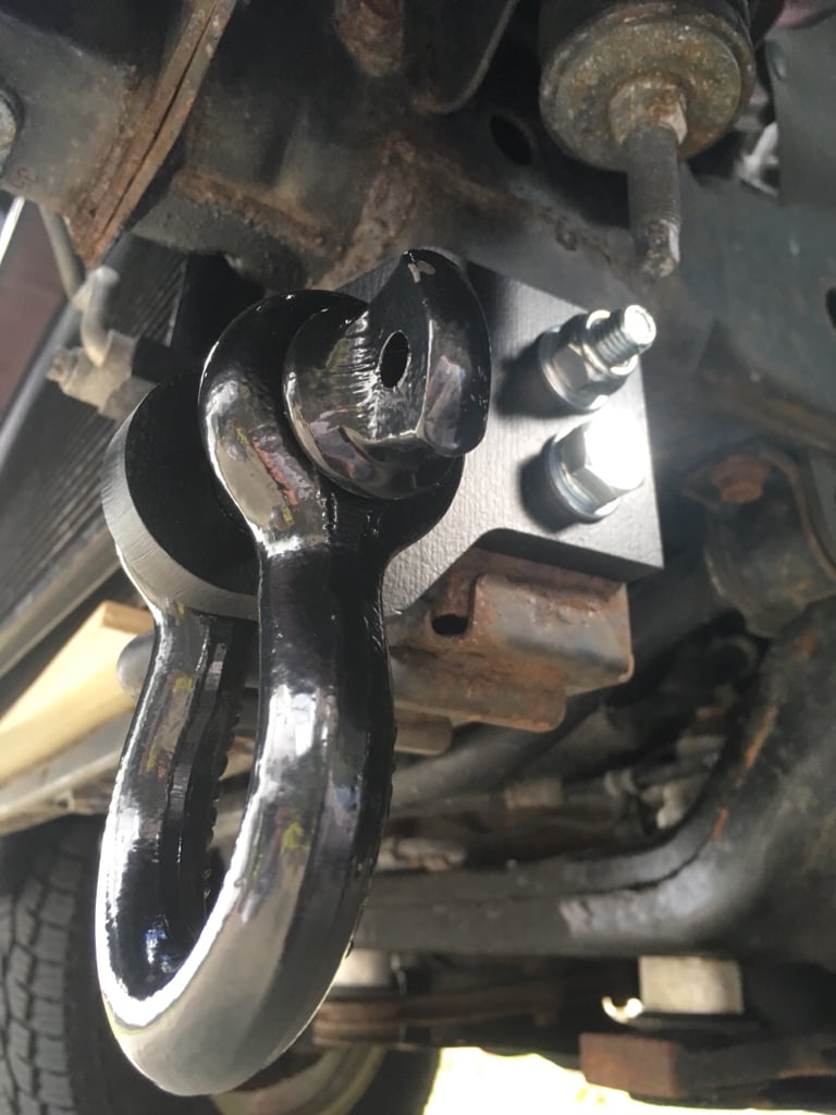

Installed Treaty Oak OffRoad Front Recovery Points. Though I’m not sure I like how the Rhino shackle sits against the factory tow loop. I know they say for ‘06 and up, you should cut them. Maybe I should do the same.

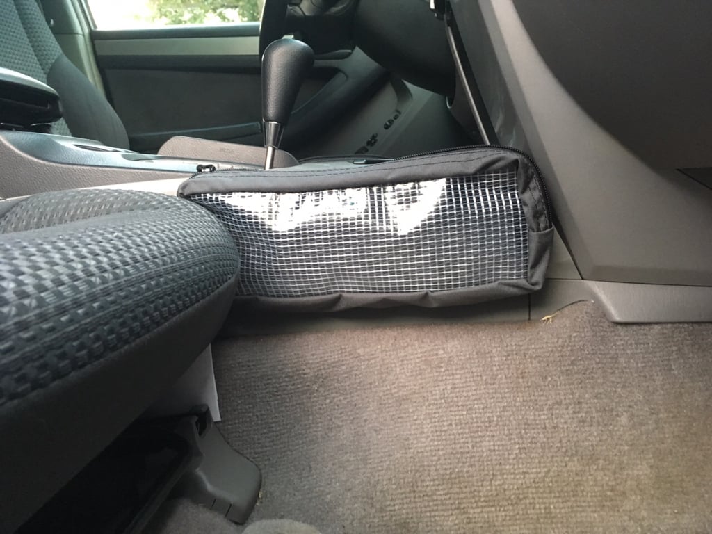

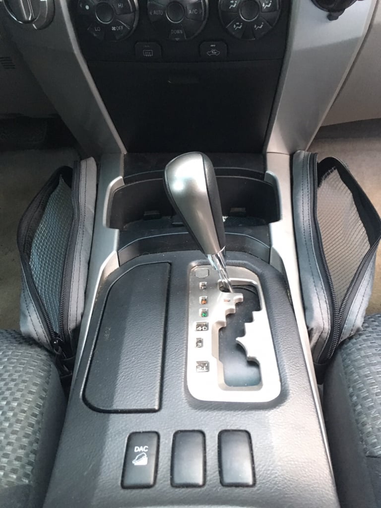

Added these two bags to my center console, purchased from Blue Ridge Overland Gear.
