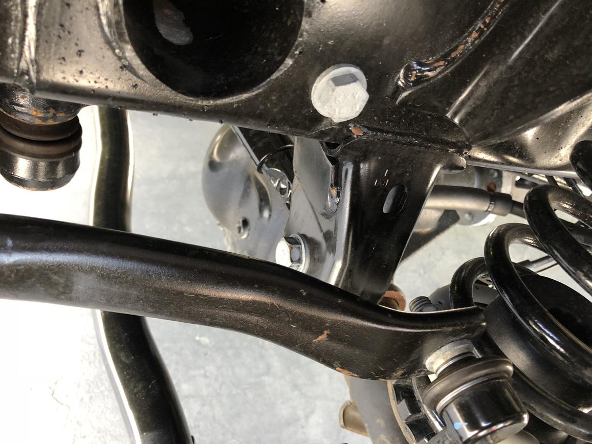

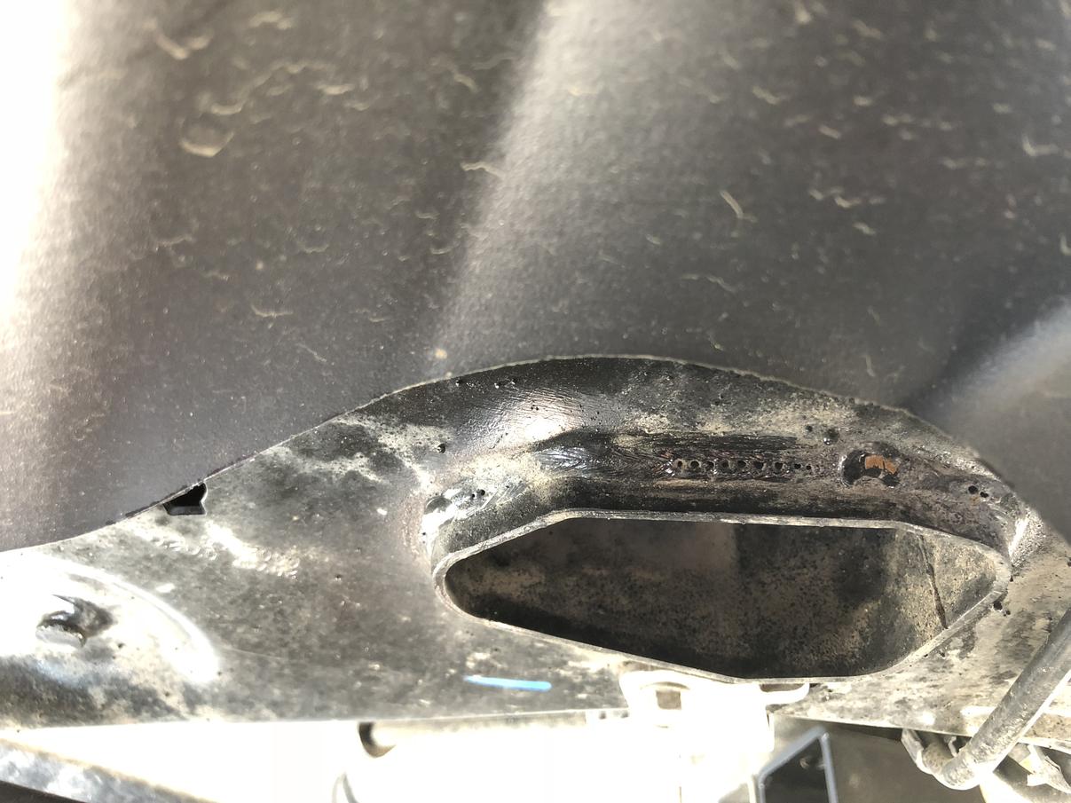

Heard of this online so went to the dealer to check it out for myself. Sure enough there’s sections of the frame with porous welds. I’m no expert but seems hard to believe something like this would pass QC.

I have been seeing threads about this on the JL forum too. I have been to the Jeep dealership near me investigating. Almost every JL Sahara and JL Rubicon I saw was covered with ugly welds.
I have ZERO knowledge on welding...but is this bad?? How is it bad??
Depending on how severe the porosity is, it can significantly effect the strength of the weld as well as effect ductility of the metal that it's joining together. It can be caused by a number of things but most commonly it's caused by air entering the weld or welding dirty or greasy metal. I'm a little surprised that they didn't catch the issue. I wouldn't be too concerned with the weld spatter, while messy looking, it doesn't affect weld strength but it could be an indication of dirty metal, or improper weld settings.
From a boiler NDT point of view, we would automatically reject any weld that looks anything like that.
Since I'm fairly certain these are welded by a robot, this is surprising.
Bad steel?
Or really bad weld settings.
I might weld a dozen or so times a year and my shit looks better than that.
