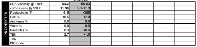

Figured I'd put this here for anyone that may want to see some real life stats. This was my first and only Blackstone report that I've had run so far and it was from May of 2021. I was very impressed with the results I was given and the information they provided me with. I definitely look forward to doing another UOA in the near future since I've switched oil brands. I'll give it a few oil changes before I pull and send off another sample. It should be noted that I used a YZZD3 filter during this oil run for anyone who's wondering.
<a data-flickr-embed="true" href="https://www.flickr.com/photos/195517094@N03/52146457290/in/dateposted/" title="Blackstone Report - 5/14/21"><img src="https://live.staticflickr.com/65535/52146457290_68a9812370_b.jpg" width="789" height="1024" alt="Blackstone Report - 5/14/21"></a><script async src="//embedr.flickr.com/assets/client-code.js" charset="utf-8"></script>
