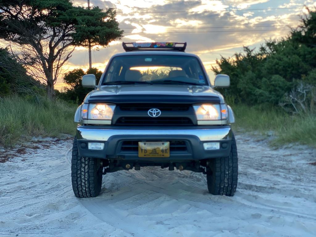

Yesterday I took the 4Runner through one of those drive through car washes. Afterwards I went to park so I could take some photos of how it looked. Turns out that my passenger side headlight was burned out. Back in February of this year I installed some cheap Hella bulbs purchased off of Amazon and they were less than $10. So for the Hellas to only last 5 months, I can't be too mad I suppose. Given that I had to drive in the dark this morning, it was pretty urgent, so I went to the wonderful Wally World where I purchased some Sylvania Silverstar Ultra bulbs. They were $45.97 pre tax. Went back out to the parking lot and swapped them in before I even left.
They produce a noticeably "whiter" light than the Hellas, but overall they look really good. I've ran LED's in the past and I'm done with them, they're too cheap, burn out quickly and they aren't even made for my housings. Plus I think the halogens look good on older rigs. Driving into work this morning I noticed that these have a much wider beam spread and definitely illuminate the road ahead quite nicely. For $45 I think these were a good investment and would definitely recommend them. Hopefully they last much longer than 5 months!

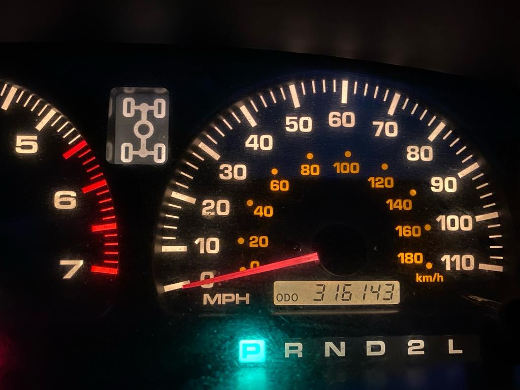

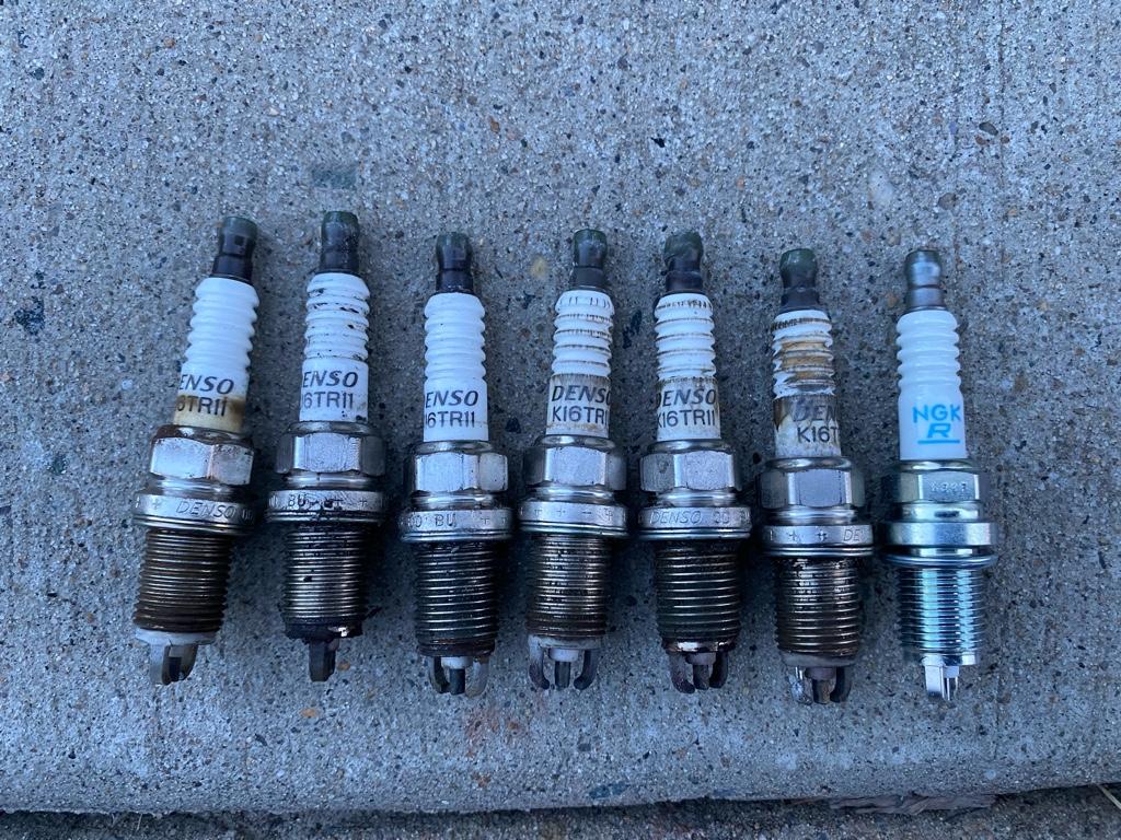

JoeT4R’s 2001 SR5 Build Thread

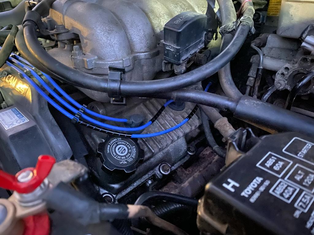

New NGK spark plugs (NGK 3967/BKR5EKB-11) and plug wires (NGK 4412/TE66)
Date: 8/6/22
Mileage: 316,143

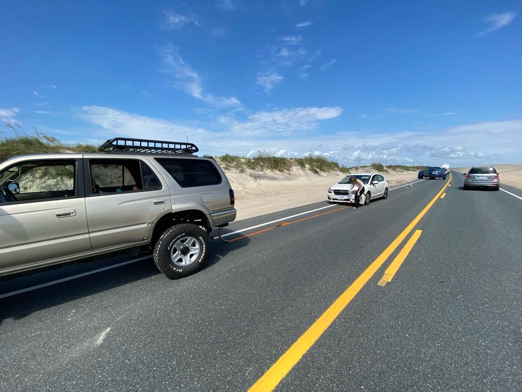

While on the way back to Hatteras Island, I saw a stranded motorist in the sand with a sign in the back window that said “I’M STUCK”
So, my 3 year old and I decided to stop. It was a young girl with her dog who had gotten her AWD subie stuck in the sand. Fortunately, I had my ARB recovery strap with me and put it to good use. Another guy, the one in the large blue Ford behind her, also pulled over to lend assistance. Her car was pretty low as it was and her front bumper was already tore up pretty badly. So we looped the recovery strap through the driver side lower control arm and back to my hitch shackle. Dropped it in 4Lo, locked the center diff and feathered the gas pedal. In a few seconds she was back out of the sand and off we all went. Pretty stoked to have had the opportunity to use the strap since I haven’t had to use it in years, so it’s very reassuring to know that the ol 4Runner still has it ;)

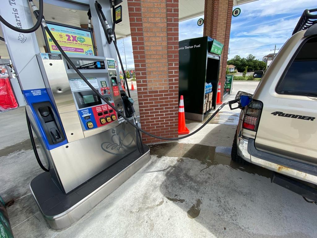

Non ethanol fill up at Harris Teeter in Kill Devil Hills. 90 octane (mid grade) for $4.66 per gallon. Would love to be able to run non ethanol exclusively all the time!
The factory window sticker/mpg figures are based on 87 octane. These vehicles were built to run 87 (compression ratio, etc). It has been suggested that anything above 87 won't yield any improvement in mpg or performance - just a lighter wallet.
