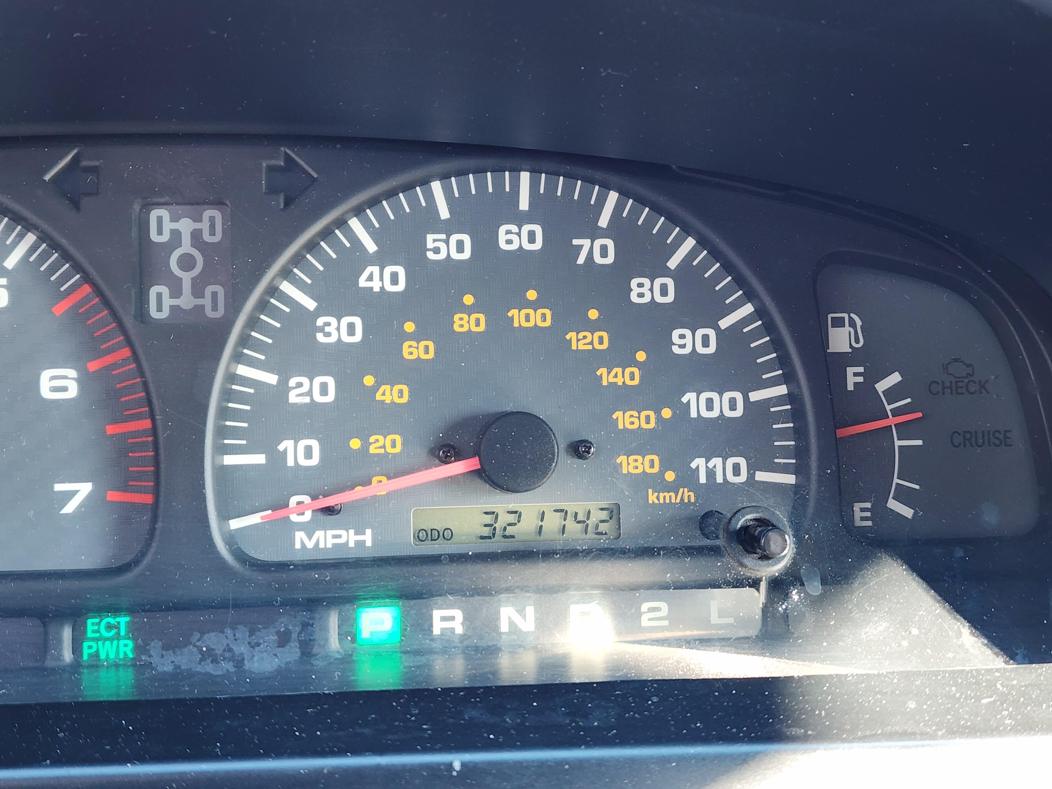

This is what 320,397 miles looks like. Not too shabby I must say. Could go for a fender flare repair but we'll be okay for the meantime.

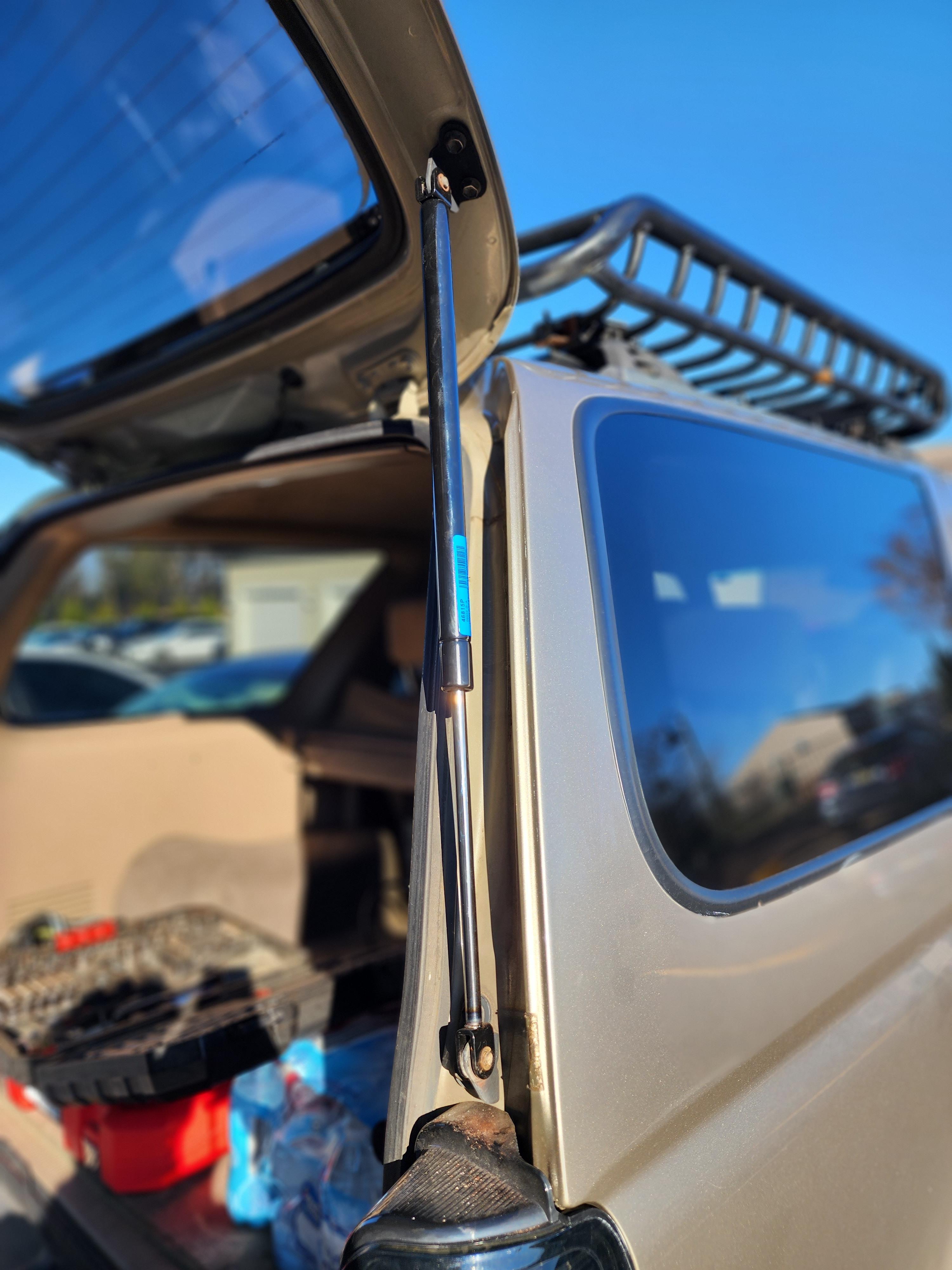

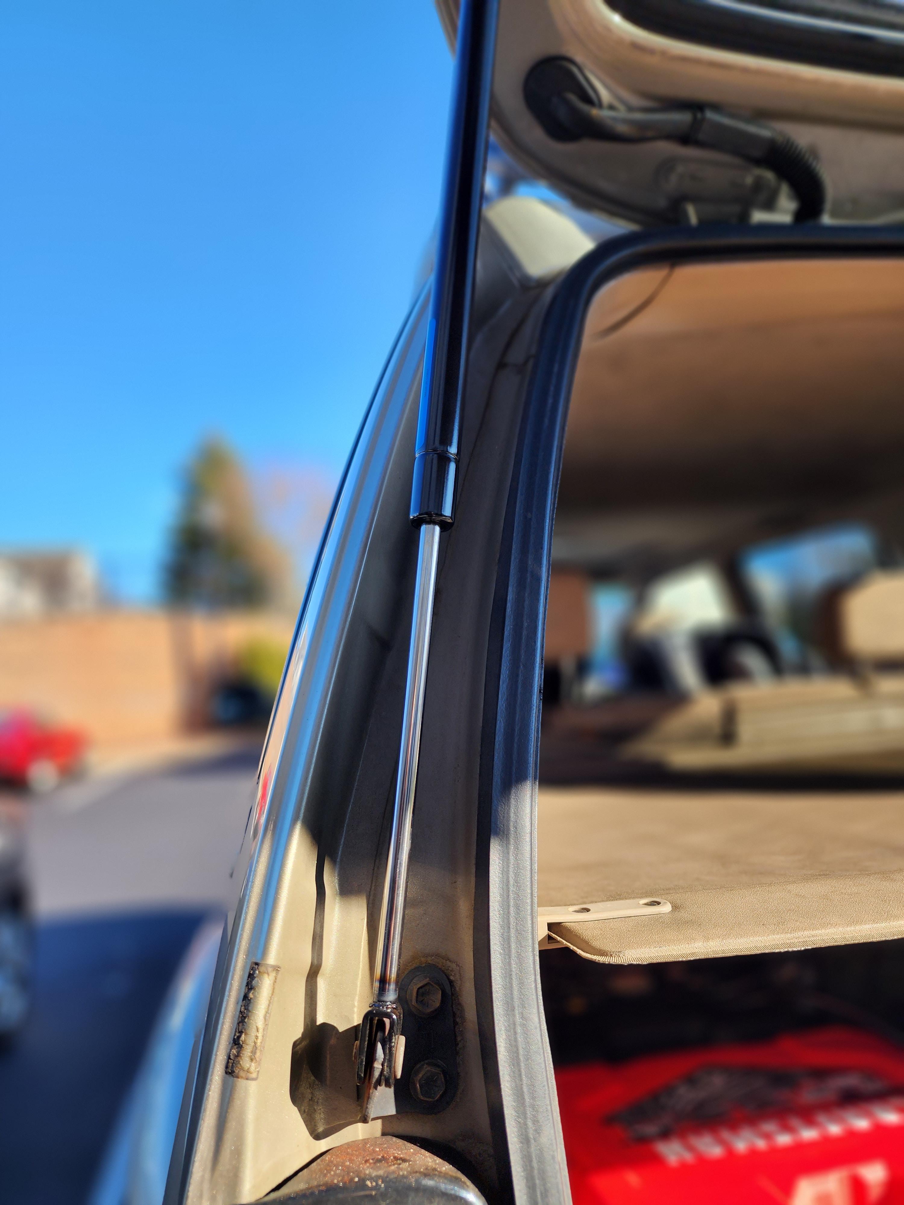

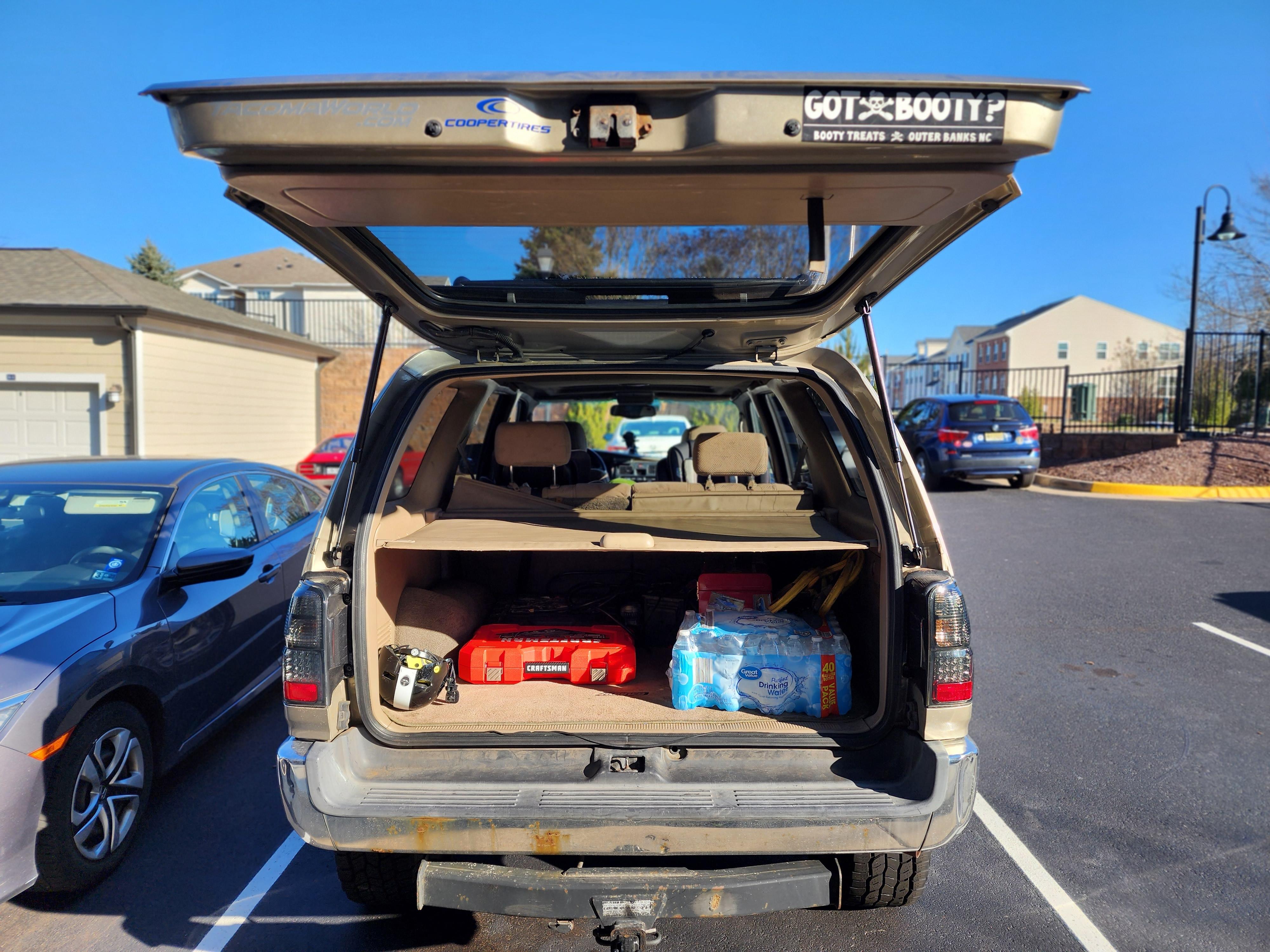

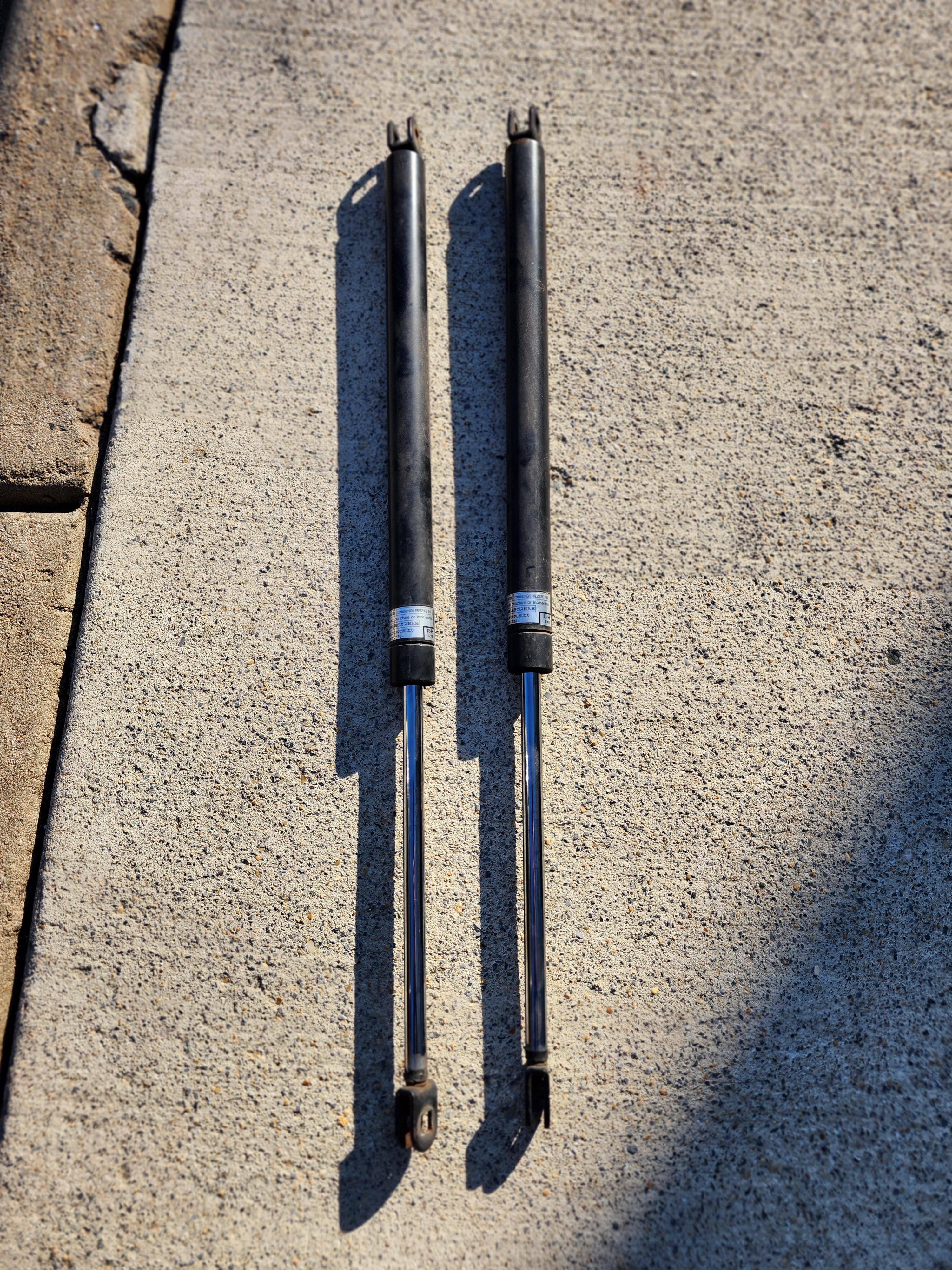

New Strongarm 6815 rear hatch struts. These things are indeed no joke. All I have to do is pull the tab on the hatch and it does the rest of the work itself. Hands down worth the money. I also reused my old washers and hardware with no issues. Installed these in 32⁰ weather and they still open super fast!

I'd like to get those but my bushings are shot. I have the regular Strong arms I believe, and they have gotten weak over a 2.5 year period.
My bushings are basically non-existent but yet they still work just fine. I don't think it's going to make or break the performance although I could be totally wrong. I got the ones with extra force and they are insane. I definitely would recommend them. I'm excited to see how they hold up in the long run.
Sent from my SM-S908U using Tapatalk
Did the stronger struts make the hatch more difficult to close at all? My hatch barely stays open on it's own so I'm due for some new ones, and was debating with going with stronger struts or not
Agreed. When I first installed them, I needed to jump back or get whacked as the hatch opened! I have a screengrab of the Hillman nylon bushings/PN on my computer but have just been too lazy to deal with it. To answer the other gent's question about the hatch being more difficult to close with Strong Arm struts, I would say it most definitely takes more force to close, but not quite 'Difficult'. I may be mistaken as to which version of the SA struts I have and whether or not there are even 2 versions as it was the very first 'mod' I did. With the OEM struts it came with, the hatch would actually hit me in the head if I trusted it to stay up before I swapped them out - it would not stay up AT ALL if the rear glass was down..
The stronger struts give a loooot more resistance than the worn out stock ones when closing the hatch. It's not difficult but you may have to two-hand it. It's worth it though and you will absolutely thank yourself.
I've seen the videos/info on fabbing those Hillman nylon bushings and I just didn't bother or care to. It wasn't critical so I left it alone. There are in fact two versions and I'm pretty sure the YouTube video [MENTION=120071]mtbtim[/MENTION] and [MENTION=102606]infamousRNR[/MENTION] put out on this mod lists the two different part numbers. I opted for the ones with extra force because why not?
Sent from my SM-T220 using Tapatalk
I only installed one extra strength strut and kept one of the factory ones. Seems to be working well for me.
