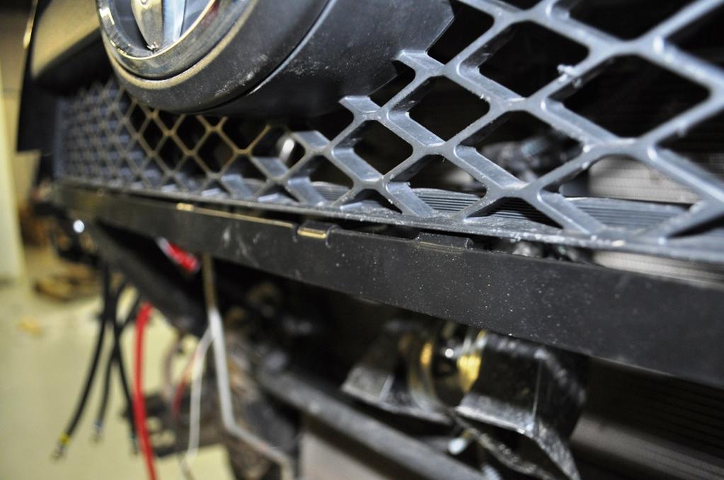

Here is the original factory grill installed. If you've got a satoshi grill mod, you've already or possibly cut out the bottom of the factory grill.
A little closer view. This shows how the Shrockworks piece holds the factory grill. Again, if you've cut this bottom part off for a satoshi grill, you'll skip this step.
A little further out.

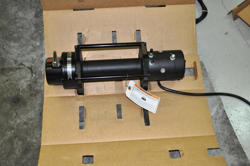

A keen eye may have spotted this earlier. Joneseyyy's weapon of choice!
unboxed!
unpackaged!
There is no rope there because we've got to install the synthetic line into the WARN VR10000s!

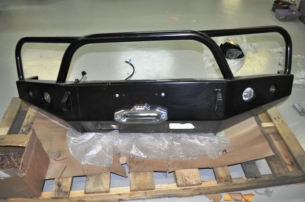

And then....prep the bumper.

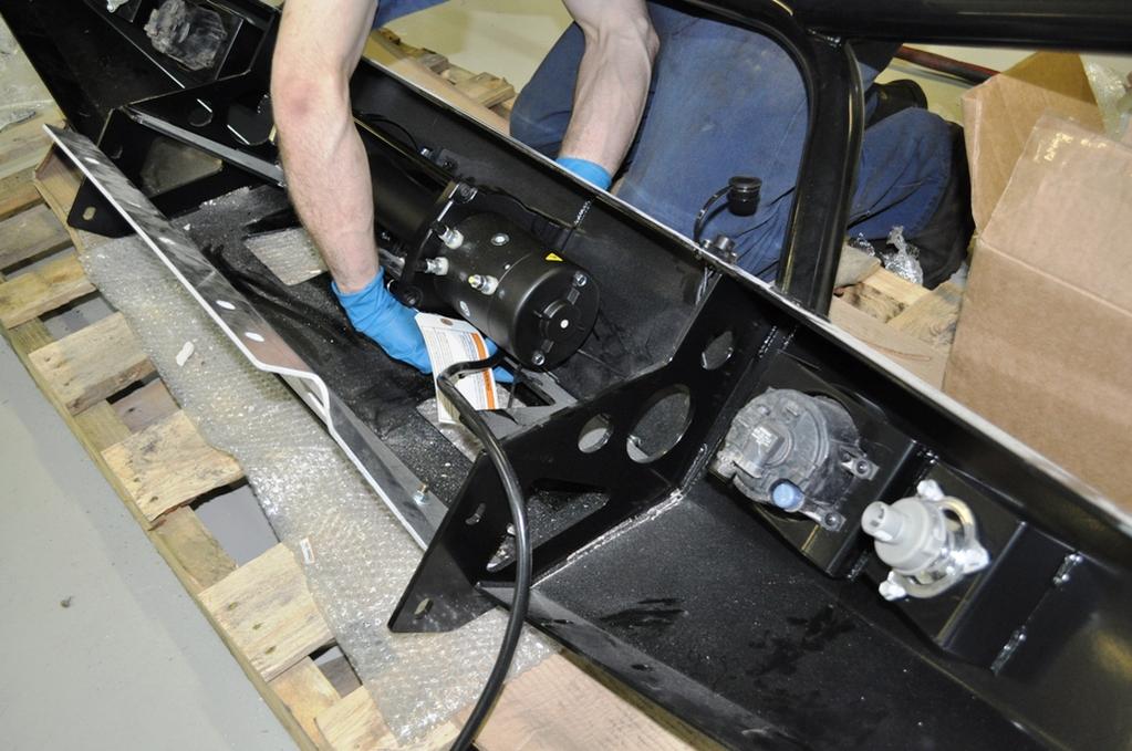

Let's get this bumper set up for the winch.
After the winch is partially mounted...

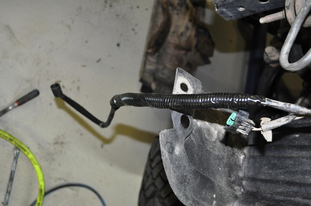

You'll see the relocation of the remote plug near the pass side headlight.

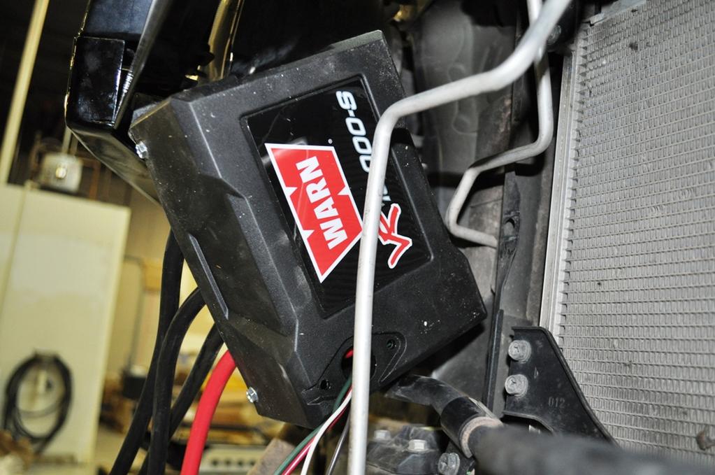

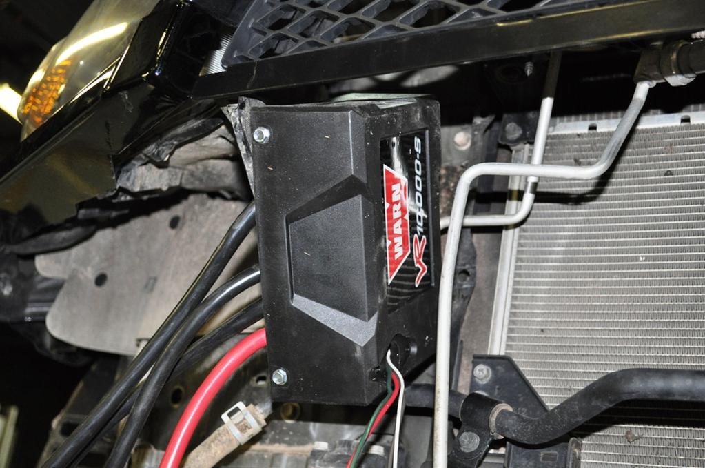

So, Shrockworks requires a seperately mounted solenoid. We found a perfect place for the solenoid to go. Tucked out of the way and close enough for the wiring to reach the drum.
Close up view from driver's side
Passenger side view to show the mounting point of the solenoid

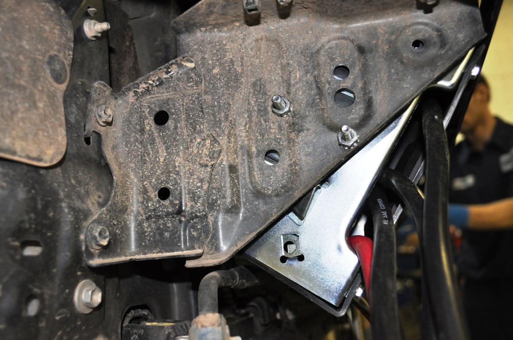

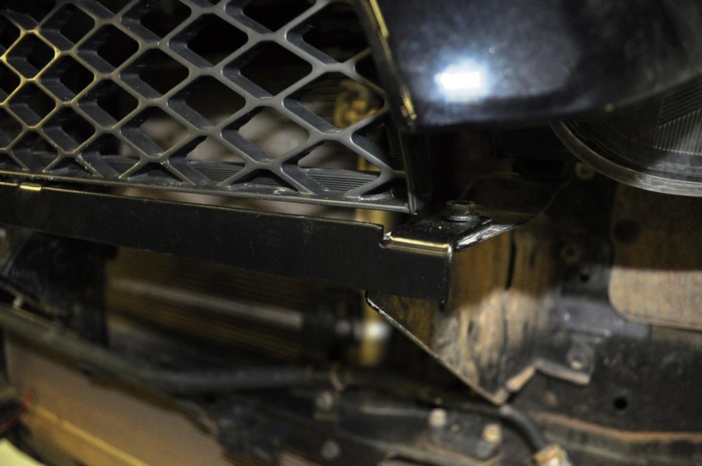

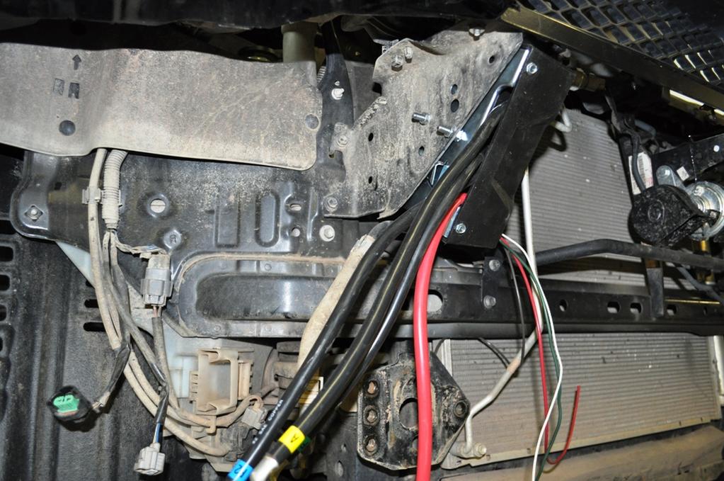

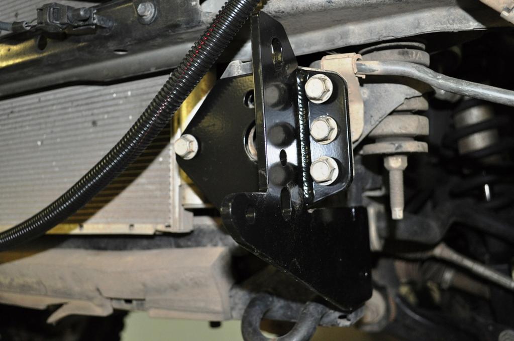

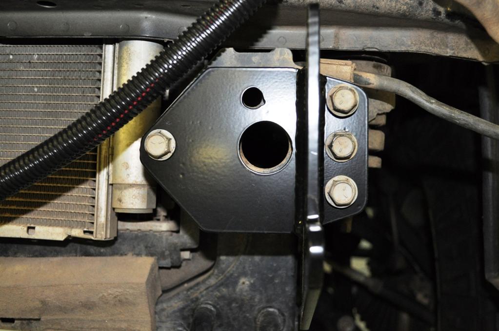

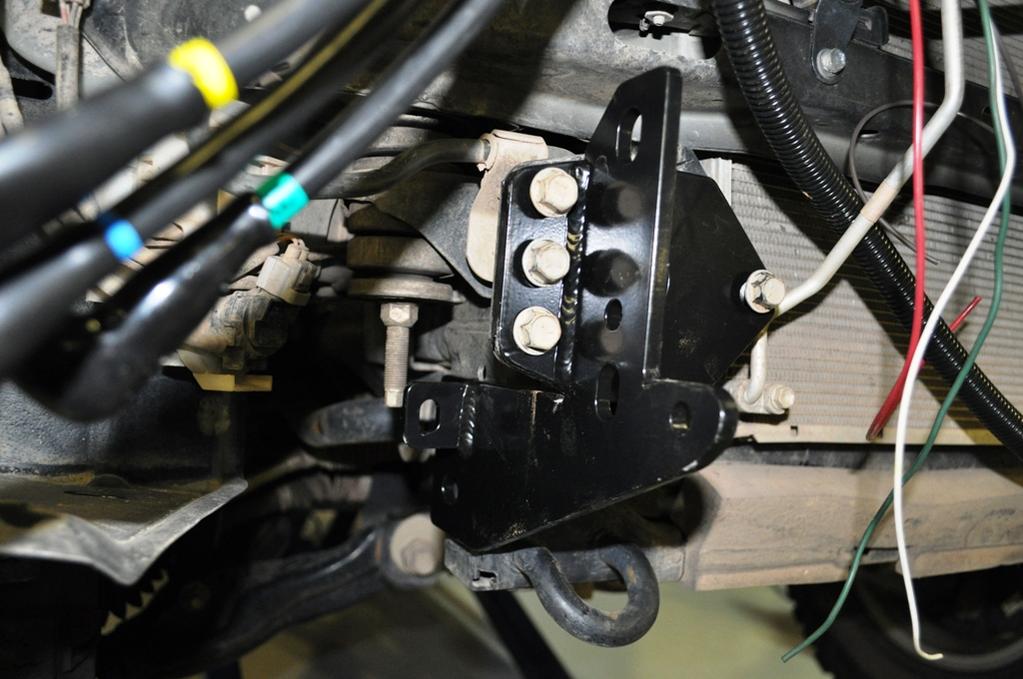

Let's get a look at how the Shrockworks bumper brackets tie into the frame.
Here you'll see the factory locations of where the original aluminum tie bar went. You'll also notice where the additional bracing is to tie into the Toyota frame below it.
passenger side
driver's side
a little closer to the driver's side to see the "bottom" bracket tie in

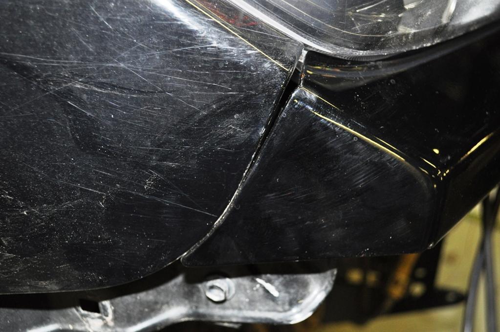

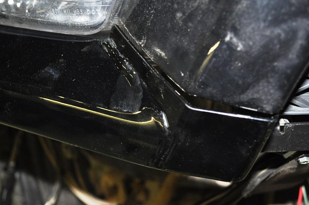

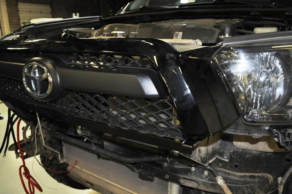

The headlight trim that came with the bumper is powder coated the same as the bumper. Joneseyyy had them painted at a local body shop ($80?). IMO, the only way to do it. The black may be close enough to Toyota 202, but it blends in much better than the powder coat did. I would highly recommend doing this even if your truck is black.
This piece allowed very little room for adjustment. There were only 2 ways they could be moved. Up or down. Shrockworks came very close to perfectly matching all of the angles. I'm sure this was a complicated piece to manufacture. I'm overall impressed with how close Shrockworks got it.
It would be very difficult for someone to manage to get this perfectly. Regardless of how you shimmed it, wiggled it, or modified it...this was as close as you get it.
From the pics, it may appear to be "off". But, remember, I am taking photos of this up close.
