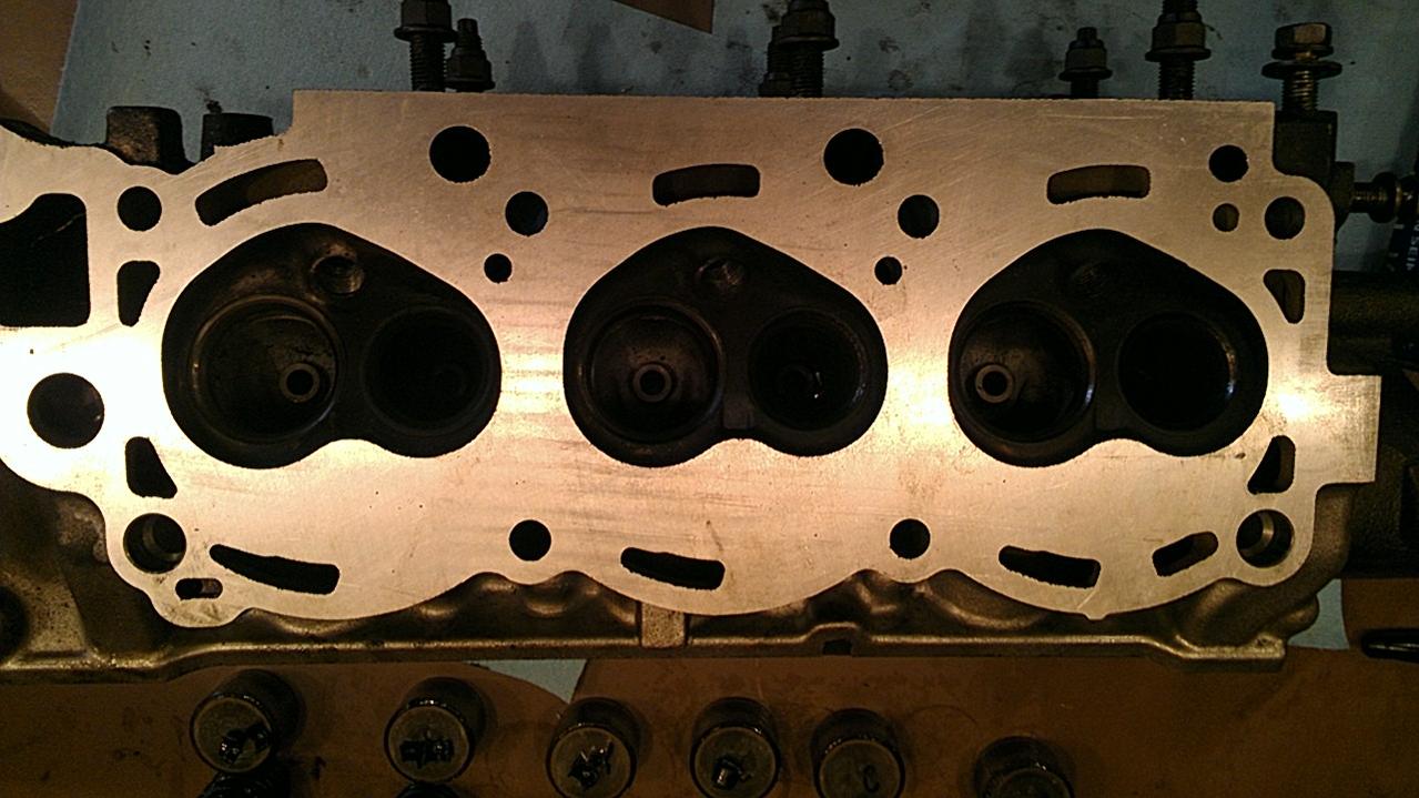

The head gaskets that I ordered are DNJ from Rock Auto. I have read that a lot of people swear by OEM head gaskets but I ordered most of my other parts from Rock Auto. Has anyone had issues with the DNJ gaskets?

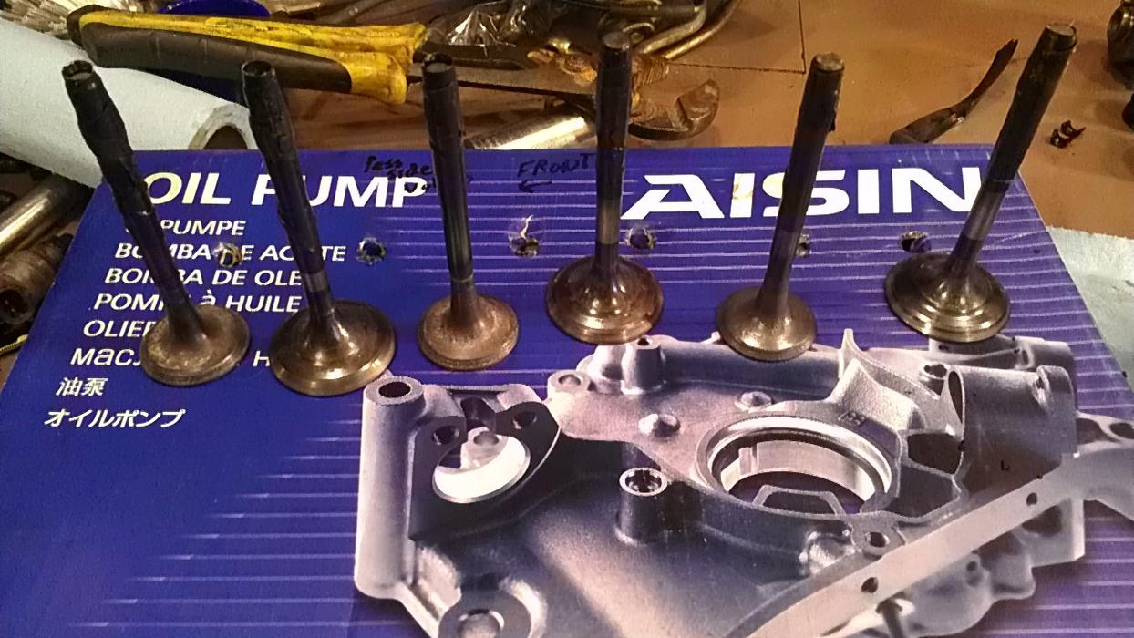

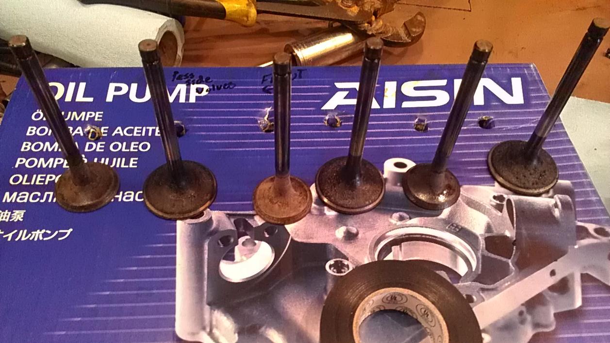

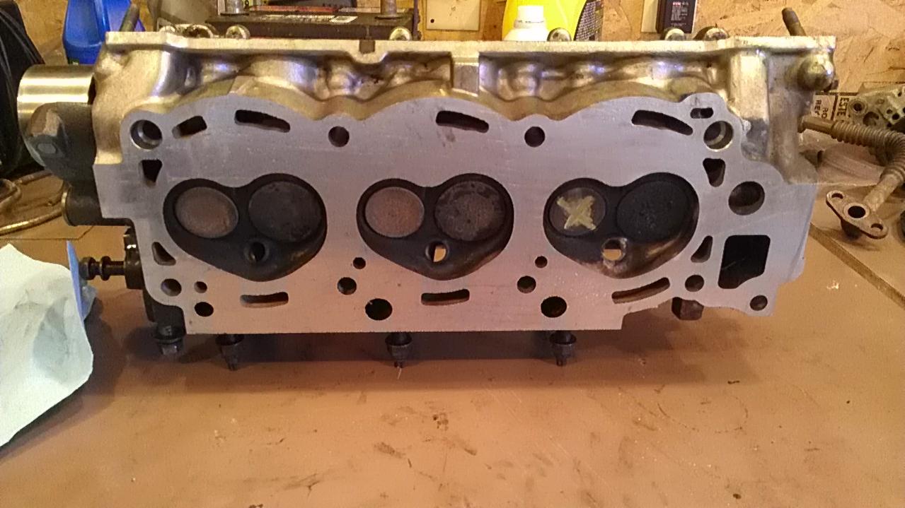

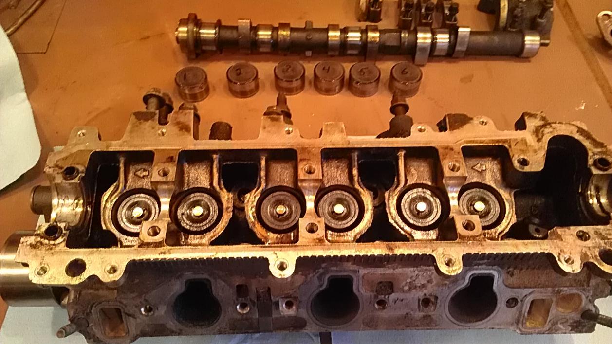

Since the block is at the shop, I decided to remove the valves and clean them up. I plan to lap them and put them back in the head if I have time tomorrow. The valve with the X on it is the one that failed the vacuum check. I didn't check the valve clearance yet but I will once they are back in the head.

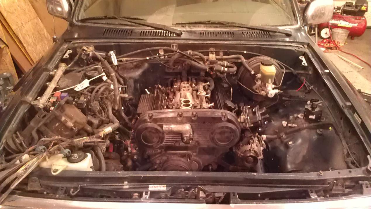

It has 329000 miles so I figure its best to rebuild it rather than putting a bandaid on it. (head gasket & water pump) & Im praying the block isnt cracked or any other major issues.

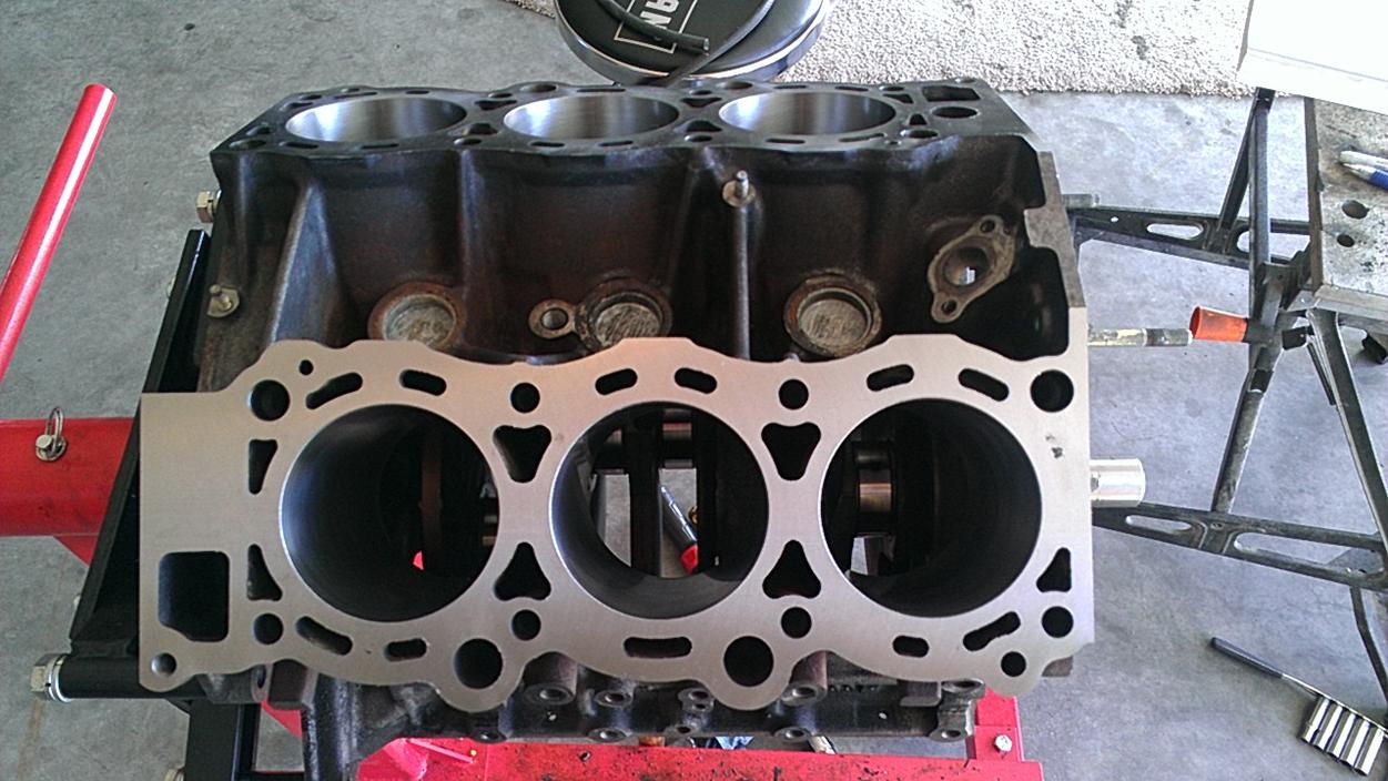

Got a call from the shop about my block yesterday. They said that the cylinders need to be bored. I ordered new pistons that are .75 mm or .030" over standard. The shop said they needed the pistons before they bore it. I guess it will be a few more weeks before I can put it back together. I also checked the valve clearance and I couldn't even get a feeler gage under one of the exhaust valves. I have since replaced all 6 of the exhaust valves and one intake valve. Now all of the valves are in tolerance. The project is going pretty slow, but I might get it running sometime in March.

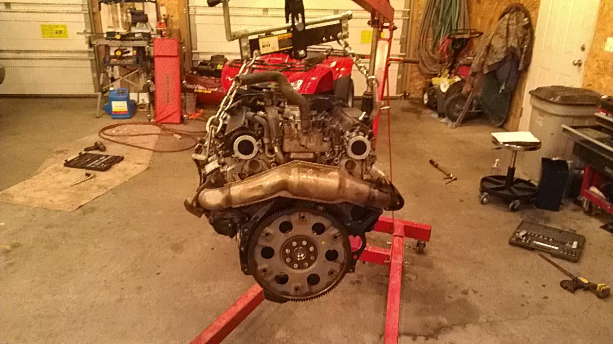

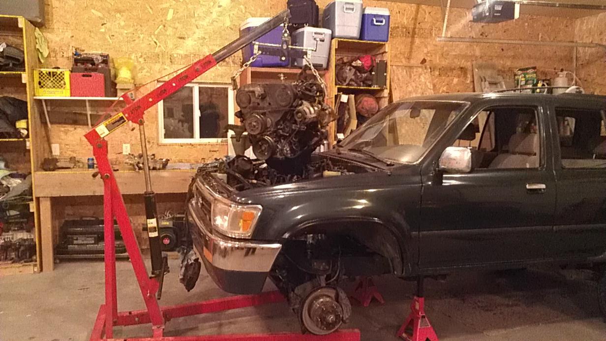

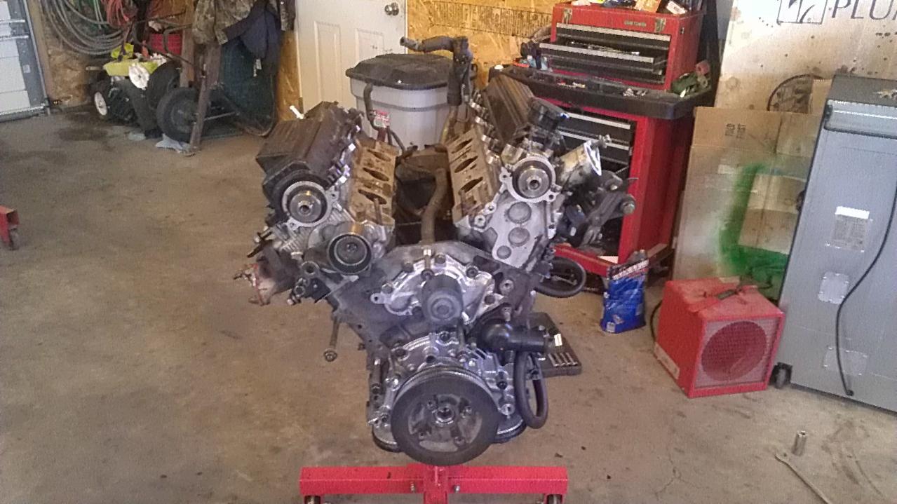

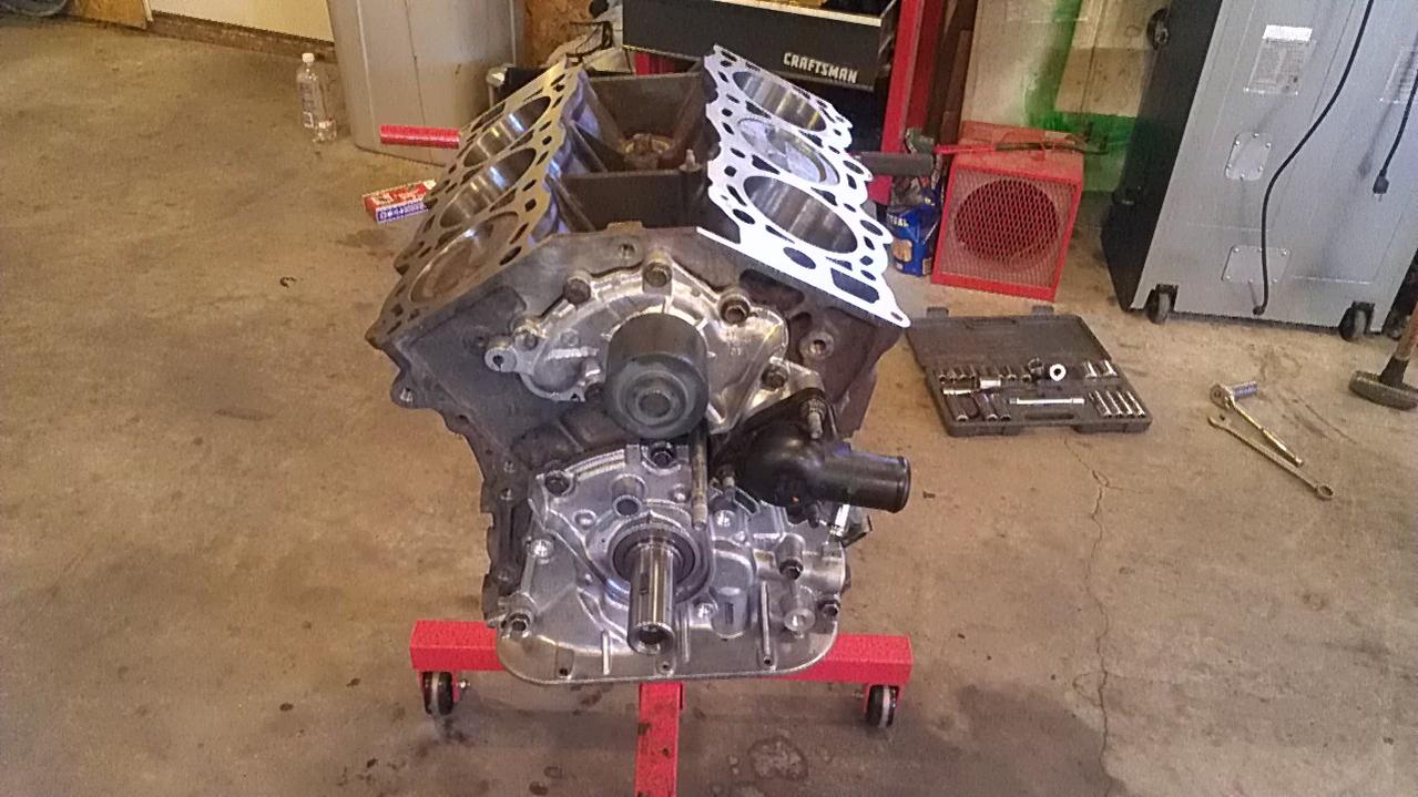

Well it took 3 months but I finally got the engine put together and in the truck. It took a long time to get the block machining done but it was worth the wait. Here are a few picks of the rebuild.
Block with crank installed.
New oil and water pump.
Heads on.
Crossover and flexplate.
A little crooked but ready to drop in.
Back in the truck.
