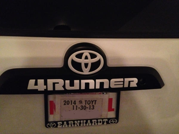

Agreed on the white emblems, looks good.

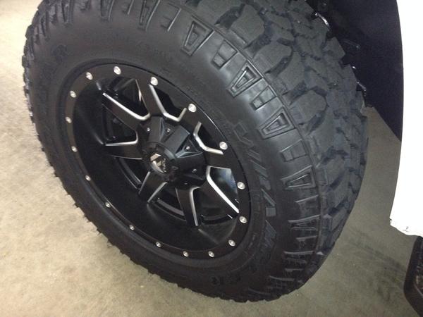

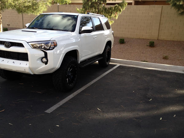

Wheels and Tires installed!!
18x9 Fuel Mavericks -12
275/70/18 Duratracs
Hope to get front bumper plasti dipped and front emblem done tonight.
HID's get delivered wednesday.
1 month in, Phase 1 complete!!
Update:

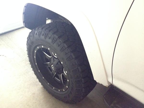

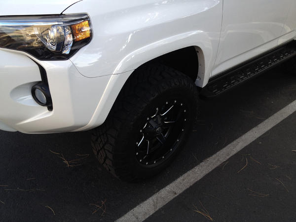

Lots of rubbing on the 275/70's because I went with a negative offset wheel. Switched them out for 275/65R18 and all rubbing is gone.

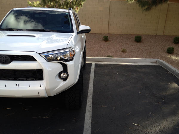

Front and rear bumper trim has been plasti dipped black
Front emblem plasti dipped white

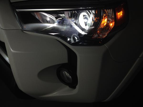

HID Conversion installed.
Now for the pics:

jr - To say your build is already impressive, would be vastly understated. Now may the force guide your storm trooper onward to the next phase....:lightsaber:
Does the projector lens eliminate the flood effect from HID's? In other words, does it keep the hid focused the way it should be?
