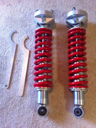

Look what UPS dropped off this afternoon! :party:
I plan to install them this coming Saturday along with the OME 891's I got from 4-ripcord.
Thanks again steezemcqueen and Toytec Lifts!

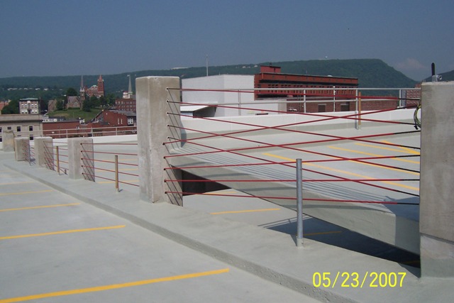

I parked in a mall parking garage that had the wire rope as a barrier to keep you from driving off the edge (heres a picture I found on the internet to help explain what I'm talking about) wire rope.JPG
As I pulled in to the parking spot, my winch hook clipped on the the wire rope, which I did not know. After doing some shopping I got in my car to leave and when I tried to back up the car wouldn't move. I checked the parking brake again, and attempted to back out again. Nothing, the engine is reving and I can feel it want to move but nothing. Now I'm frustrated and think maybe the parking brake is stuck, so I get out on look underneath at the rear axle and brakes, the brake cable is loose, so that's not the problem. Now I'm really scratching my head, and starting to think its my transmission. I got back in to try again, I give it more gas this time but nothing, the car wont move.
Long story short, about that time a another shopper came out of the mall and saw me trying to back up while still connected to the wire rope...I felt like an idiot when they told me what the problem was. :bash:

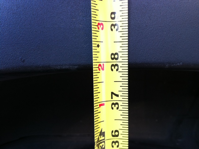

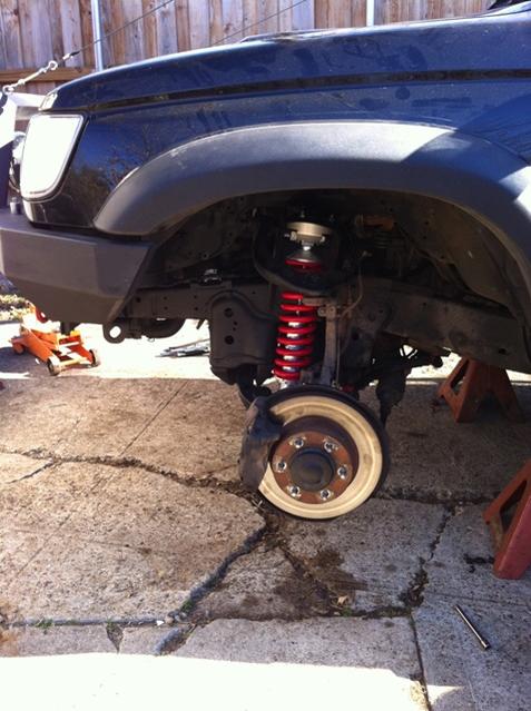

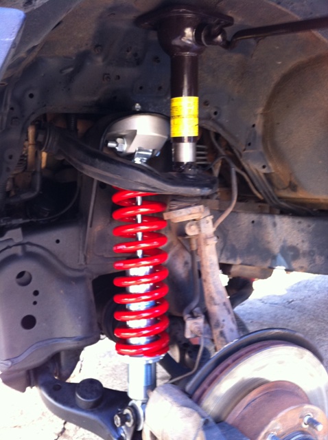

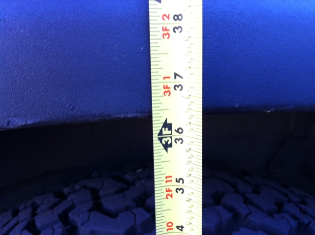

Got the coilovers installed today with the help of my brother again at his house. The install went very smooth, and the coilovers are awesome! I also got the rear OME 891's in as well, looks like little lift from them as well. I did adjust the coilovers down a little after I got them installed as they were too high at first IMO for the CV angles. I took the 4runner for a short drive to see if they settle and decided to go to the beer store while I was out. After I got back they had settled, a little lower than I liked so I adjusted them back up. The 4runner sits pretty level now, and I think I have adjusted them to about the right height for decent CV angles.
By the way, this new front suspension upgrade was LONG OVER DUE! The ride quality with these new coilovers is really awesome, I did not realize how bad and worn out my old coils were until riding on these! I am very impressed, and really happy with them. Glad I got the 650lbs springs, they handle the weight very well. The ride is firm, but not too stiff.
Heres a few pics:

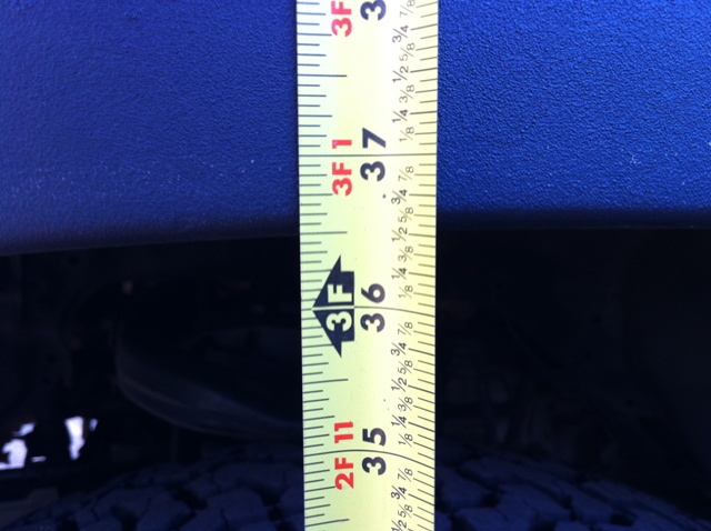

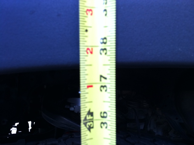

Before front, ~36 1/2"
Before rear, ~36 1/2"
After front, ~37 1/2"
After rear, ~38"

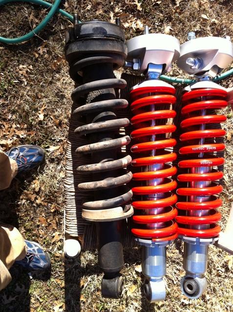

old coil and new comparison
Installing, had to use the stock bottle jack to help

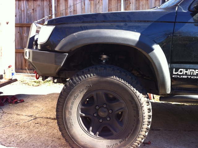

looks like it might be a little tall
front completed, a little tall for me
