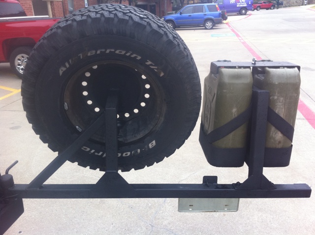

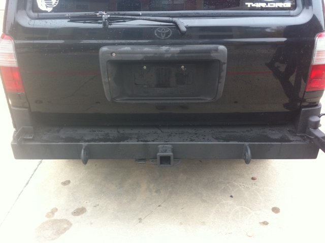

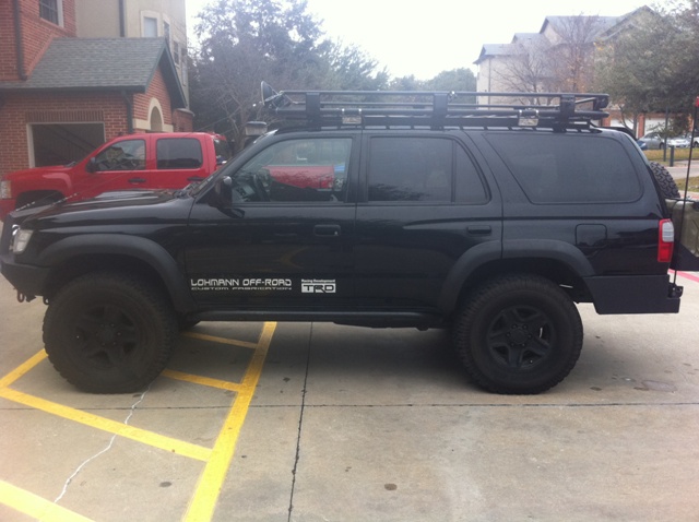

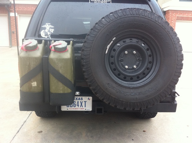

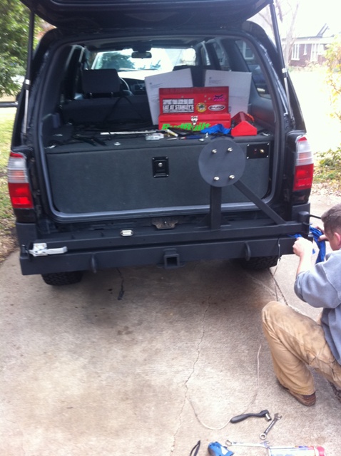

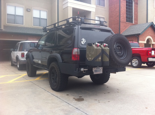

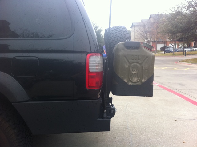

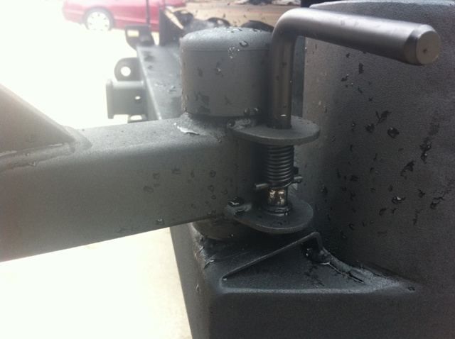

Got the bumper mounted today, enjoy the pics! I washed my truck after I got the bumper on there, that's why its a little wet still. I also, modified the latch pin after I took a few pictures, I add a leash to it so I wont lose it. You will see the modification in the pics towards the bottom.
Let me know what you guys think.

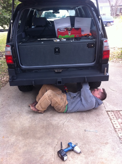

Me tightening down the bolts.
me cleaning the grease off the outside of the spindle

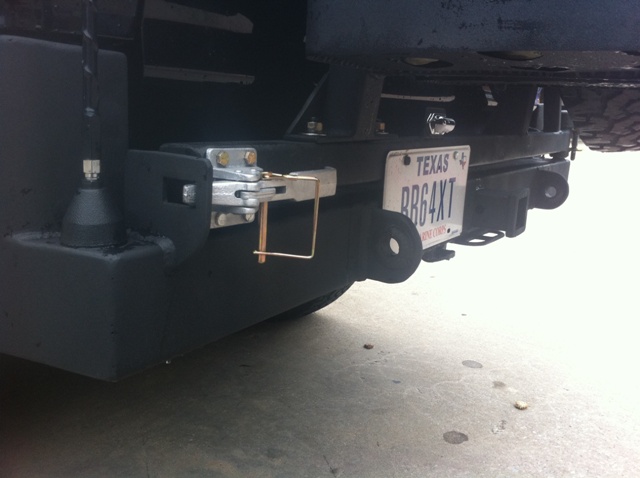

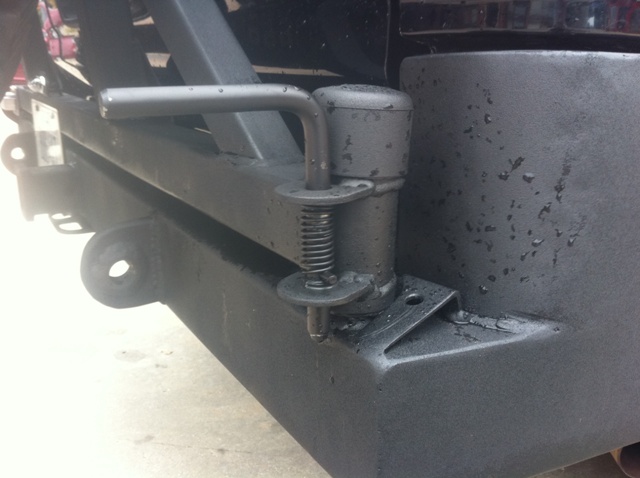

latch pin to hold the swing arm open, idea I got off someone elses bumper I saw.
latch pin holding the swing arm open, it also acts like a 'stop' to keep the swing arm from opening too far.

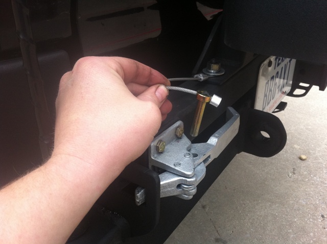

latch pin before I modified it. Also you can see I mounted the CB antenna on the bumper as well.

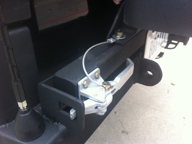

latch pin after I modified it with the leash so I don't lose it

Nice job on the bumper. It flows with the body very well. How much did it make your back sag?
Maybe just a little, I actually don't notice much sag really.
The only time I noticed any rear sag is when the Jerry Cans were full the other day when I was test fitting everything, that adds another 80lbs hanging off the back.
EDIT: (they are empty in the pics above)

Where did you get the latch for your tire swing? How do you like it?
I got the latch off ebay, I won it for $1.99! I like it so far, it is made by southco and is of very good quality, I don't think I will have any problems with it.
