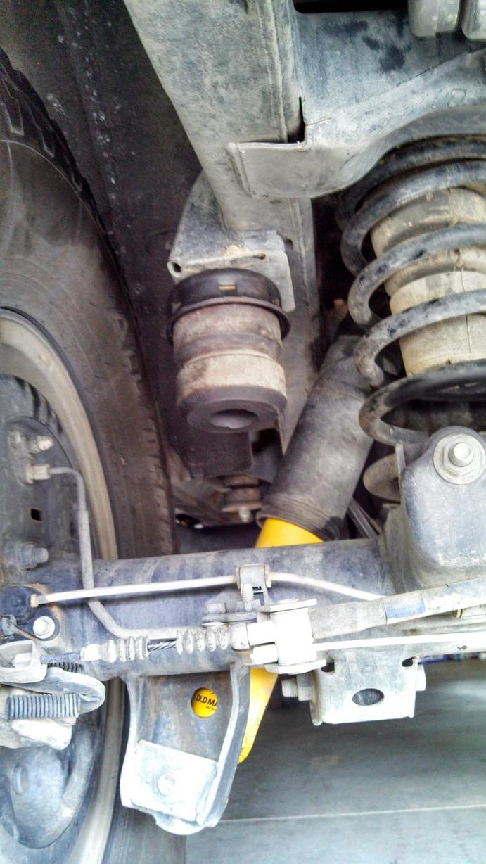

A great junkyard, DIY rear bumpstop to replace the stockers can be found under the rear of the s10 blazers and oldsmobile bravada's.
I have used these on several rigs, tuning the mounting and length to suit my suspension but i have always been happy with them.
For the 4runner i simply removed the rock hard stock rears and bolted these in place with the appropriate metric hardware. The bump stop itself simply pop's into the buckets, and seems to be very sturdy. On my 4runner i cut off the lowest "ring"
everyone like pics, pardon the dirty frame and undercarriage.

My setup is OME 890 rear springs, trooper shocks, and front end links on the rear.
Total length of the cup and bumpstop is 5.5 inches
Thanks Shmabs. Install couldnt have been easier.
