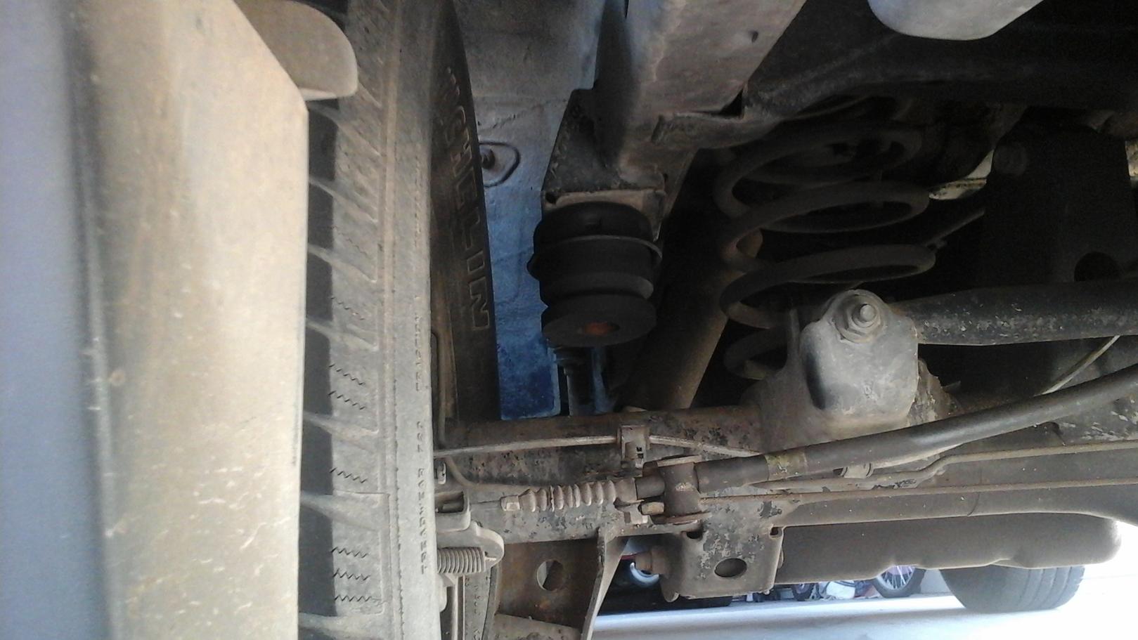

I put these bumpstops on my '97 a month or two back, and finally had a chance to flex the rear end and see how the "junkyard" rear bump stops perform. I've been curious how much they limit uptravel and control my LC 7.5 wraps.
Based on what I saw, these things work very well with LC coils in the rear. They limit uptravel just enough to prevent rubbing the stock rear bumper with the rear edge of the tire, and they keep the shock from fully compressing and becoming the bumpstop. When everything is compressed, they hit the axle tube dead center, and they're softer than the stock bumpstop. I thought they'd be too soft and just squish way down when compressed, but they held up well to the compression force. I left mine completely intact and did not trim the lower ring as others have done in this thread. Works for me.
Here's the pics...
P8240428_zpsd9b93a6c.jpg~original
I made sure the D/S was at full droop, and hung the rear wheel...
P8240429_zpsbfa2c48d.jpg~original
P8240432_zps72bbee1a.jpg~original
Here's the bump on the P/S.
P8240426_zps2f574be2.jpg~original
P8240431_zps24a9c9e0.jpg~original

Thanks for the info. Got mine at local wrecking yard for $17
