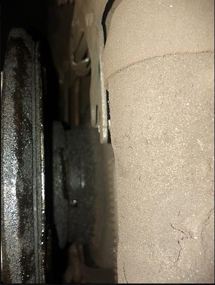

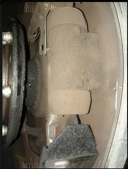

Here are two pics of the brake pad and the shaving and leaking that has been taking place.
Is this common for 4runners to have rear brakes locking when coming to a stop because of the gear oil leak onto the pads?
It is a pretty common failure. It might be pricy to fix depending on who you go to with the issue.
how could gear oil cause the breaks to stick that bad? if anything i would think it would make them have less resistance.
I would tend to agree but I am not a gura of brakes. When my rear axel seals failed, I drove around for weeks without any sticking.
