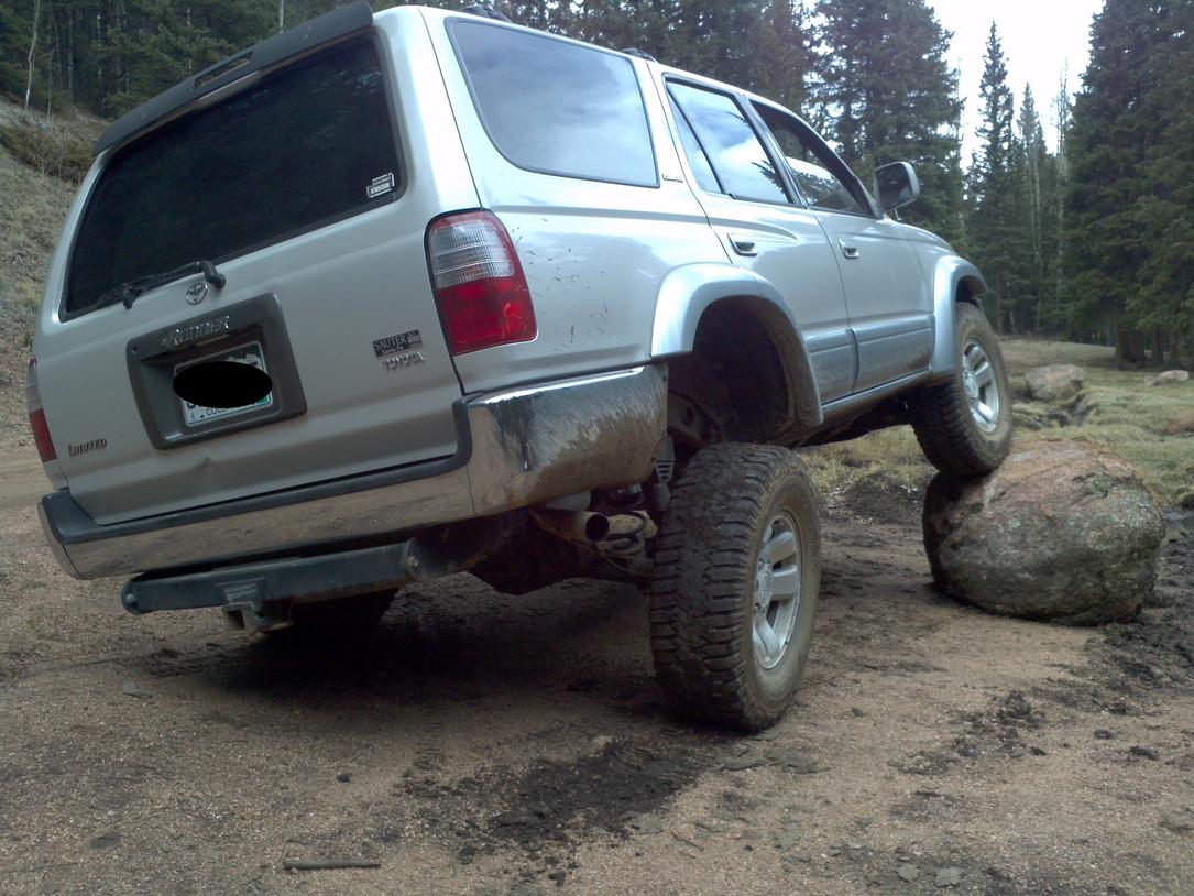

I did the same with my 8 wraps and the rear was nice both on road and more so off road. I just went to NAPA and asked for a rear set for a 94 Toyota Landcruiser. **Shameless plug but you see what flex you can achieve. This is even with the sway bar still connected.** :biggrin2:
I love my 7 wraps and land cruiser shocks. I picked mine up from Steve at SS for around $120, he also included some extra hardware and instructions on how to bore out the top mounting point so the land cruiser shock mounts like it does in an actual land cruiser allowing full movement and articulation. Here is a pick of mine almost maxed out of flex with the sway bar connected also.

Man you guys have some serious flex going there, I can't wait to get the LC coils installed now!

You dont have too, I ran it like that in the pick without it. I dont have the info in front of me but I had to buy a Step up/Enlarger drill bit that looks like a cone. I then had to drill the top shock support to a larger size. Than used the extra hardware which was the OEM shock washer from toyota that comes on the landcruiser and fits in the new hole.
I would have to find the info and PM you the actual sizes and parts but like I said its not needed. Steve may give you some info but again he doesnt like selling parts if they are not using all the right parts and he would say anything over 7 wraps is too much.
