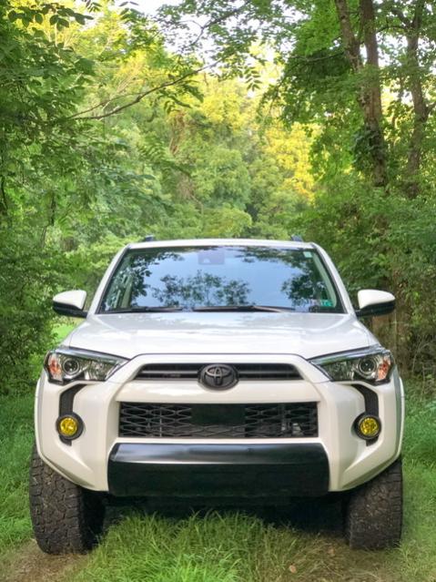

I just did this yesterday. Was easier than expected. Took about 2 1/2 hrs. Could’ve used a second set of hands to plug the fog lights back in. Kinda had to hold it with my leg while one handling the plug. Passenger side has a shield over the back of the fog light that’s tough to maneuver your hand behind. Overall very easy. I bought an OEM black valance from Bamswholesale and clips from amazon.
Edit: I have a silver valance for sale (decided not to wrap or paint it) just bought another black one.
