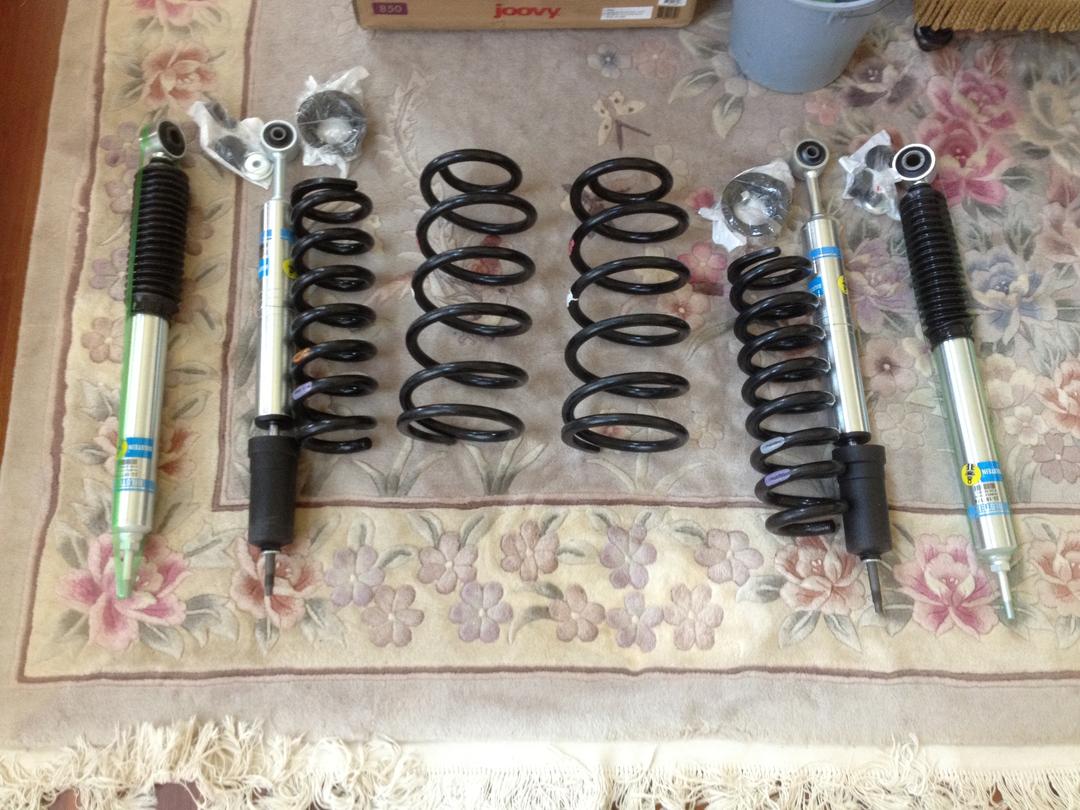

just got my oem fj coils in to match my 5100 bilsteins:D!
zu13
ok so i have a 2007 sport edition 4wd it had a stock XREAS system and it is being removed tomorrow. Along with the systems removal i will be having toyota install my new OEM FJ coils and my ride height adjustable 5100 bilsteins! i have set the front 2 coils at 1.75 or the third setting. I do not want a reverse rake but i do not like the rake, I do have a V8, a brush guard, a roof rack(2 lights on the brush guard and 4 on the rack), and tube steps. I am thinking that the 1.75 will provide me with enough lift to level the truck out and make it barely have a rake. Has anyone else tryed this with a v8 truck? I know with a V6 it probably would cause to much lift, but i have not been able to find anyone with a V8 with the same situation!
So please help me i am going to toyota tomorrow to watch them install the kit! should i keep the ride height the same or change it up?!
Thank you for your time! and sorry about the frequently aasked question but no one seems to have v8s that go with this combo, and write about it! haha

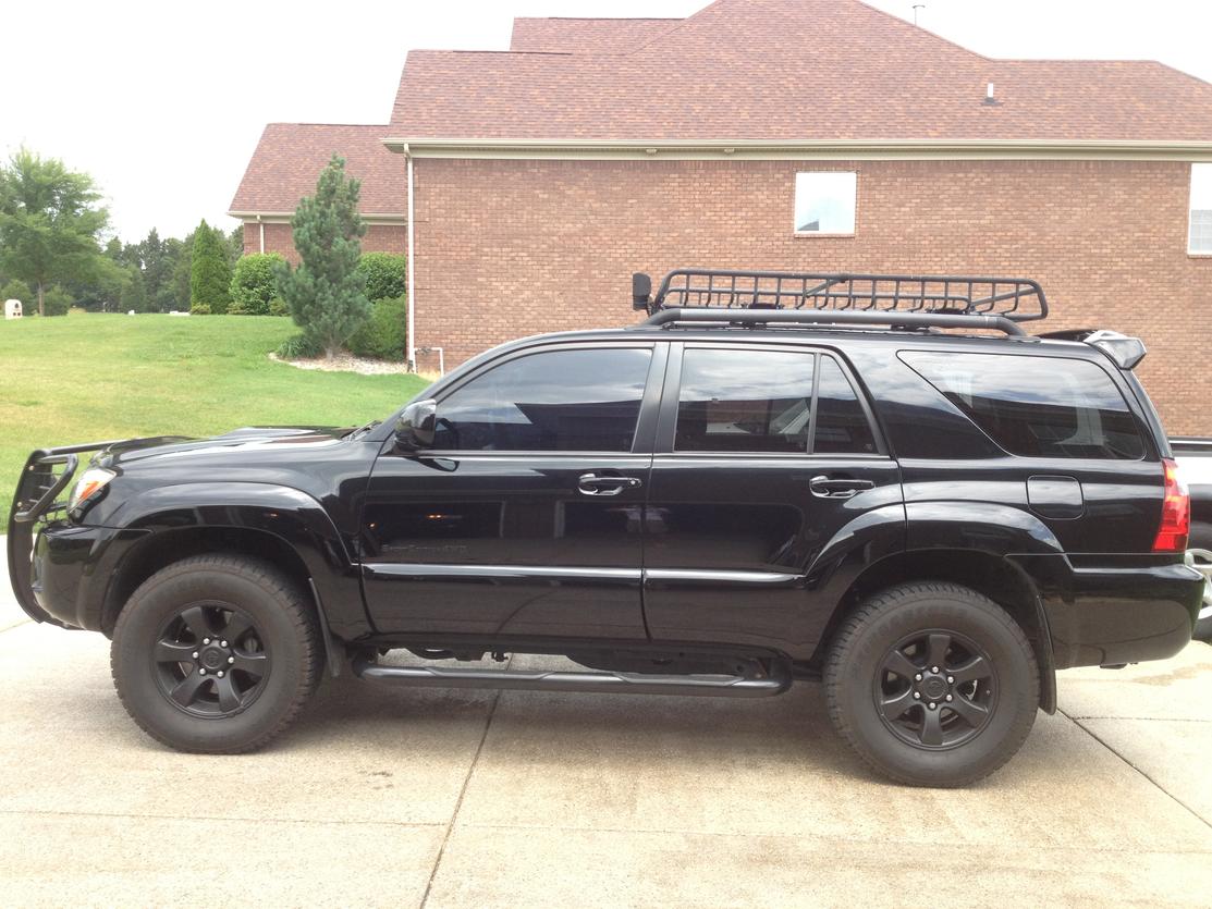

It doesnt look like the front dropped all that much with the stock stuff on it. I have a feeling it will be just a bit higher up front but you may not notice it when looking at it. I have just struts up front and the second from the bottom leveled it off but no brush guard.
04 sport V8 that I am looking at doing the .85 or 1.75" so it will be good to see yours. You should install it yourself.
I would reconsider the highest perch on the bilsteins. Without a spacer in the rear, I think you will be too high in the front. I have not done the FJ coils. But with a 1.5 rear spacer and bilstein on the highest perch, mine has just a little rake to it. Without that rear spacer, I am thinking the front would just sit too high. You might consider the next level down, or even the lowest perch. From what I remember, the FJs will give .5 in the rear on the V8. And the FJs in the front will give usually no more than 1 inch. So I doubt you want to add 2.5 to that. I am really interested in what you go with, as I still have to decide if I want to do the FJs. Keep this thread posted.

I just recently installed 5100's all the way around but kept the stock springs(for now). I have an '04 V8 and set it at 1.75 and it was perfectly level when we were done. It has BARELY settled maybe not even noticeable unless your a freak like me lol
Absolutely hands down the best mod I have done. You will actually be surprised with the difference in the ride.

I would set at .85 with the FJ springs. You can search for the FJ swap info that Ark put together. Its been determined from compiled info that you shouldn't expect more than 1/2'' from rear FJ springs. You'll end up with 2.5'' front and only 1/2'' rear, and will actually appear to have a ''bro lean''.
You cant just pay attention to the wheel well height. To be dead level, you actually want the front actual wheel wells to be 1'' lower than the rear wheel wells. Trust me on this.
Also trust me that you will love the 5100's! I've had mine for 2'' front lift and stock coils for a couple months and love them! (I also threw a 1'' rear Cornfed spacer in as well, and I'm pretty level).
Actually, my measurements with stock tire size (yes, sadly still running 265/65/17's), are 35'' front, 37'' rear. Frankly, I'm pretty darn level with this.
It looks like you have 265/70/17's? If so, the sidewall will add almost exactly 1/2'' in height vs stock.
Enjoy and goodluck.

Oh and the shocks don't lift. You just get lift from the FJ coils. Again, search for that thread by Ark, I believe the FJ's up front might give you about 1/2'' by themselves. If you combine this with the billies at 1.75 (they call it 1.75, but its really 2''), then you're getting 2.5'' up front. Make sense?

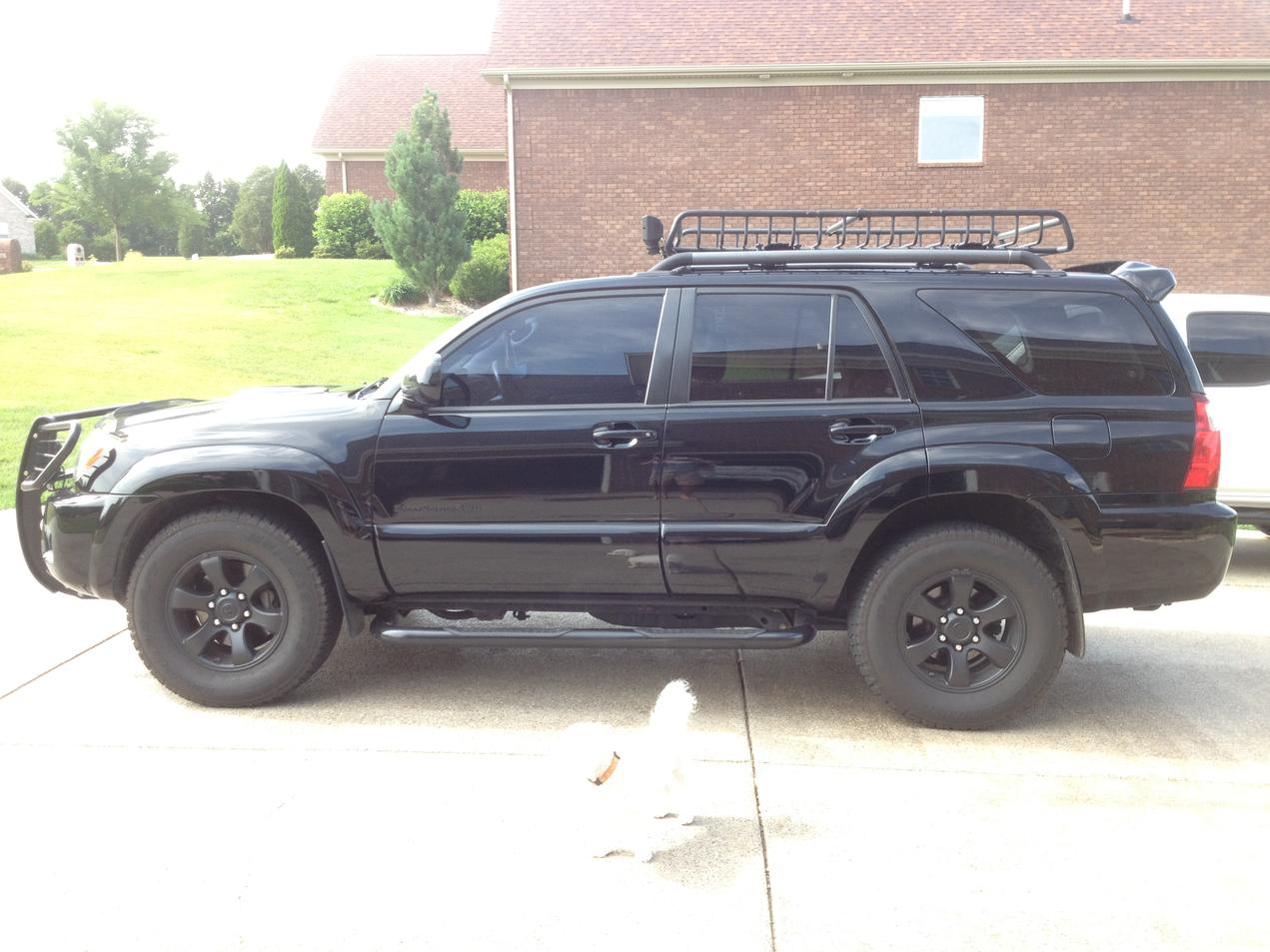

but the measurements when they are done from the ground to the top of the fender right where the body starts is 37 inches in the front and 36 3/4 in the back!

ok i let the runner sit for a while and drove it around a little bit and filled the gas tank up!!!
the ride height from the bottom center of the tire to the fender right where it touches is....
Front left tire=a hair under 36 Front right tire=a hair over 36
Back left tire= 35 1/2 exactly Back right tire= 37 1/2
the gas tank is on the right side and it is a 23 gallon tank..... is that why the back right and front right are each higher then the left side? or could something have off set it?

Sounds more like where I'd expect it to be now on the measurements. No worries on not measuring before... Most 06-09's like mine, started off (stock) at around 33-33.5 in the front, and usually right around 35.5-36 in the back.
Fyi that your tank is on the ''left'' (or drivers) side. Hence the sag. That is more sag than I would expect however... I'd monitor it for awhile and you could always throw a little spacer on the left side pretty easily to even them out.
