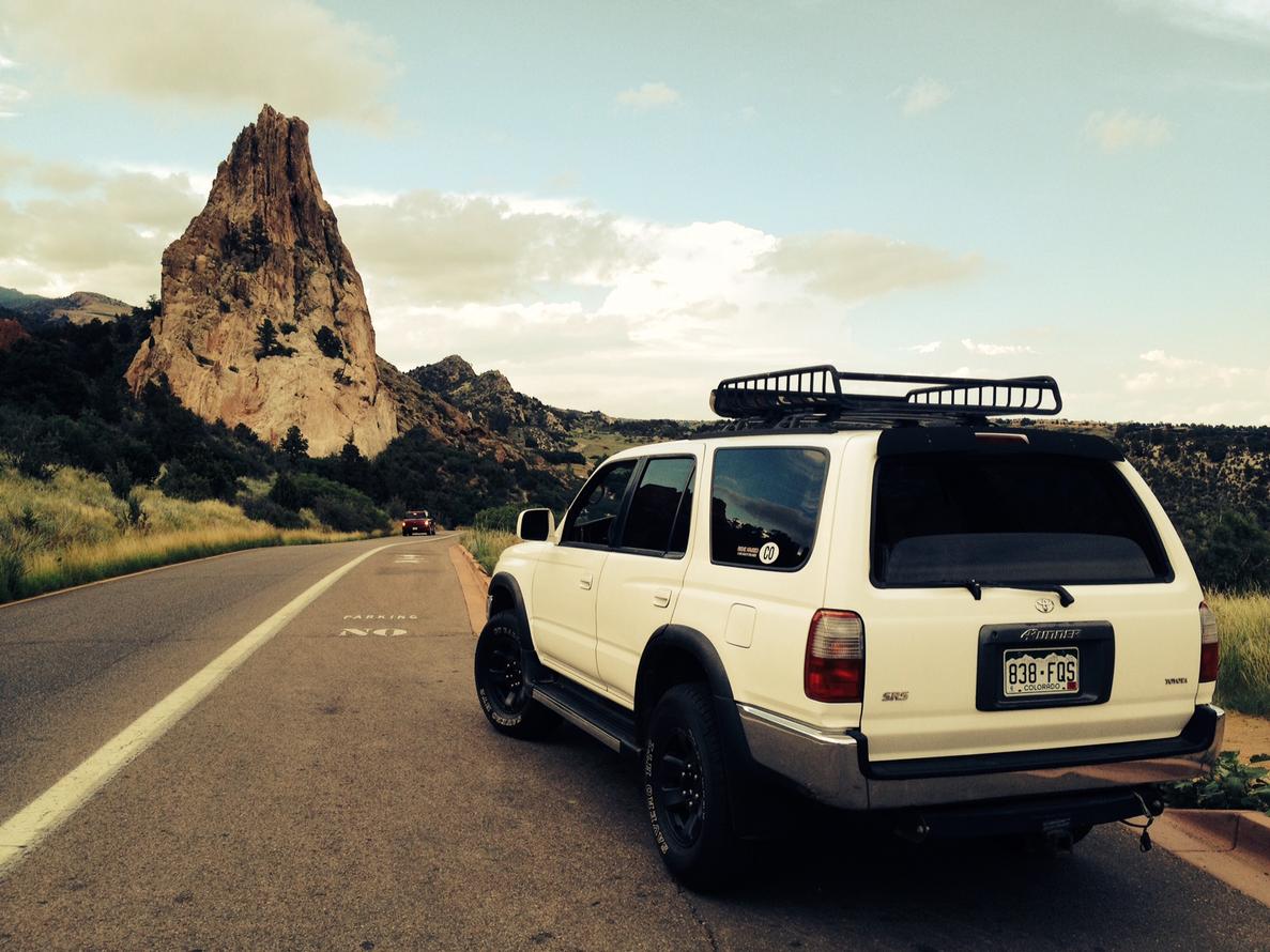

My personal struggle for the day. I love my 4Runner. 1998 SR5 and just rolled over 200,000 miles this week and it's my DD.
The truck is in decent shape but definitely has some significant maintenance projects coming up. The suspension is just about shot and its time for shocks, struts and coil springs. Also needs tie rod ends replaced.
After driving for a long period of time, I'll let the 4Runner sit for 20 minutes (like to fill up) but on start up, I get a large puff of black smoke out of the tail pipe. It doesn't smoke on a regular basis. Just when I drive for several hours and then start it up again. I was told it's most likely a valve seal issue and it would be more cost effective to replace the motor with a lower mileage used engine.
I want to have the seats, headliner and carpet reupholstered/replaced. The previous owner was a heavy smoker and I can't seem to get the smell out--plus the interior is tired anyways.
So after all of this, I am torn. I love this car and cant decide if I want to sink 5-6k into building it up, or dive into a 5th gen 4Runner.

Damn, that is a sweet 4runner. $5-6k seems like a rather high estimate for all of that. Unless you do some performance parts. But still, that's way less than a $30k new 4runner!! Personally, I'm really into fixing up old, reliable cars and driving them. If you love it, keep it. If you want a new car, pass it on to the next guy. You'll still get some money out of it...

Good looking 4Runner by the way!

Just hit me up when you get back. I'm close to Garden of the Gods, not far from where you took that picture. :)
