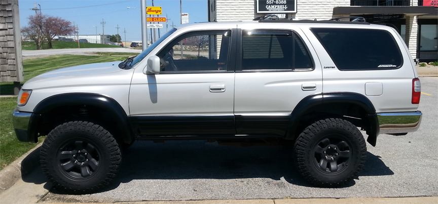

Best I can do on pics at the moment. The contingency on the amount of lift depends on how everything settles, aftermarket bumpers, winch, etc. I don't know how much lift you want to achieve. If you want to be sure you have more than 3", put it on the second perch (technically should be 1.25 + 3 = 4.25"). Depending on what you're doing, I would think that should get ya 3.75 at least. If you start going up on the perches, your ride will get harsher.

sorry, JayRolla - I got distracted while creating my post. Your post was up after I finished mine. I appreciate your help. OP listen to JayRolla, he's a wiser man than me -

Man your black flares and cladding looks good. GOod job, I would say im wiser at all!!
