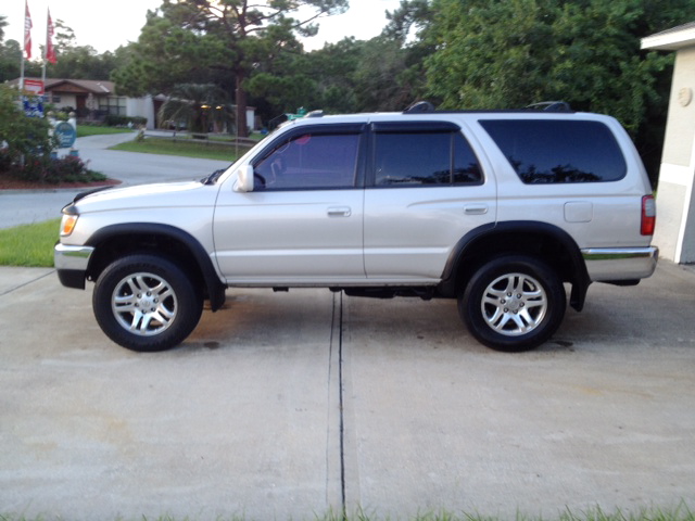

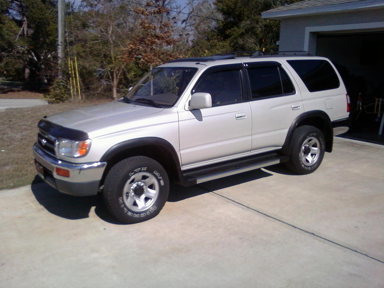

I too have a 97 SR5. Mine has 152k and had 15" steel wheels and rode like crap until recently. I put 17" Tundra split spoke wheels and tires and I just replaced my 2WD springs and shocks w/ 99 tall springs and shocks. HOLY CRAP my truck rides SOOOOOOO much better. Looks much better and updated. Heres a before and after.
