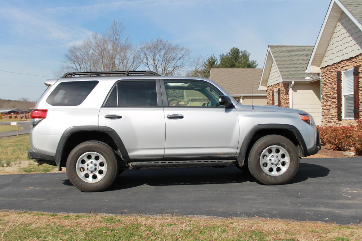

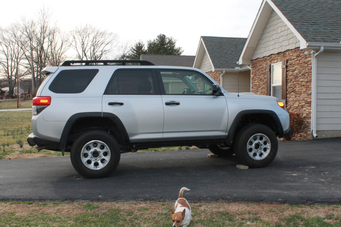

Before and after just so you can see a direct comparison.

Thanks for that pic KTM. Your truck stance is great. If I can't get these anytime soon it may be OME after all. What size tires are in those pics? Stock?
