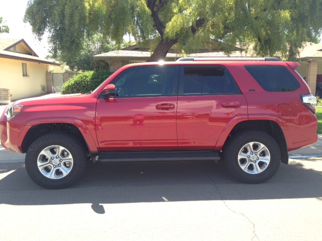

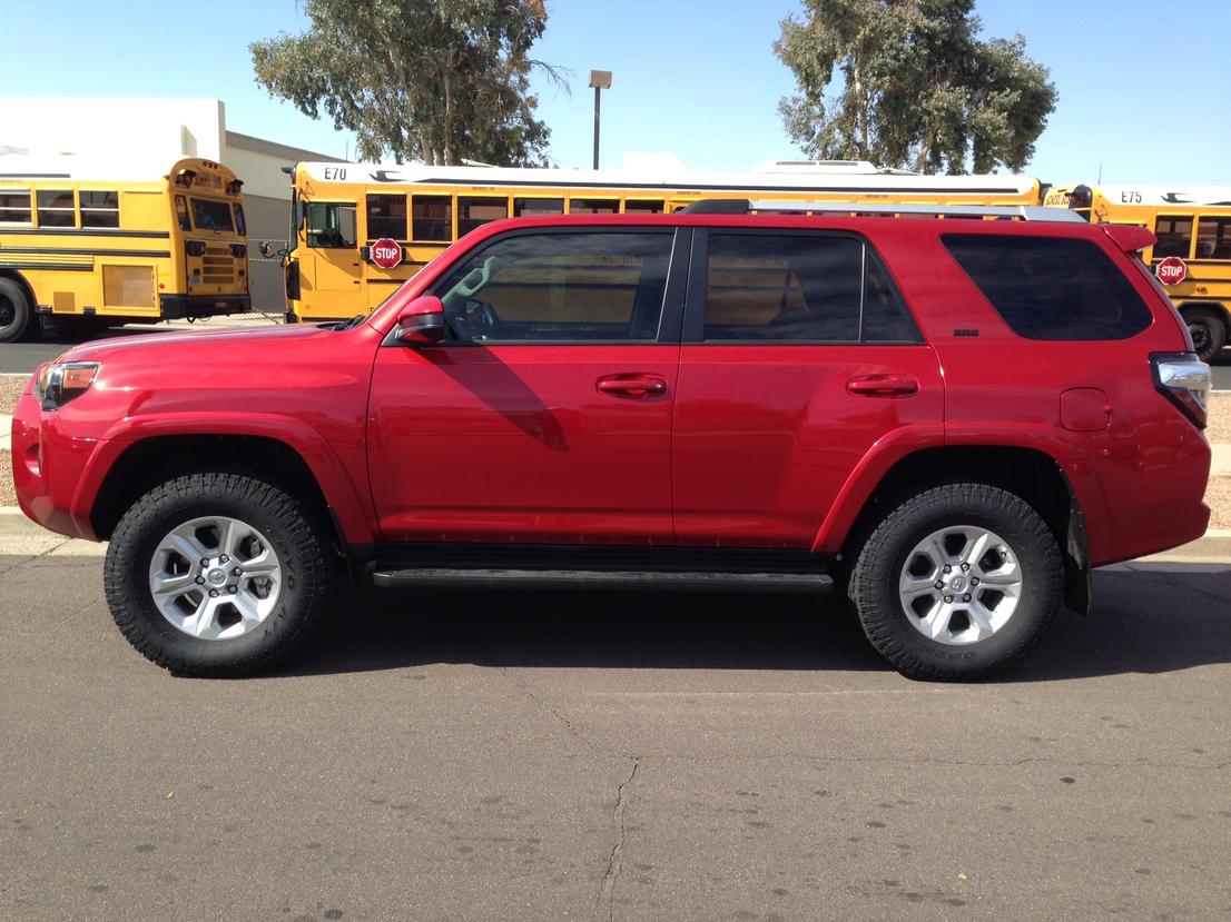

Congrats on the new 4R. If you already haven't seen a pic of this, here is mine.
She has 5100's on the front set at 1.75 and 5100's in the back with Toyo Open Country A/T II's in a LT265/70/R17.
First pic is the before and second is her today.
I considered doing the top setting on the front Bilsteins with spacer or taller coil in the rear, but I like the way the 265's look and fill the fender wells. I did not want 285's and deal with possible loss of power and speedo being off.

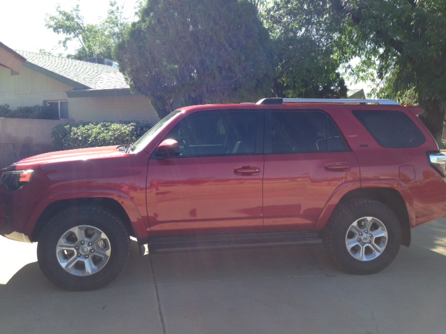

Third picture is her with about 200 lbs. in the back (about 15 gallons of water and my 10 year old).
Works for me, hopefully the pictures will help you decide for your wants.
