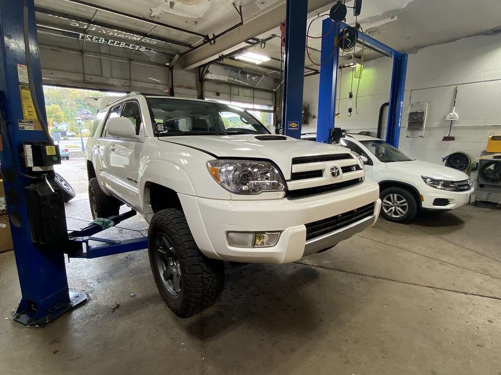

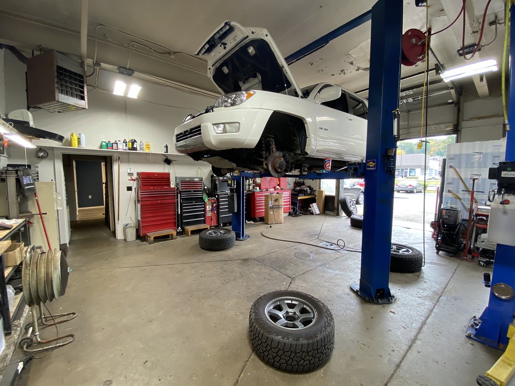

I did things a little backwards. I had the DT Y installed before I ever pulled the trigger on the headers. I did not install the Y, but my buddy who owns a pretty reputable repair shop and a built 3rd gen, did the job. He told me they tried every angle and config they could think of, but could not get the Y to match up to the stock driver side manifold. They did a pretty good job on the cut and repo.
Now fast fwd 10 months and the modified Y won't match up when I installed the headers lol. So it needed to be modified again, and I drove it over to his shop wide open 4.7 hittin the airwaves. I will say his welder does pretty good, and my bud being a T4R fan, helps my wallet with cash deals after close of business. That way his welder gets paid off the books too.
I wonder if I had done this the right way if the DT Y would have matched up to their headers. Now if I want to have CATS put back on, guess what? The Frankenstein Y gets modified.....(Forest Gump voice) AGAIN......
The strange thing is the passenger side matched perfectly with both installs, never had to do anything to it.
I also wondered how much variation of manifold fitment might be across all the different models and years of Yotas that have the 2UZ, and how many cross referenced parts were used over the years.
Hell DT's donor truck (or mine) could have had a drivers side Tundra manifold stuck on there at some point over the years, throwing off the geometry a little.
So I really have no evidence to offer because I was too busy and wasn't there for the initial mod of the DT Y last year, and will never know if it was their fault or not.
Learning the hard way is how it goes, seeking power out of 4Runners lol.
Can't say I'm not happy with how they sound and perform though. I just re-torqued the header bolts after a couple thousand miles and only got an 1/8 to 1/4 turn out of just a few of them. So they're sealed up tight with the gaskets and heads and breaking in pretty well.

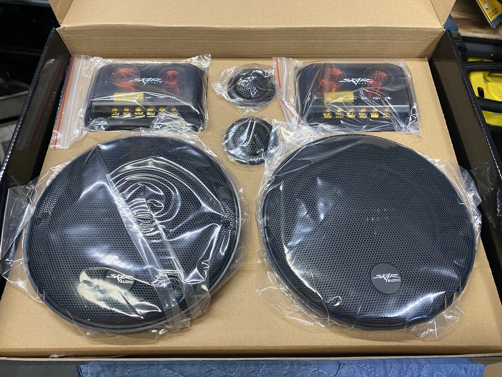

Well, I've been getting busy with small projects while couped up at home. So here's yesterdays project!
The first speaker took about 1.5hrs to trim the adapter and figure everything out, but the rear doors were quick, and the passenger front was quick once I knew what I had to do.

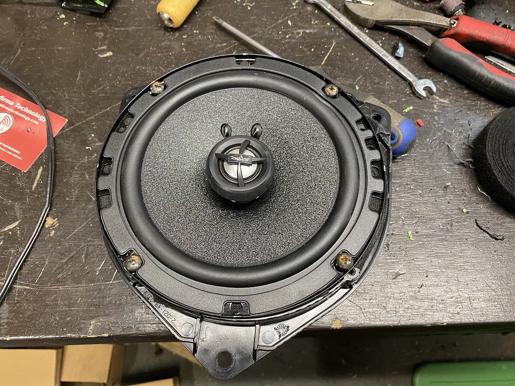

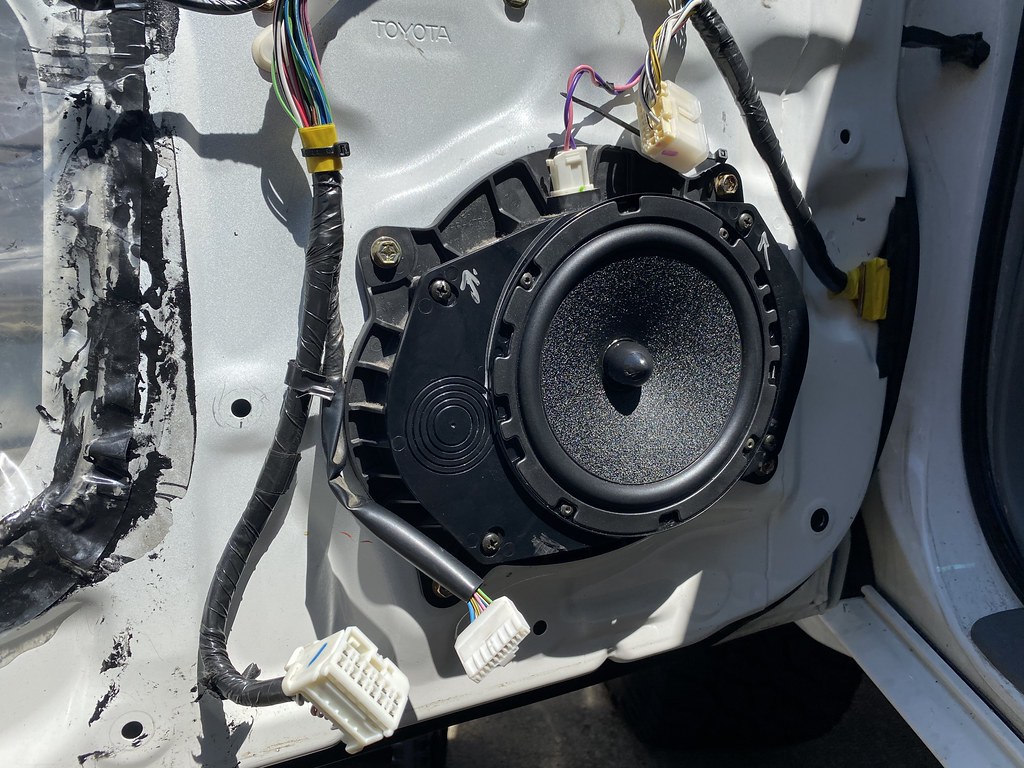

Bought some 6.5" Components for the front doors, and 6.5 2 ways for the rear. I used the Skar 8" woofer to replace my JBL unit so I figured I'd give their door speakers a try. Pricing is pretty good on these and overall I'm happy with the upgrade.

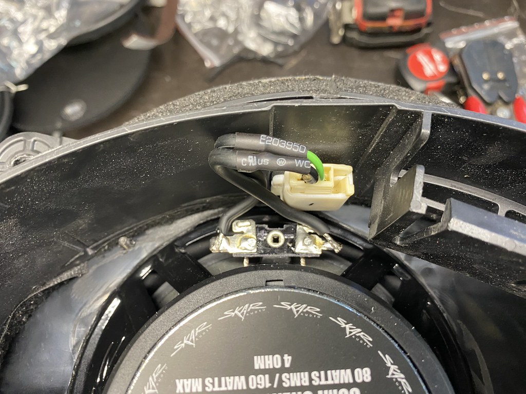

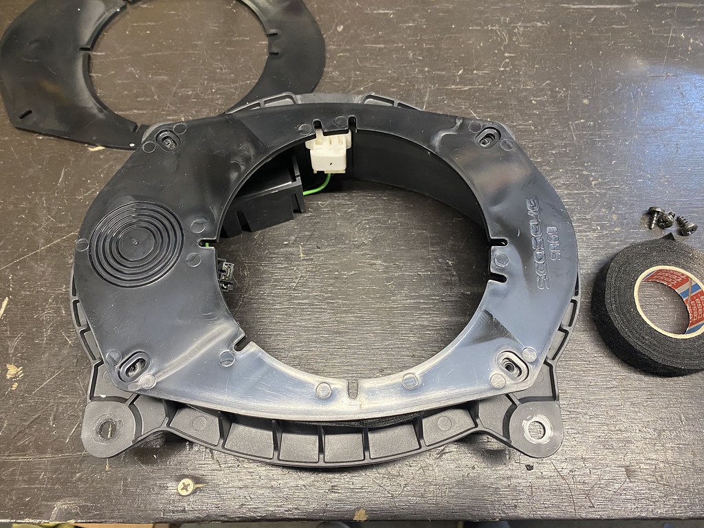

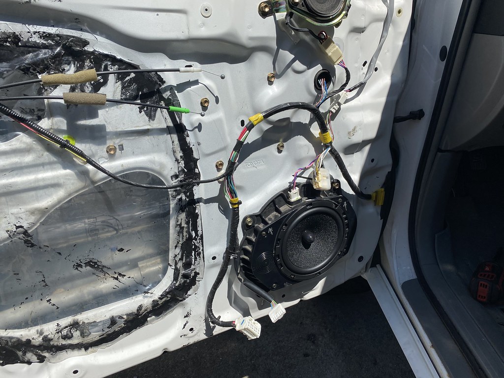

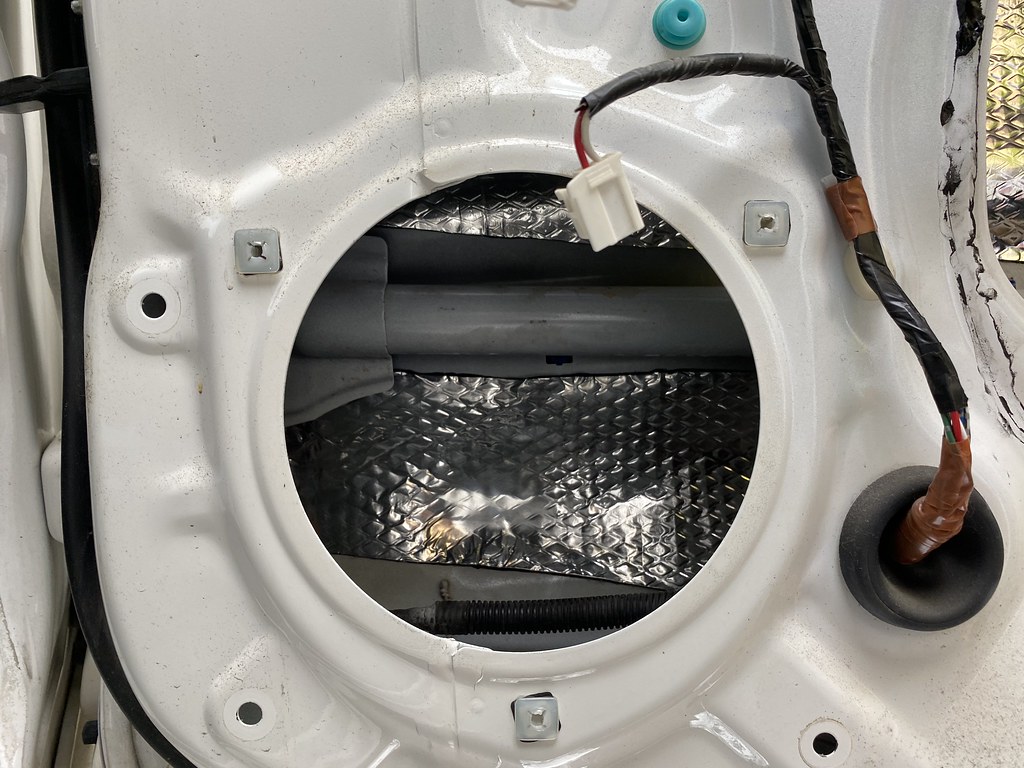

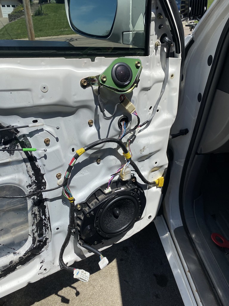

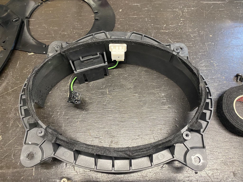

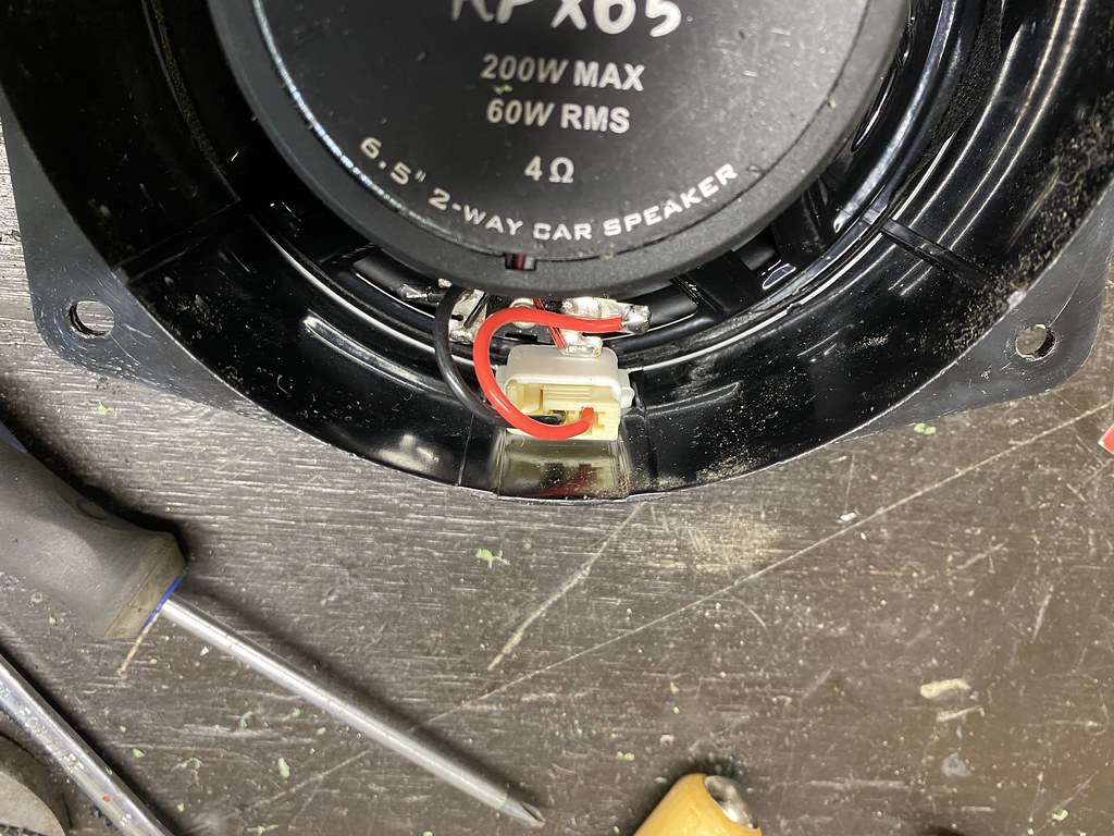

Took the front door speakers out, it looks like the JBL setup has a resistor/filter built in to the housing/wiring. I decided to bypass this which seems like it worked alright.

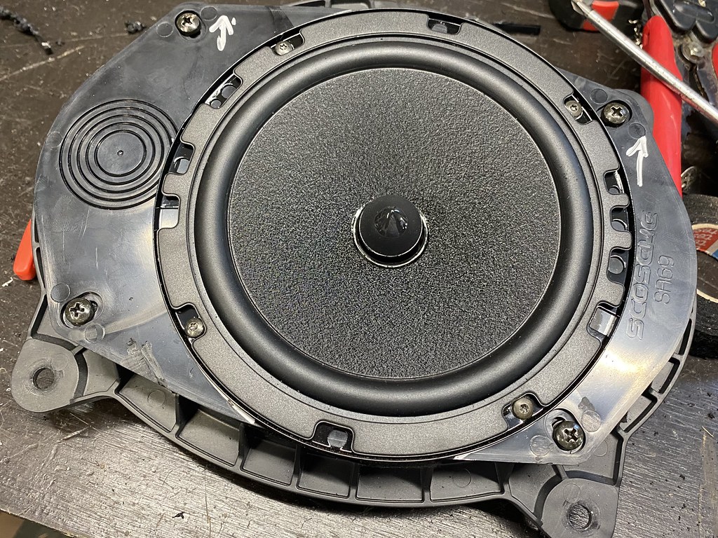

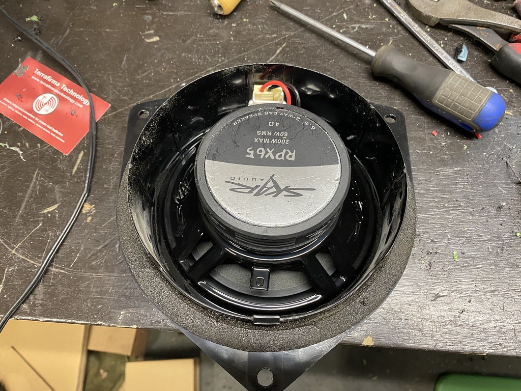

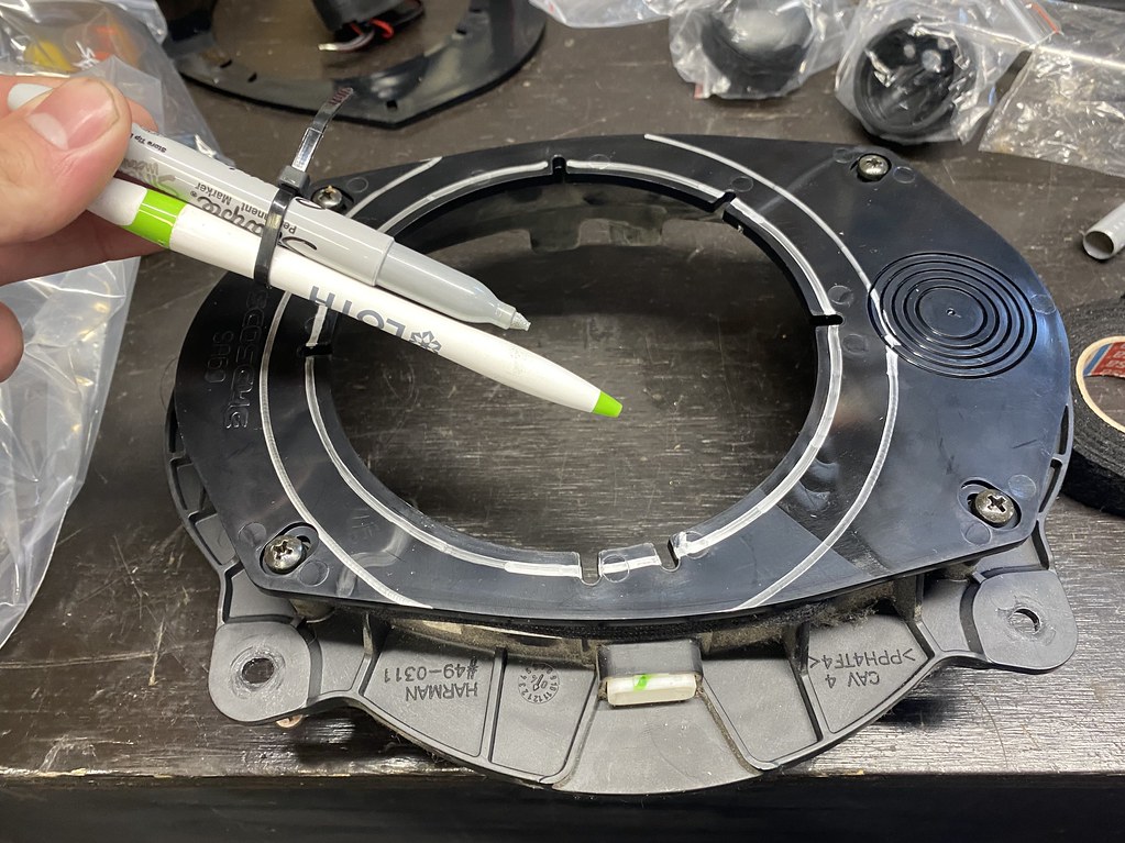

Prepared the Scoche adapters I bought, these are listed as 5.25 and 6.5 adapters, but I ended up having to do some trimming to make the 6.5 work. In a perfect world, I would have returned these and bought different ones had I known, but instead I went at it with a dremel.
Used this to mark how much extra I had to cut out of the opening to keep it consistent.
And installed in the bracket. I used some leftover torx bits I had in my hardware boxes (mostly from Volvos over the years)
I made a little extension to the harness and soldered the connections.
and installed into the door

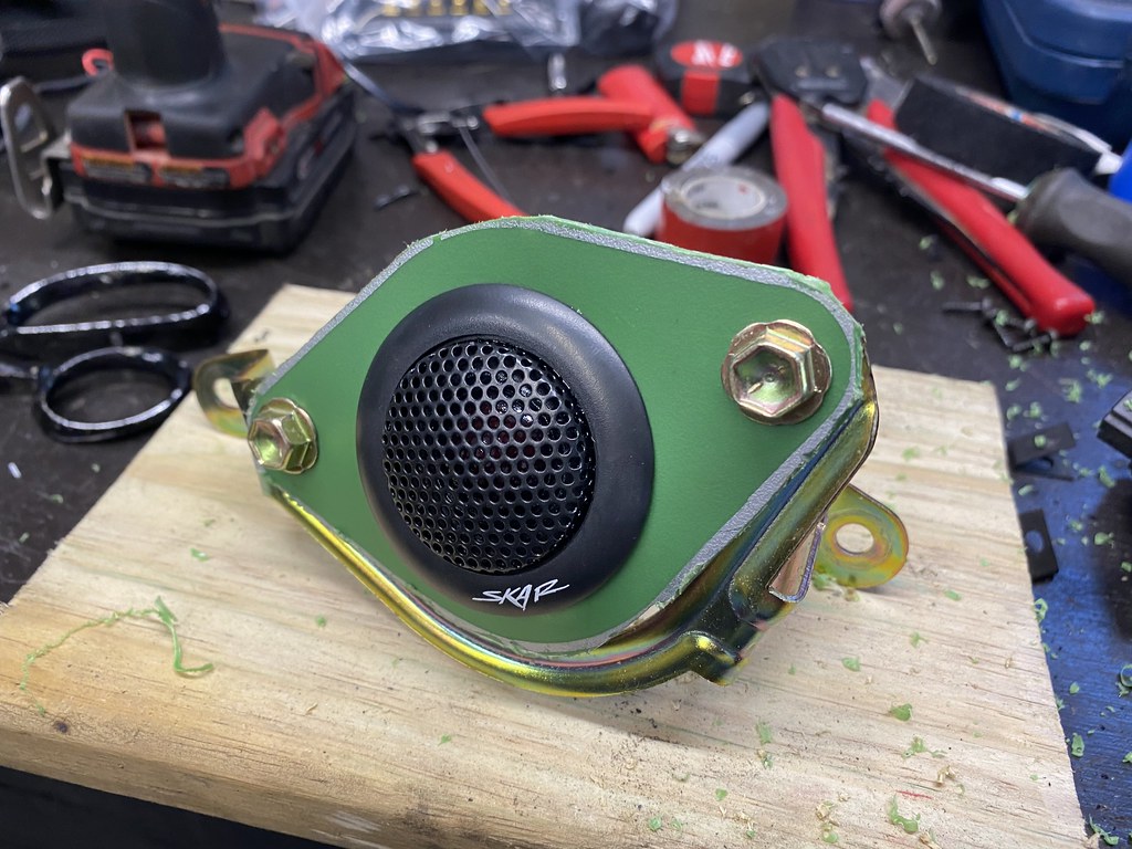

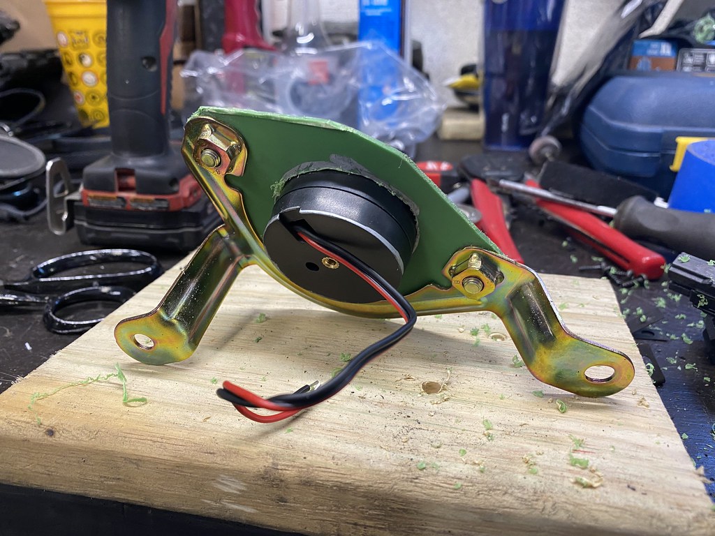

Moving on to the tweeters, I used an old storage tote lid to cut out some plates to mount the tweeters into the factory brackets. I did the same with the wiring and just spliced these into the factory wiring instead of using the crossovers, this worked out well and although it might not be the best way to do it, I've done this in other cars with decent success

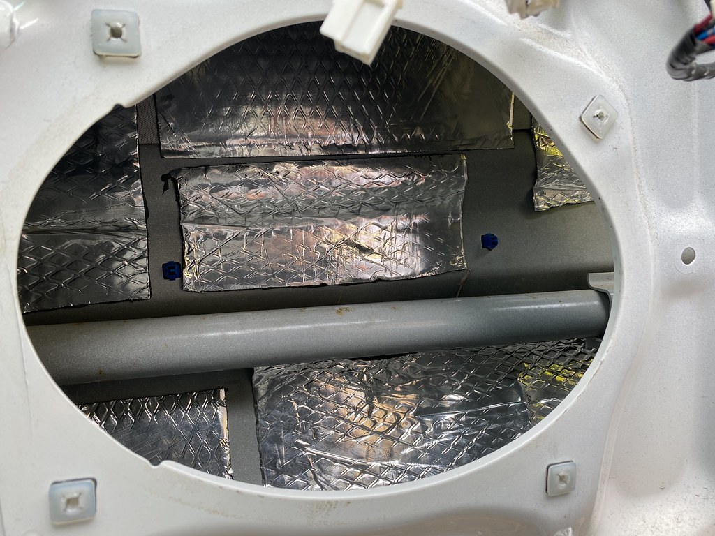

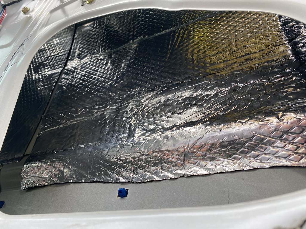

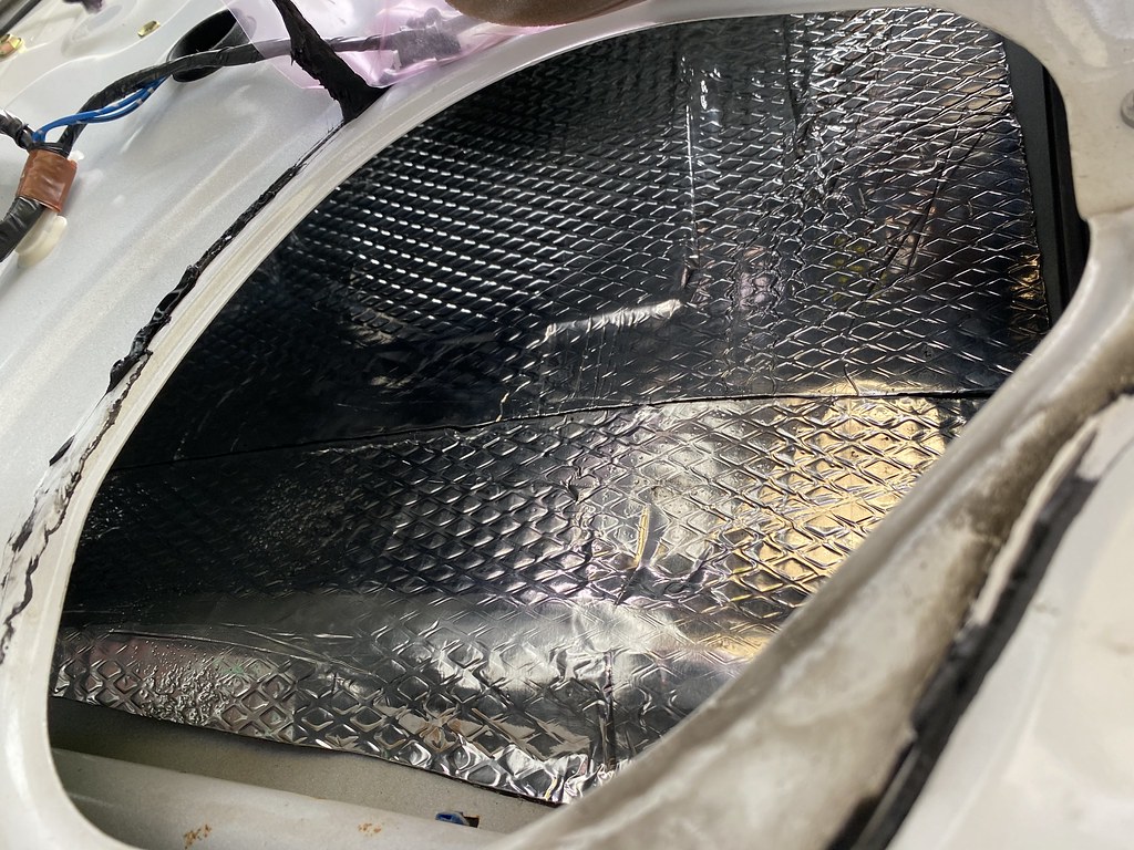

Moved onto the passenger front door and laid in some Noico sound deadening. I had already done the drivers front door when I swapped it after the wreck a few posts back.

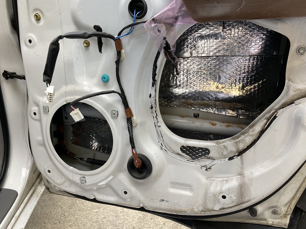

Moved onto the rear doors, these were much easier overall.
Same process for adapting the wiring to retain the factory connections so I can easily remove the speaker. I found out that there is a harness you can buy to do this, but I have no intentions of putting the factory stuff back in so I had no issue deciding to cut the factory wiring.
Sound deadening in the rear doors. I used approximately 4sq ft per door, maybe a little more on the fronts.
Overall these are a great upgrade! For about $130 for all 4 doors I cant be happier. I chose to do 6.5" in front instead of the 6x9's and initially I was worried they wouldn't be as bassy, but after making some adjustments on the EQ on my headunit, these can handle a lot more before sounding crappy so I was able to get easily as much bass as the 6x9's used to produce out of these 6.5". Also, if anyone needs JBL stock speakers, these are for sale before I throw them out. Yes, I have cut some of the wiring, but it all can be soldered back together with what you have existing should yours be totally toast. I have the front door tweeters, 6x9's, and the rear speakers. Would love to sell them off rather than throw them away.

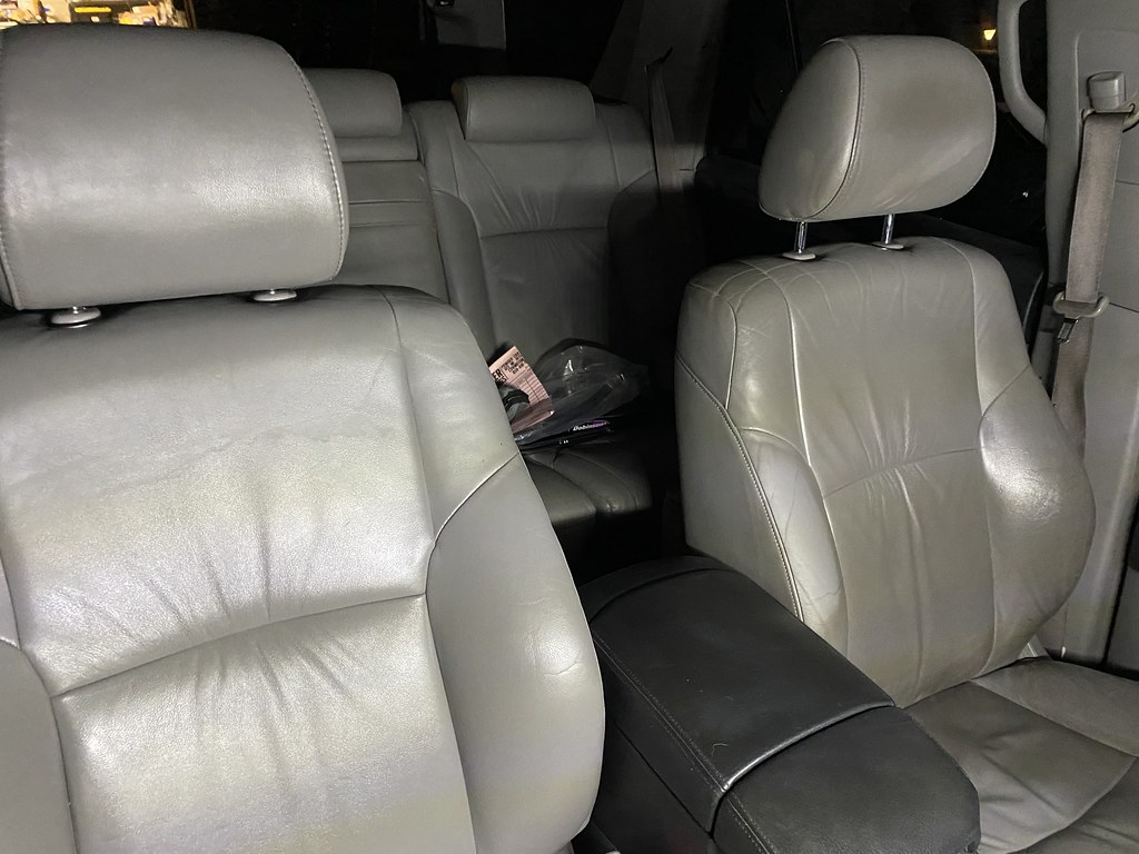

Now onto my interior renovation project.

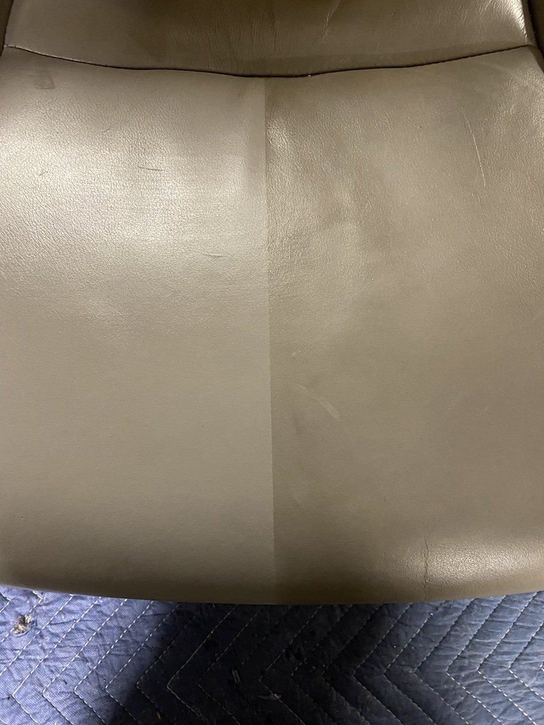

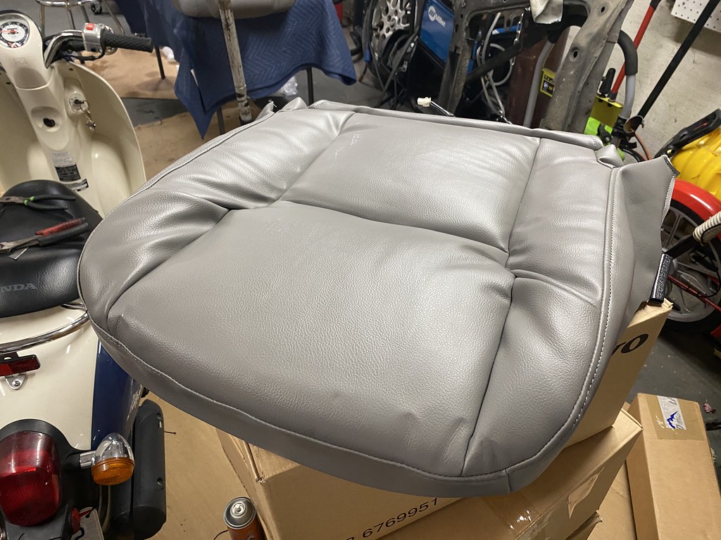

Initially the replacement seat cushion didn't seem to match.
Untitled by John Van Cleave, on Flickr
After some time with a magic eraser...
After and Before (have only done the passenger side)
Much better!
Now just waiting on the replacement seat foam from Toyota for the drivers seat so I can get it all up to snuff!

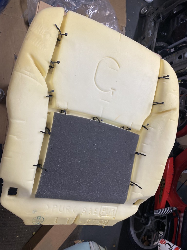

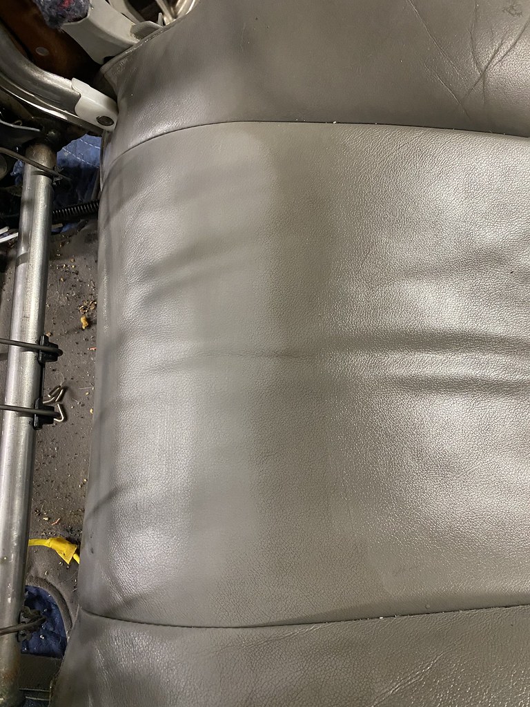

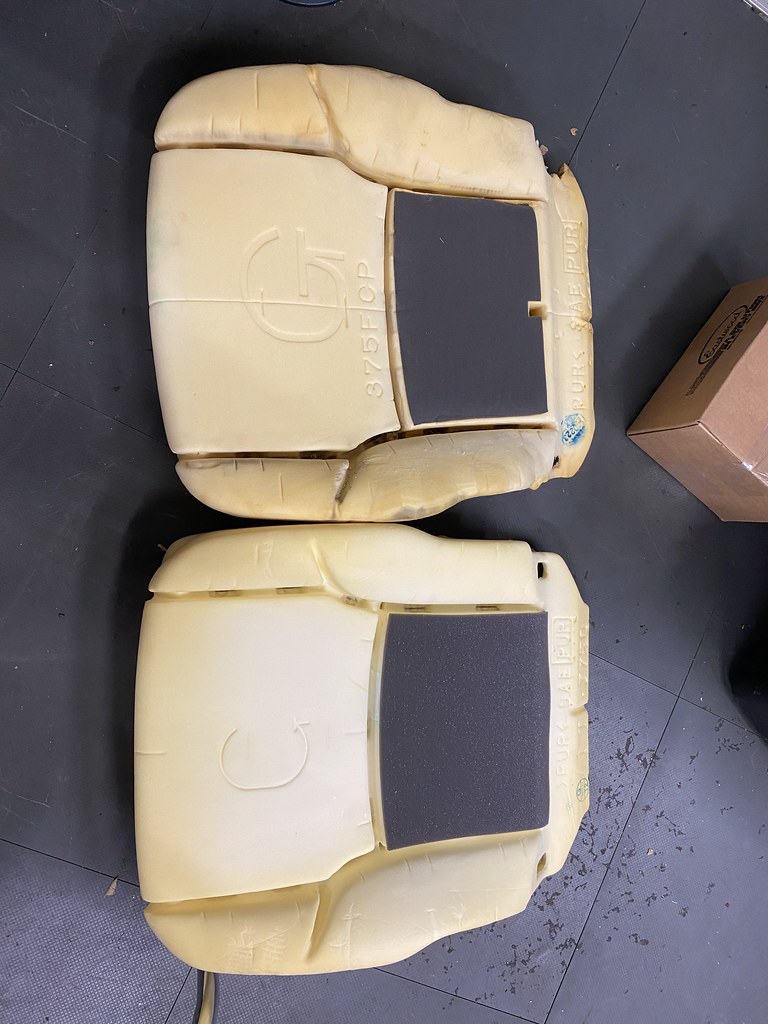

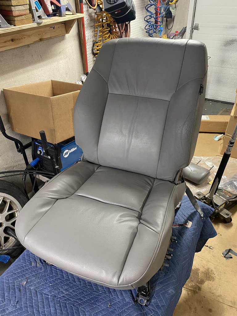

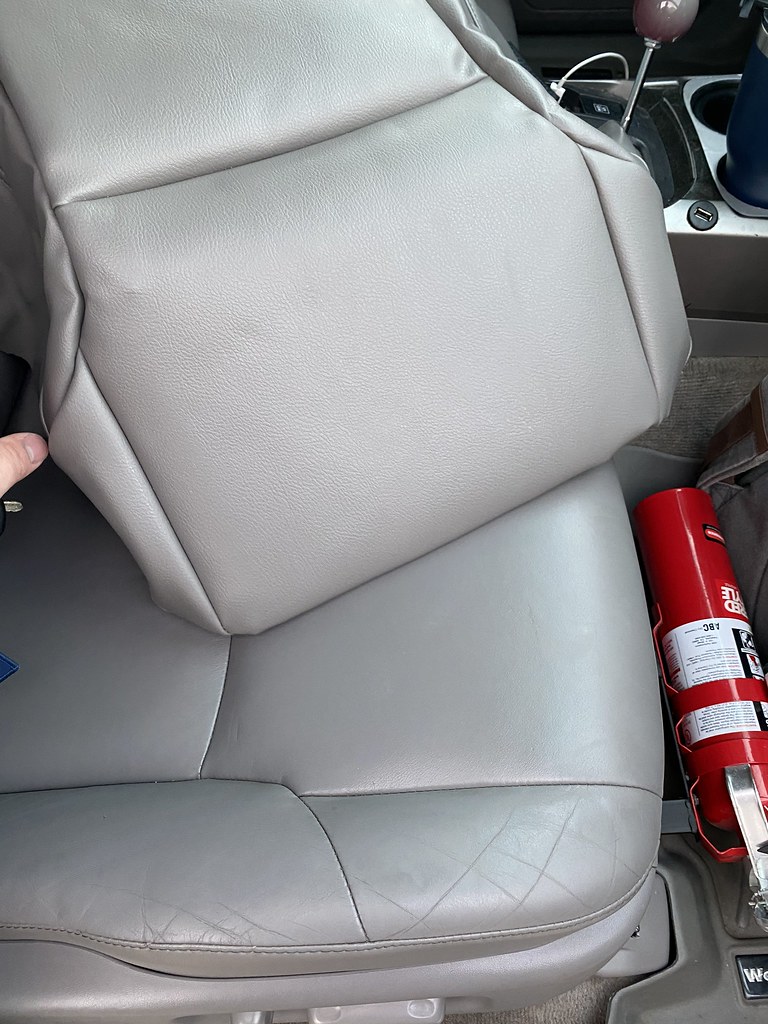

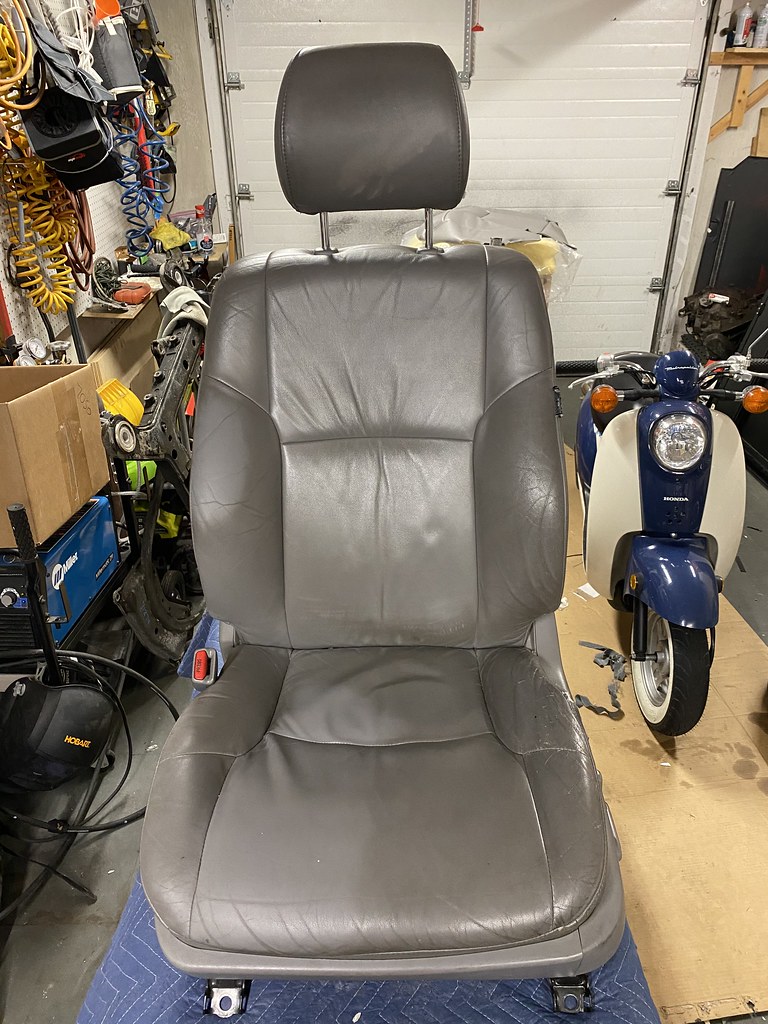

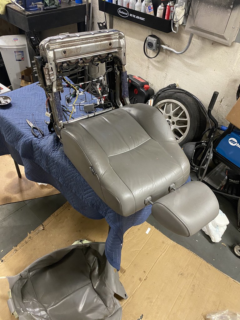

Got around to doing the drivers side seat cover last night. All in all, it wasn't too bad of a job, I think I could have done a slightly better job if I did it over again and got the seat cover tighter. Anyway, here are some more pictures.
Removed from the truck and on the table in the garage.

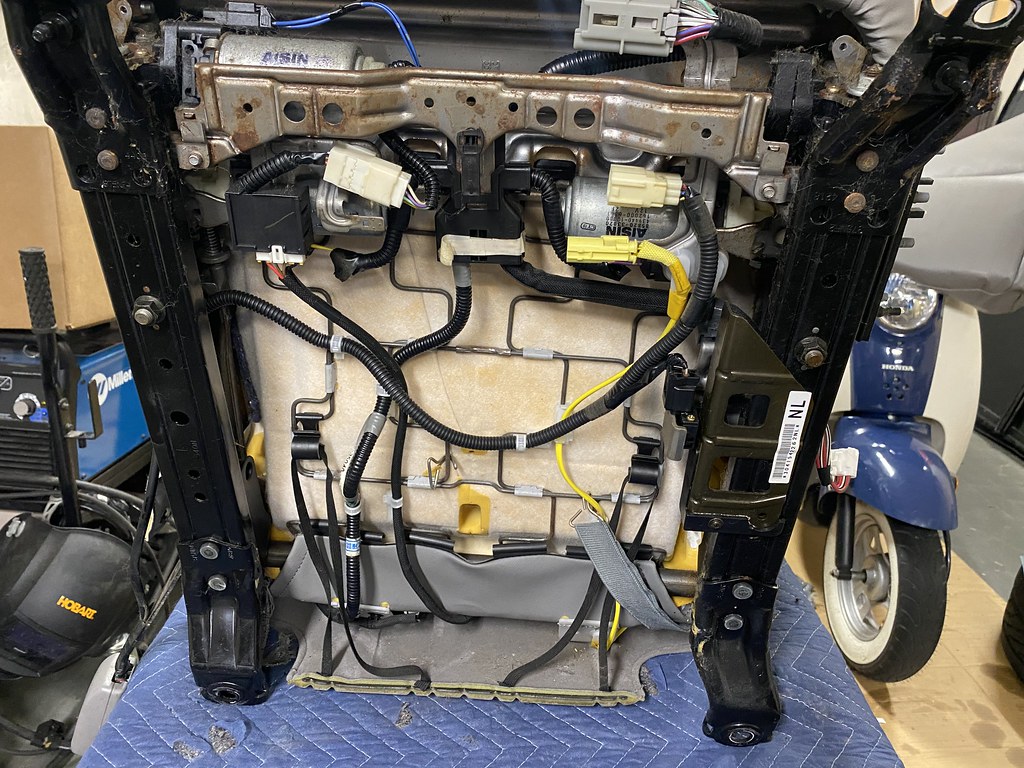

Took a few pictures to make sure that I knew where everything goes when I put it back together.
Old foam on top, new on bottom
It was at this point I realized I really had no idea what I was doing...
Scrubbed the seat back while I had it all apart, this is just magic eraser.

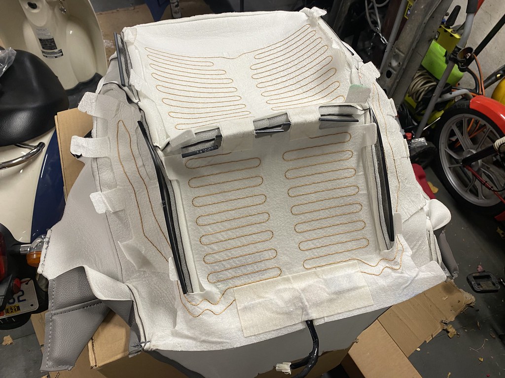

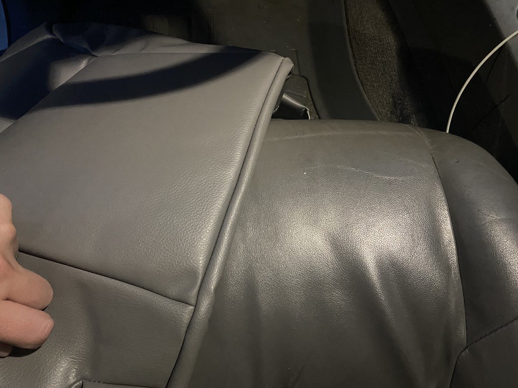

Had to remove the old heated seat element from the old skin and put it on the new one. I used a little it of spray glue to hold it in place on the inside of the new skin.
I used small zipties in place of hogrings. I saw someone do this once and it seemed easier than buying hogring pliers and doing it that way. We'll see how it lasts!
I think I might have over tightened a few zipties causing some of the ripples. I'm going to give it a week or two of use and try steaming it a bit to see if I can tighten up the material.
Partially re-assembled.

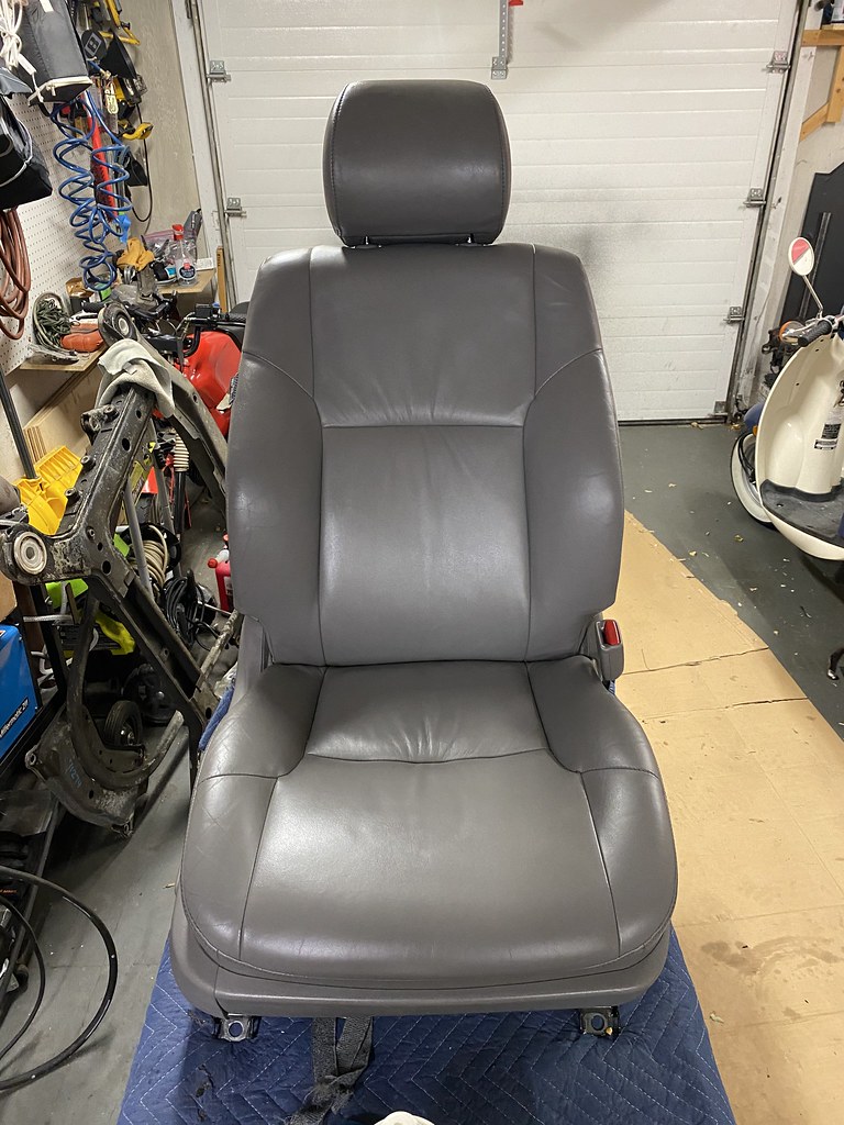

And back in the truck about 2.5 hrs later!

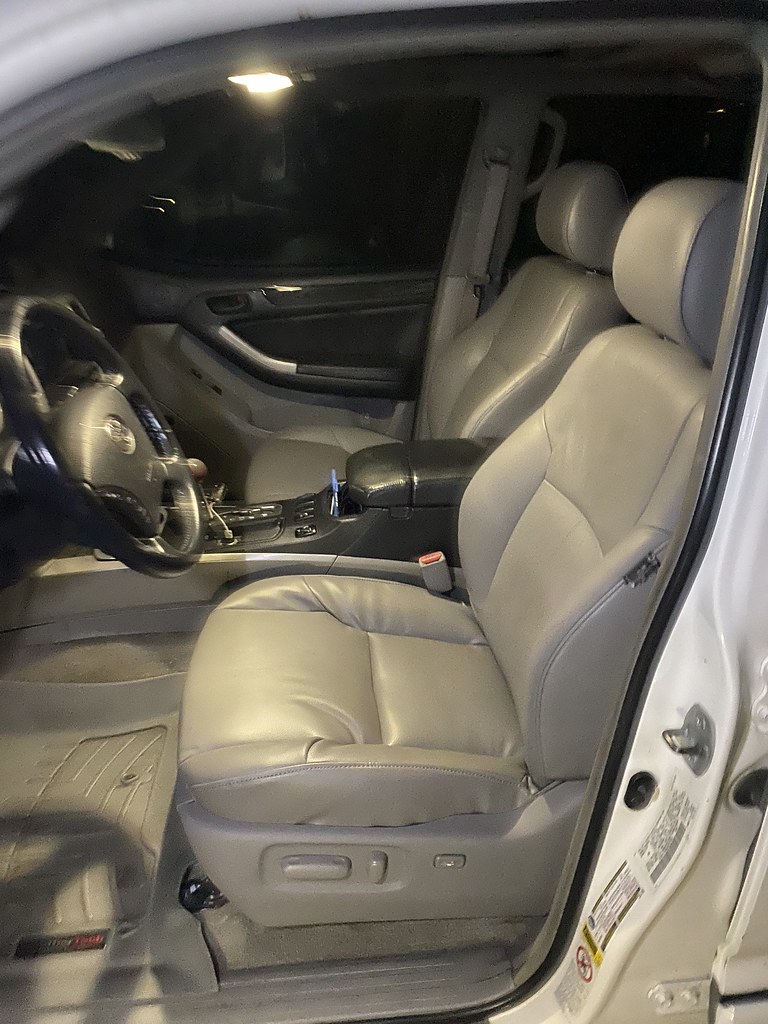

Not too shabby for an eBay seat cover! Match is pretty close, it might be a bit baggier, but that also might be because I don't know what I'm doing with re-upholstering.
All in all, the seat feels like a new truck. I wish I had done this sooner!

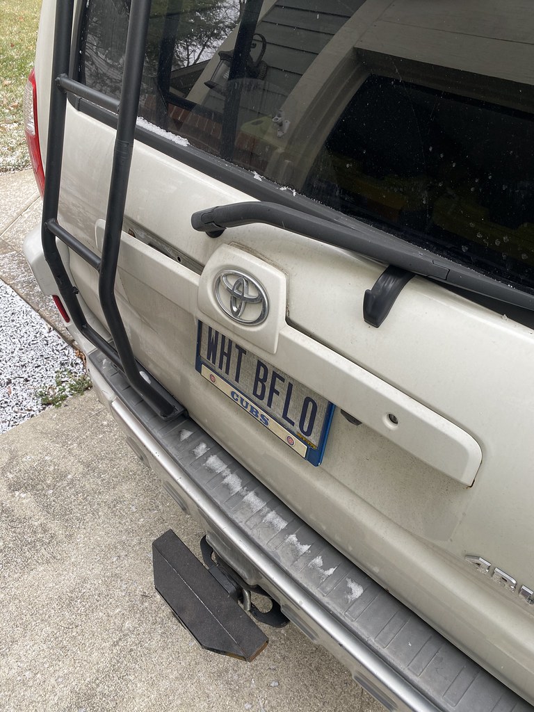

While moving, it was quite cold and my rear trim came free. Hard to tell exactly what happened, I'll open up the tailgate and see how I can fix it once it warms up a little. In the meantime, I can release the trunk from the latch and use the ladder to pull it open.

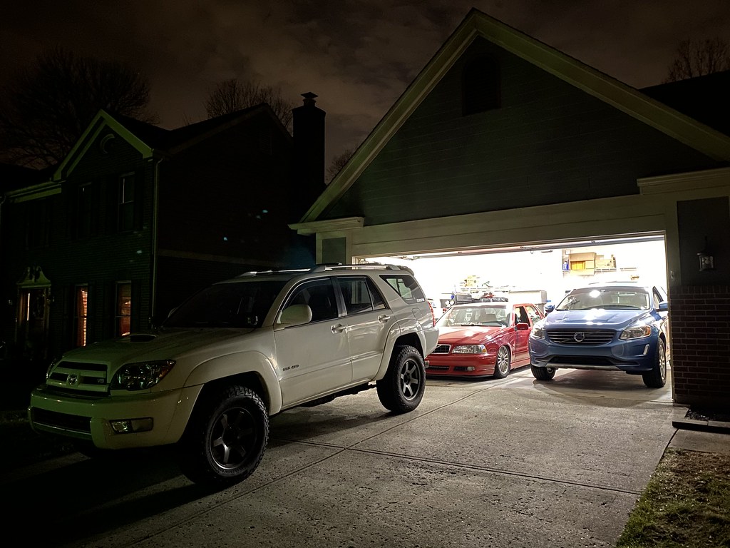

Starting to get situated in the new garage!

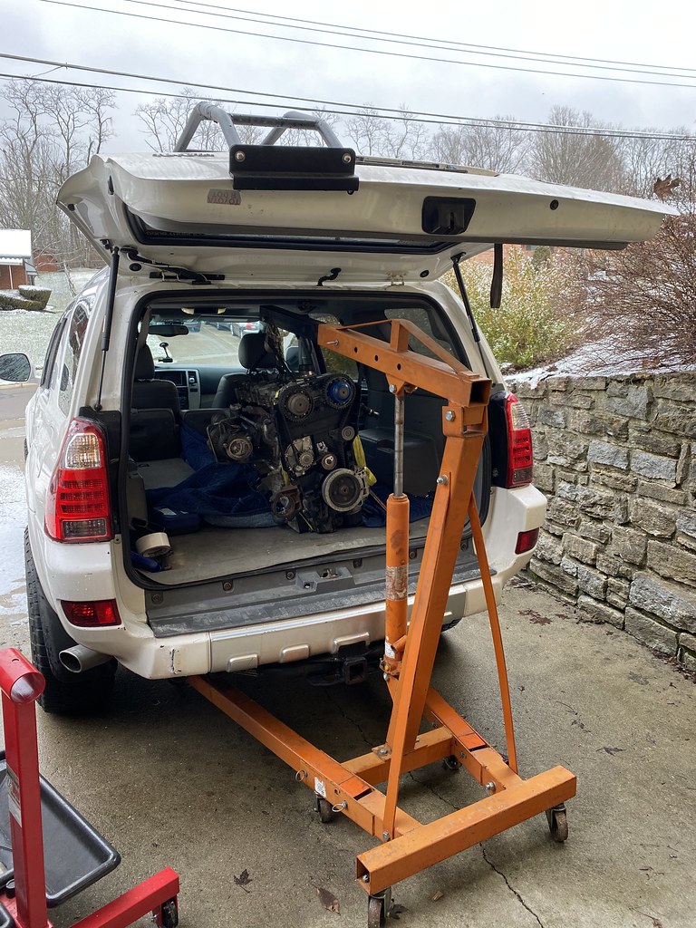

Had to move the engine for my S70 build from the old house to new.

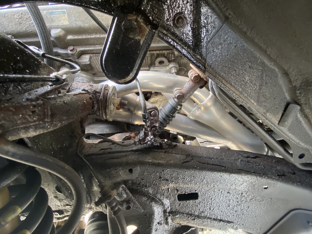

At this time, the 4Runner was doing okay, but a slight brake leak at the rear center soft lines was starting to drip a little more. I managed to move literally the last load of stuff from the old house and woke up the next morning to this.
Knowing I own a midwest truck with some minor rust issues, I will be going through and replacing all of the brake lines. I did the outermost soft lines last year when doing the brake calipers but now it's time to just tear it all apart and do all the hardlines and be done with it. I'm going to try to get it up on the new QuickJacks that just arrived yesterday in the garage this weekend to look over it and create a "shopping" list of all the things I need to replace all the brake lines. I already have the flaring tool and some fittings but will likely need more.
Any advice on replacing all of the brake lines is welcome from those who have done it! I'm sure there are some tips and tricks I do not know.
