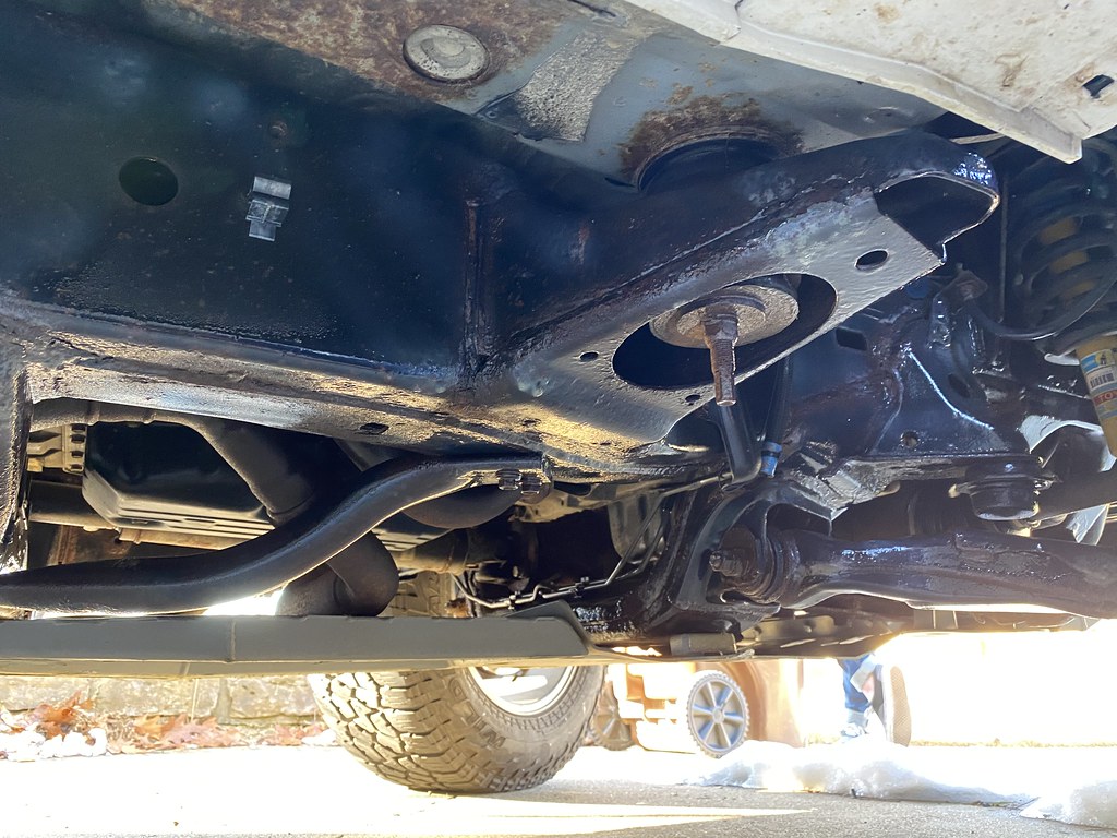

Sprayed on some Wool Wax to the frame (from the can) and also got the 5100's installed in the rear since one of the shocks was bent following the accident. They're definitely a bit stiffer than the 4600's that were in there, nothing to complain about yet. Still have to swap the rear sway bar since it was bent so is currently only connected on the passenger side.
Untitled by John Van Cleave, on Flickr
Frame doesn't look too bad for the midwest. The core of the frame is still solid, no rust through, but Wool wax is definitely a preventative for the time being with future more in depth wire wheel/repair work planned for the spring.

The lower core support is probably the worst rust area on the truck. Plan is to find a replacement and weld it in, or possibly just fab my own out of box steel and chop out the rotted part at the bottom.
