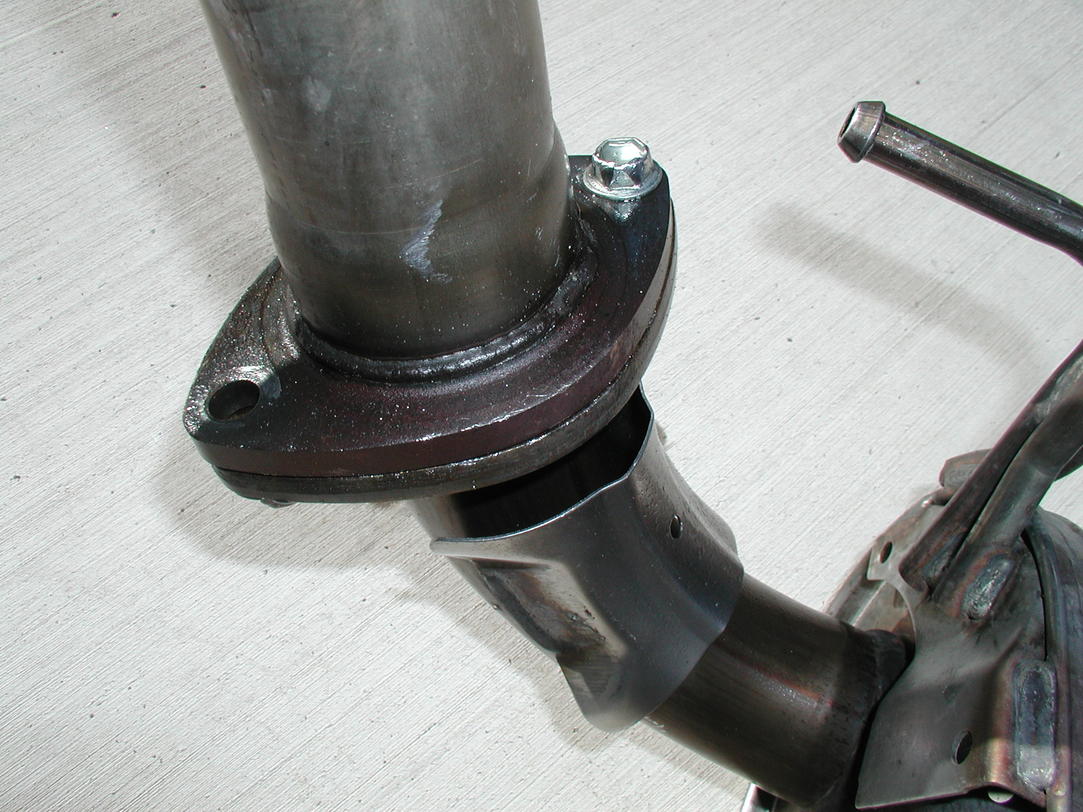

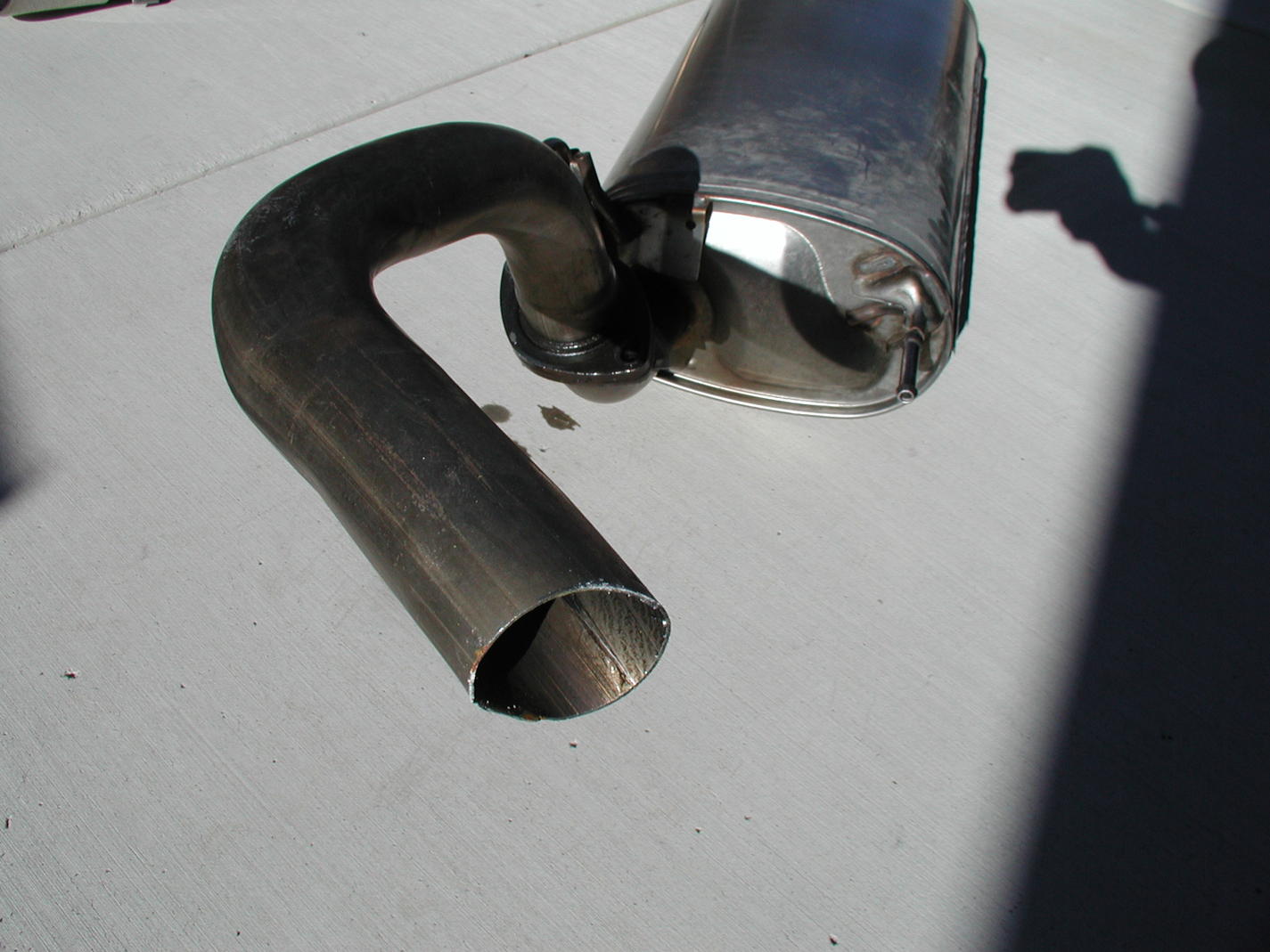

I put on the Borla. I had to cut the old pipe to remove it. It went on fine, but I had to change the slotting on the rear hanger to make it set properly at the exit point in the rear valence. I love the sound and it passed the “wife test.” No change at normal idle and at constant speed. It roars nicely when accelerating. Seems like it might be a tad quicker, but it certainly feels peppier when accelerating as it nears its peak in the curve. Either way, it’s loads more fun to drive (even in Drive). There’s some kind of rattling noise coming from underneath, most likely a vibrating heat shield. I’m working on isolating it and solving the problem with Borla’s help.

On 6'' lifts (could probably do it without lifts, if you're young and flexible...). Only cut because I stripped a bolt on the rear flange (see photo). It would come apart fine if both bolts came out...
