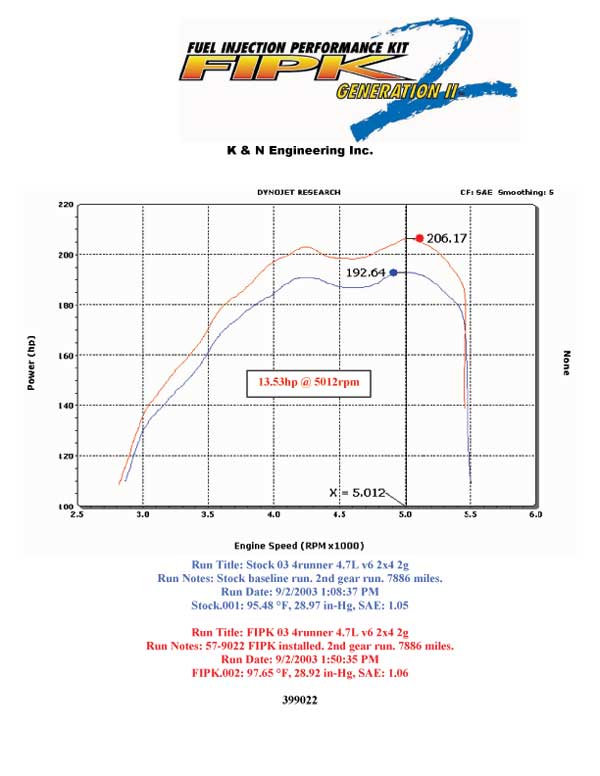

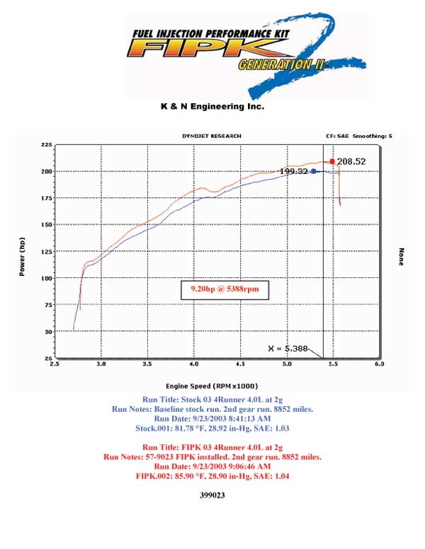

K&N Dyno Chart
Here is a Dyno Chart I got from K&Ns web site. I also got an email I posted on another thread about intakes that list the peak torque gain. I feel like my 4Runner pulls harder with the kit at higher RPM. But I also run Premium Fuel "93 Octane" all the time.
Here is the text of the email.
Hello,
Thank you for your interest in K&N products. We do not have any dyno graphs for these kits at this time. We do have the peak gains though.
57-9023 peaked 13.68Ft/lbs @3930 RPM. V-6 Kit
57-9022 peaked 14.41Ft/lbs @ 3626RPM. V-8 Kit
Thank you,
Leon S. Collins
K&N Technical Support
1-800-858-3333
