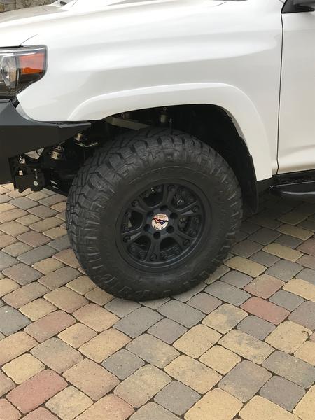

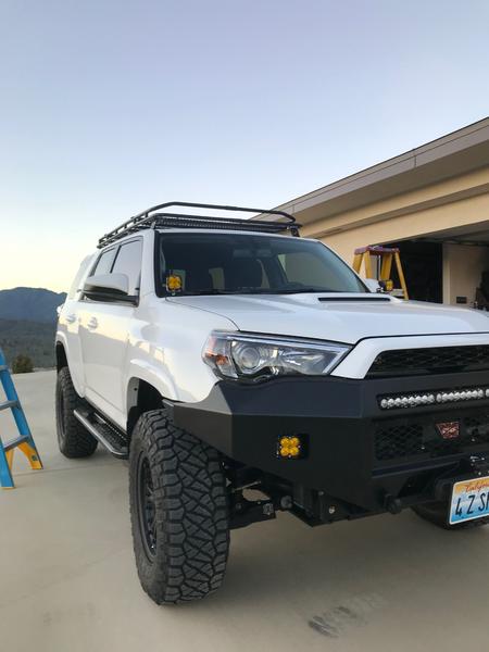

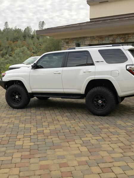

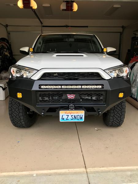

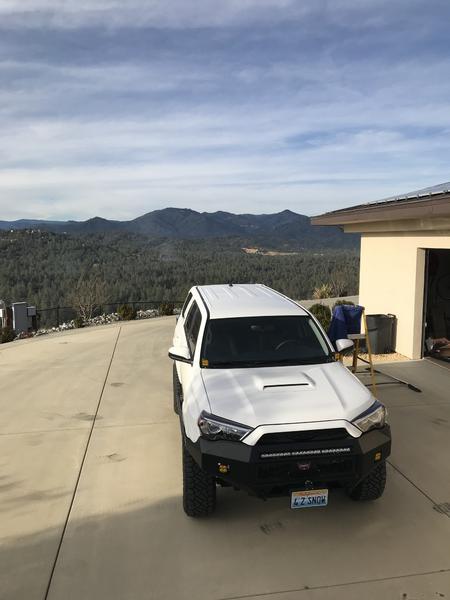

And here she is with new wheels (sorry for the bad pic - tough to get the wheel detail and side of the truck):
k9+haulr-albums-building++modifying+frosty++4runner-picture48792-new-hutchinson-wheels.jpg
k9+haulr-albums-building++modifying+frosty++4runner-picture48797-hutchinsons-finally-mounted.jpg
Wheels ended up being 1 nut short - a quick call to Hutchinson and they have a few being sent.
Also - was kind of pissed when I picked the truck up, as my TPM warning was lit on the dash. Darn - thought that was the point of cloning the OE TPMS. Then I remembered the stock wheels were in the back of the truck. Got it home and unloaded the stock wheels - took a drive and the light went out - must be throwing warnings due to the stock rims having the TPMS and no tire on them, and the truck picking up both sets of TPMS.
Time to sell off my TRD rims and stock Nitto 265's

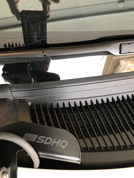

k9+haulr-albums-building++modifying+frosty++4runner-picture48816-amber-swapped-into-fog-position-added-sdhq-brackets-baja-squadron-pros-ditch-lights.jpg
k9+haulr-albums-building++modifying+frosty++4runner-picture48817-added-sdhq-brackets-baja-squadron-pros-ditch-lights.jpg
Routing went across the firewall - again adding a bit of abrasion/heat resistance and zip tied to other wires crossing the firewall. Added them to slot/switch #8 on the switch pro, but didn't use both hot leads since the lights don't need more than 15amps provided by just 1 of the hot legs. The other one remains taped off for now...maybe I'll think of something to tie it to. Then again, starting to question my theory about never having too much lighting - might be getting close once the roof rack, work lamp, rock lights, and back ups are added

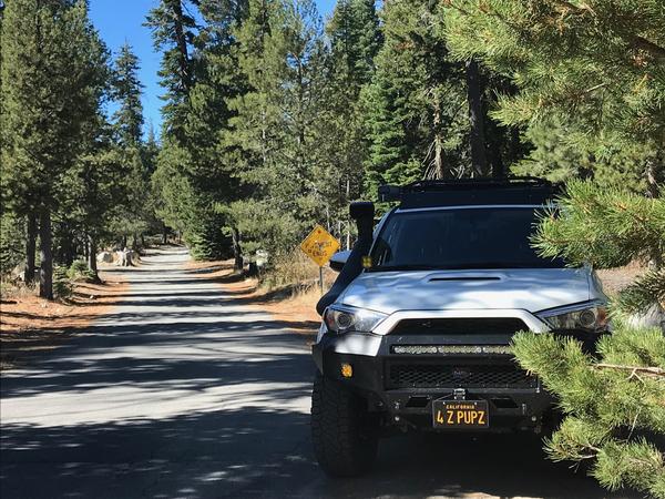

This past couple weeks have been pretty quiet - took the truck up to Tahoe, but didn't get any time to get out and explore much. Was pleasantly surprised with the amount of power Frosty seemed to have in comparison to my last trip up to elevation. No air conditioner makes a BIG difference.
k9+haulr-albums-trips++adventures++frosty++4runner-picture48900-dogs-up-mt-rose-check-out-snow.jpg

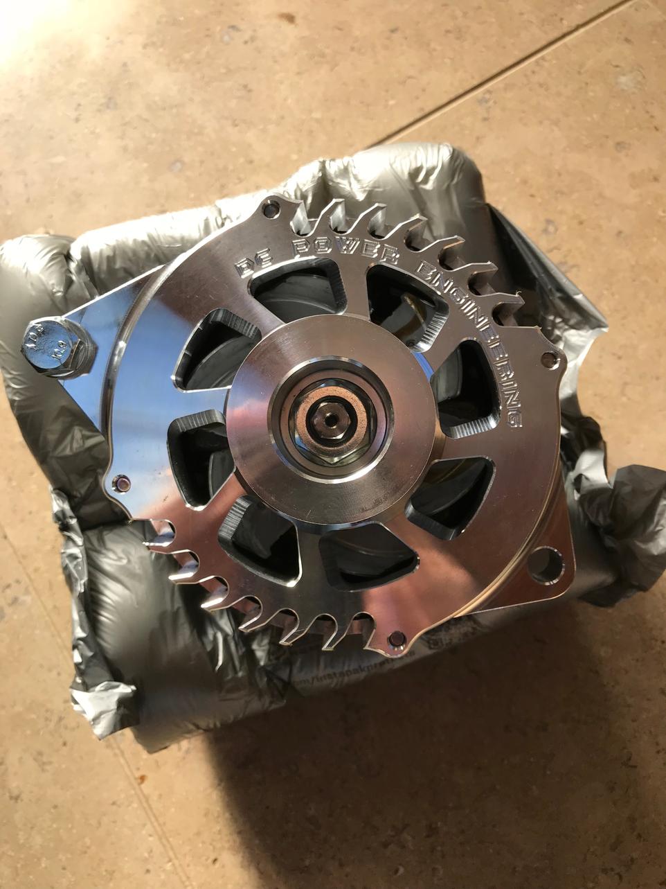

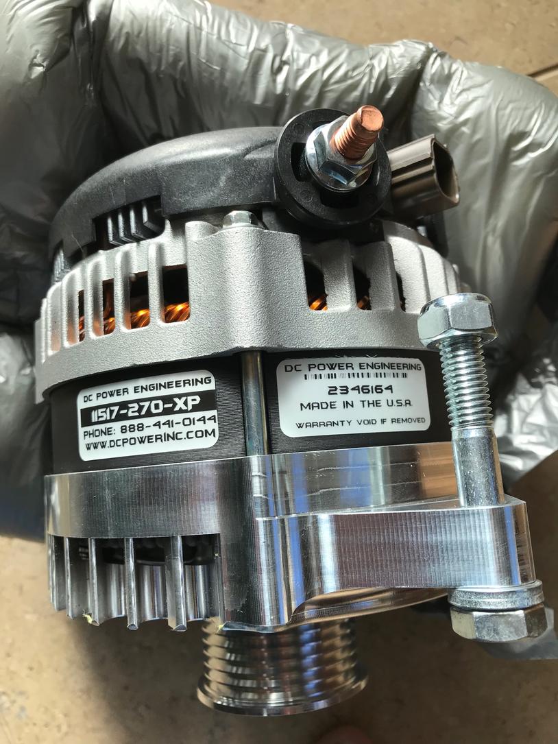

Got my new alternator from DC Power today...just need to decide if I'm installing or if I'll hand it over to a shop:

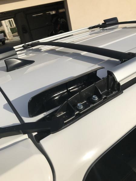

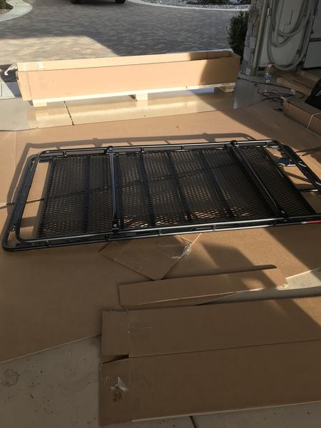

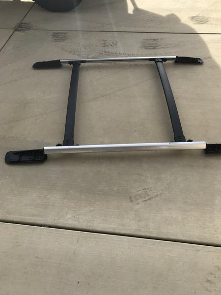

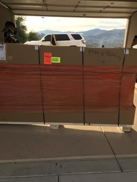

My Gobi rack arrived today...20 weeks to the day from when my order was processed. Since I knew the rack was coming today, I went ahead and removed the stock roof rack.
k9+haulr-albums-building++modifying+frosty++4runner-picture49082-removing-stock-roof-rack.jpg
k9+haulr-albums-building++modifying+frosty++4runner-picture49083-stock-rack-removed.jpg
The truck looked "bald" with nothing on the roof.

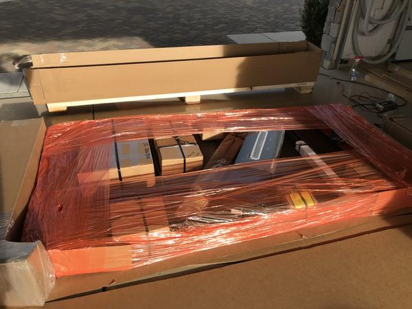

The delivery service was awesome - showing up with a powered palate jack and placed the package exactly where I asked.
k9+haulr-albums-building++modifying+frosty++4runner-picture49085-gobi-rack-arrived.jpg
Was extremely well packed - with all accessories strapped to the rack and cellophane wrapped to hold in place during shipping.

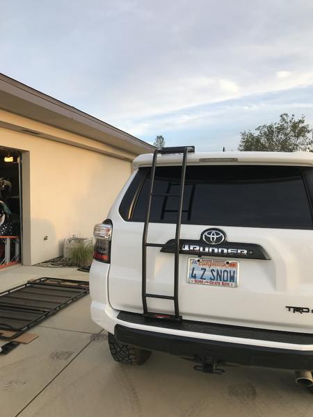

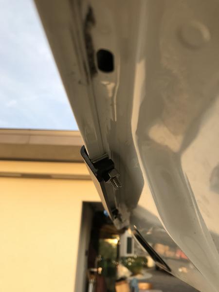

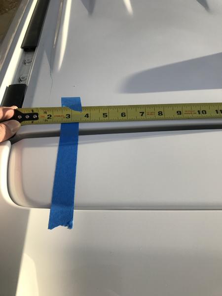

Once unboxed and unwrapped, I realized it was getting late in the afternoon and decided to only tackle the ladder. It went VERY smoothly - a quick measurement, some painters tape to mark and hold a bracket in place, and I was done. All told maybe an hour with BS time with my wife and carefully following the directions (a new concept for an Engineer).

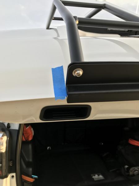

k9+haulr-albums-building++modifying+frosty++4runner-picture49078-marking-ladder-hanger-bracket.jpg
k9+haulr-albums-building++modifying+frosty++4runner-picture49080-lower-ladder-bracket.jpg
k9+haulr-albums-building++modifying+frosty++4runner-picture49079-lower-ladder-bracket.jpg
Love the look and can't wait for tomorrow to install the rack itself.
k9+haulr-albums-building++modifying+frosty++4runner-picture49081-gobi-ladder-installed.jpg

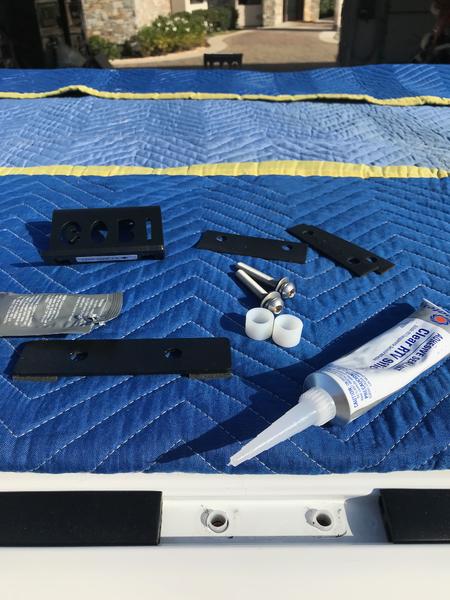

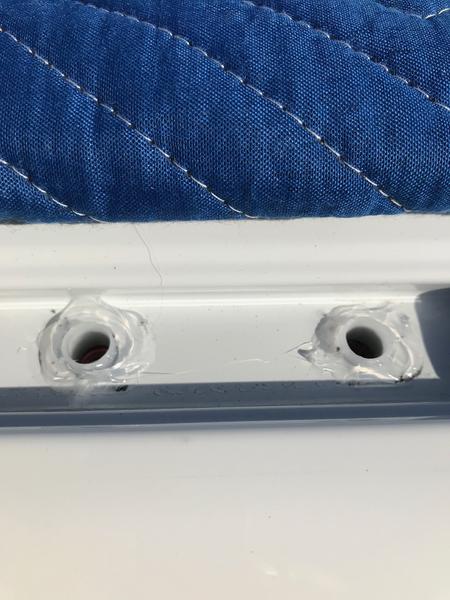

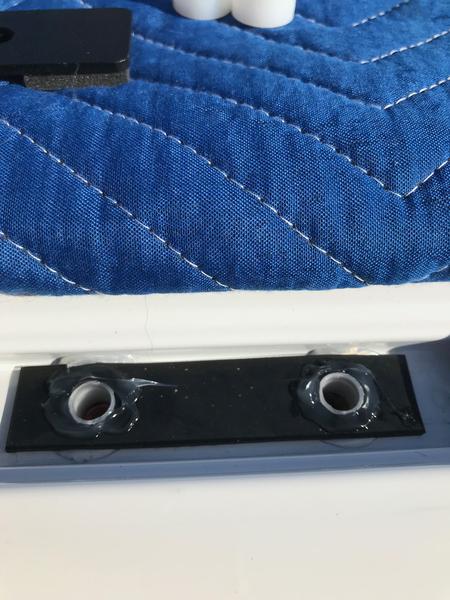

While I was VERY patient waiting the 20 weeks it took to get my Gobi rack, I showed absolutely none once the rack got here. Installed the ladder the first afternoon it came (arrived around 2:30, unboxed it, cleaned up the packing material and had the ladder on my 4:00) and then first thing the next day I got the rack going. The install was VERY straight forward – follow the directions and no real issues.

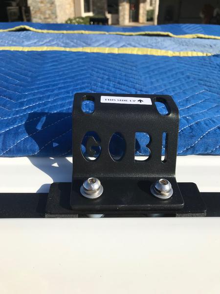

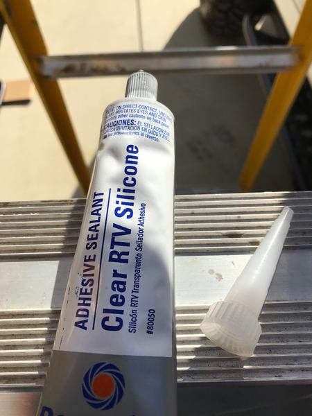

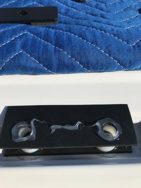

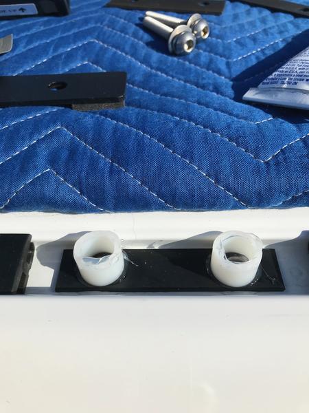

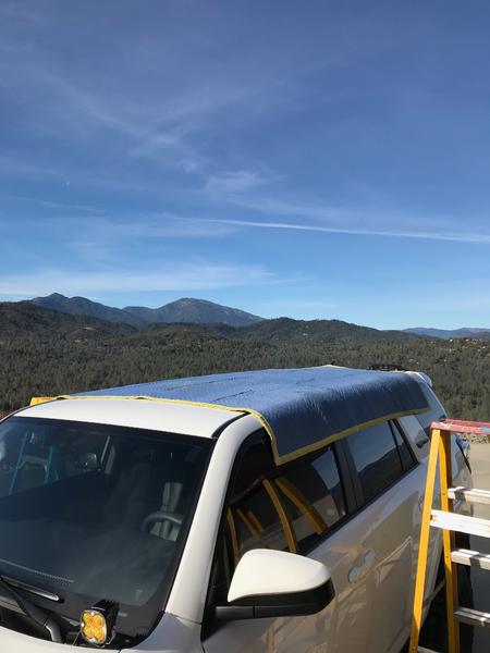

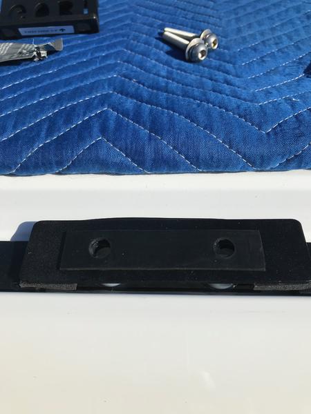

I started by placing a moving blanket on the roof of my 4Runner to protect the paint. As an added layer of leak prevention/water intrusion, I also used RTV clear silicone sealant around the factory plastic tubes, and then between each layer as I added the pieces that go beneath the rack supports. Once the rear and middle bases were installed, but left loose to allow for adjustment, it was time to place the rack itself up on the roof.
k9+haulr-albums-building++modifying+frosty++4runner-picture49118-blanket-protect-roof.jpg
k9+haulr-albums-building++modifying+frosty++4runner-picture49119-used-rtv-clear-added-leak-prevention.jpg
k9+haulr-albums-building++modifying+frosty++4runner-picture49120-first-layer-around-factory-tubes-before-rubber-strip-added.jpg
k9+haulr-albums-building++modifying+frosty++4runner-picture49125-final-pad-placed.jpg
k9+haulr-albums-building++modifying+frosty++4runner-picture49126-finally-base-installed.jpg

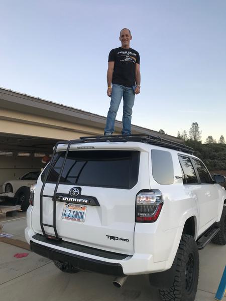

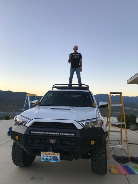

I started by wrapping the front feet in a wash cloth to protect the roof from untended scrapes. Honestly this could have been much easier if I was a bit closer to 6’ tall. However, I’m only 5’9” and my able bodied assistant/son-in-law only 5’6”, so lifting the rack high enough to clear the roof of my lifted truck was a challenge. We got the rack onto the bases and then I worked my way around the rack placing the bolts and nuts for the connection of the tower to the bases. Getting the nuts started on the middle towers was the hardest part due to lack of clearance between the rack the roof. I used a bit of tape on my wrench to hold the nut and reach under the rack.
Next was the front towers. Looks like Gobi has redesigned their front tower at some point, as I expected more 2x sided tape. Instead I found 2 rubber pieces covering the ends of the foot that rested perfectly on the rubber trim strip on the roof. Once I got the fronts under the rack, the rear bases “stood up” and everything started to settle into position. I used a cardboard box to act as a shim to get the rack height adjusted and then went back around the truck first fully tightening the bolts on the bases, followed by the connection of the rack to the bases.
k9+haulr-albums-building++modifying+frosty++4runner-picture49128-rack-ladder-installed.jpg
Probably about 2 hours to install the rack, with another half hour to run over to the store and grab a 3/8 nylock – had 1 that wasn’t the correct size. Not bad for the size of the parts bag included.
Mark that off the list of stuff to add to my truck. Love the look and functionality!

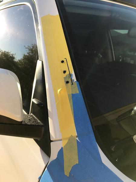

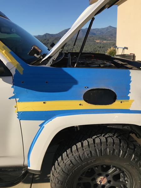

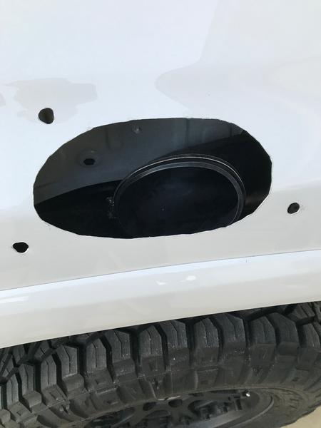

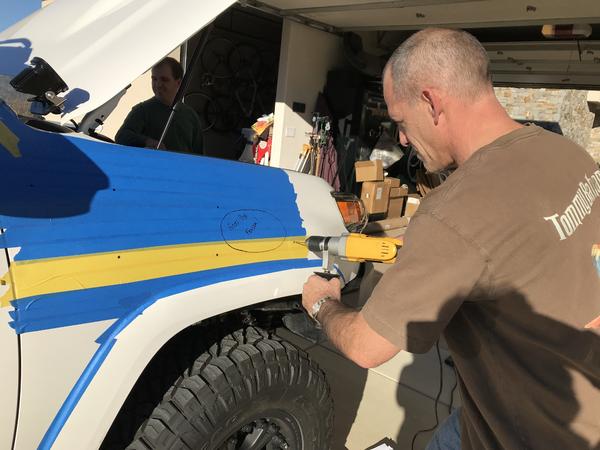

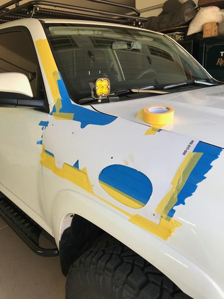

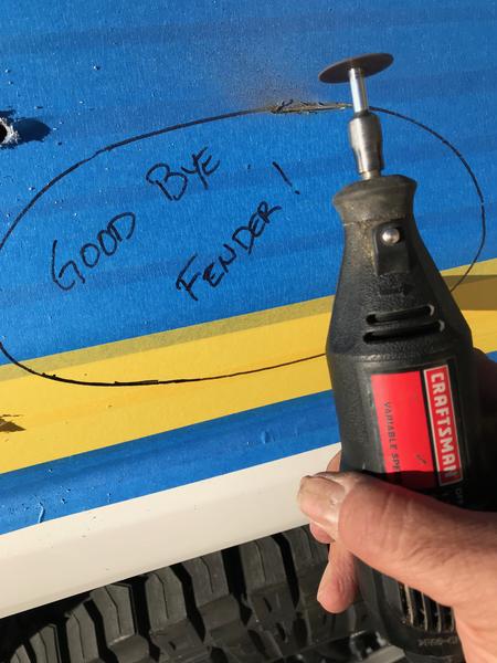

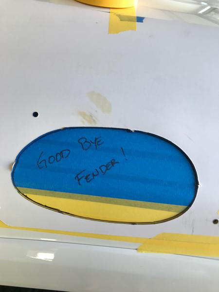

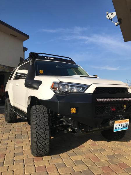

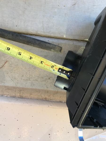

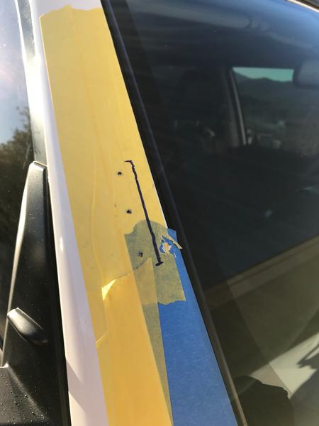

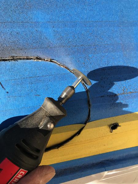

Like I said, since my Gobi rack was installed, might as well work on installing my snorkel too. Honestly, this was MUCH more stressful thinking about the process than actually doing the work.
I started out by taping the entire fender and much of the A-pillar with painters tape. Then carefully got the template positioned and marked out the various holes…with a bit of twisted humor added. The next step was removing the air box, which I had already done once when I relocated the air pump. Then came the fender liner. I had a heck of a time with the black plastic clips, but had already purchased replacements, so I had no problem destroying them during the removal process.
k9+haulr-albums-building++modifying+frosty++4runner-picture49140-little-humor-lighten-mood.jpg
At this point, I took a short break to relax a bit and also get my wife – she wanted to see any real “carnage.” Out came the drill and my dremel tool. I used several bits to gradually increase the size of the holes for the studs until I got to 3/8”. I had adequate clearance around the studs, so I stopped there. I used 3 of the reinforced 1 ¼” grinding wheels to cut the dreaded hole, being careful to hold the tool with both hands and go SLOWLY. A quick test fit, and it was apparent I needed a little more play in the holes (kept binding up on stud threads), so holes were enlarged to ½”. This is still 1/8” smaller than what the instructions call for, but I figured smaller was better when it came to holes in my truck.
k9+haulr-albums-building++modifying+frosty++4runner-picture49142-used-3-those-cutoff-wheels.jpg
k9+haulr-albums-building++modifying+frosty++4runner-picture49144-ok-most-drilling-cutting-done.jpg

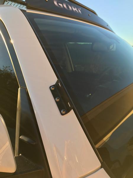

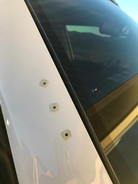

Next was the A-pillar bracket. This was MUCH easier than I was expecting. I mounted the bracket to the snorkel and mounted the snorkel in position. Then I marked the edge and top/bottom of the bracket on the tape I had on the A-pillar. Once marked, I took the snorkel off, removed the bracket and then used the marks to align the bracket on the A-pillar, so I could mark out the locations for the self-tapping screws. 3 more holes drilled, and it was time to remove the masking tape.
k9+haulr-albums-building++modifying+frosty++4runner-picture49145-test-fit-pillar-bracket-marking.jpg
k9+haulr-albums-building++modifying+frosty++4runner-picture49146-pillar-marked-bracket.jpg

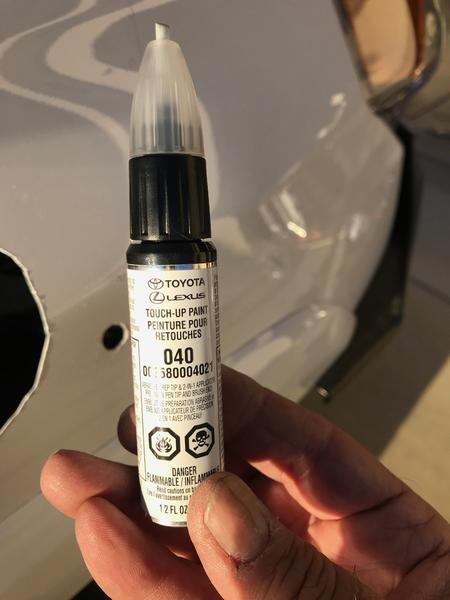

I switched the dremel to a cylindrical grinding stone to debur the edges of all of the holes, and then used some touch-up paint from Toyota to paint all of the exposed metal along the edges of the holes. For a bit of added protection, I applied some RTV clear to the holes before pushing the plastic inserts into position. Then the 3 self-tapping screws were added to hold the A-pillar bracket in place.
k9+haulr-albums-building++modifying+frosty++4runner-picture49148-super-white-touch-up.jpg
k9+haulr-albums-building++modifying+frosty++4runner-picture49150-plastic-inserts-w-little-rtv-added.jpg
k9+haulr-albums-building++modifying+frosty++4runner-picture49151-pillar-bracket-installed.jpg

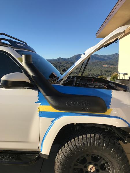

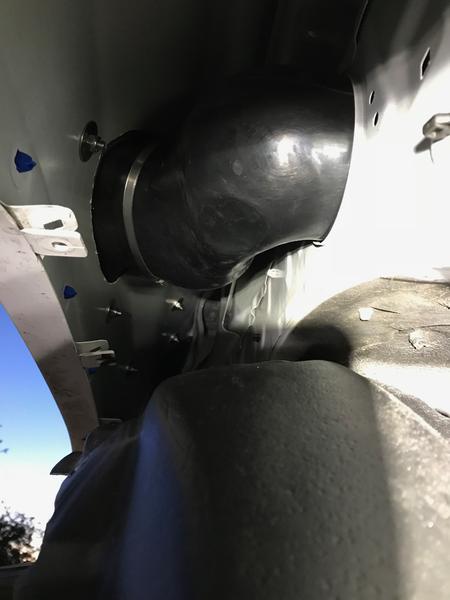

After the paint dried, the air intake hose goes in followed by re-installing the air box (remove the stock intake tube and about an inch of the rib on the box itself). Then the snorkel body goes on. I added some soapy water to the inside of the intake tube to help facilitate sliding onto the snorkel body. Nearing the end, I installed 6 nylock nuts and the body washers for the snorkel body and the 2 bolts that hold the snorkel to the A-pillar bracket. Last was the snorkel air ram and the 3 hose clamps to hold everything in place. REMINDER: don’t forget to retighten the hose clamp from the air box to the engine air intake.
k9+haulr-albums-building++modifying+frosty++4runner-picture49152-air-inlet-tube-installed.jpg
k9+haulr-albums-building++modifying+frosty++4runner-picture49149-removing-1-aligning-tab-air-box.jpg
k9+haulr-albums-building++modifying+frosty++4runner-picture49154-air-inlet-tube-wire-band-clamp-fender-washers-nylocks.jpg
k9+haulr-albums-building++modifying+frosty++4runner-picture49155-all-done-snorkel-install.jpg
Wrapped it up by reinstalling the fender liner and popping a beer. Another mod done ;-)

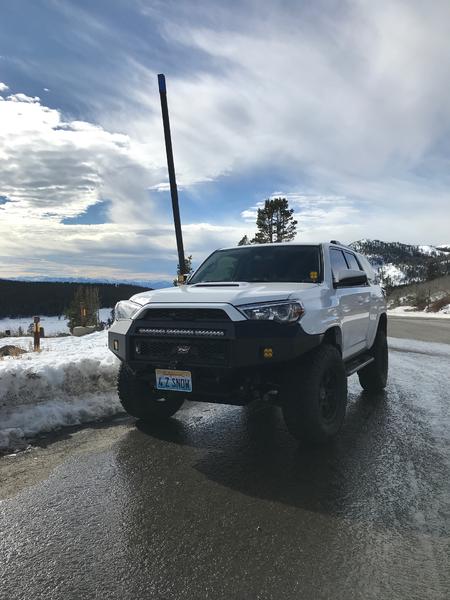

After spending quite a bit of time and effort to upgrade my '14 Raptor for snow capability, I switched my "4 Z SNOW" plate over to it and Frosty got something more applicable. Made sense since I use the Raptor for carpooling our local HS Alpine race team, and considering what I use my 4Runner for.
Wife got this shot as I headed to Tahoe on my most recent trip:

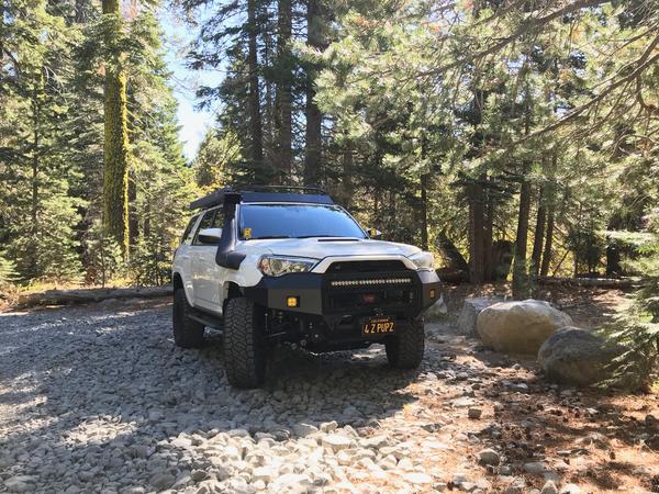

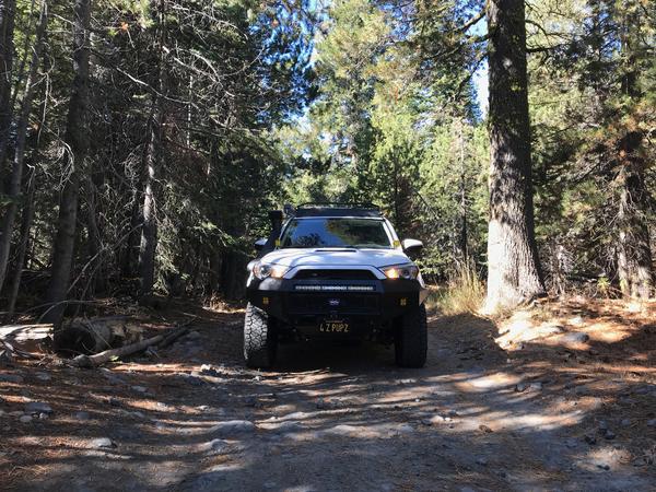

Took my wife up to the McKinney/Tahoma trail head and a little ways up the Rubicon Trail. She wasn't real happy with clearing rock-obstacles and turned around at the top of Cadillac Hill. At least I got Frosty introduced to the trail my FJ40 and FJ80 have spent many trips on...
k9+haulr-albums-trips++adventures++frosty++4runner-picture52922-frosty-rubicon-trail.jpg
k9+haulr-albums-trips++adventures++frosty++4runner-picture52923-pict-didint-happen.jpg
k9+haulr-albums-trips++adventures++frosty++4runner-picture52924-frosty-back-pavement-leaving-rubicon.jpg
