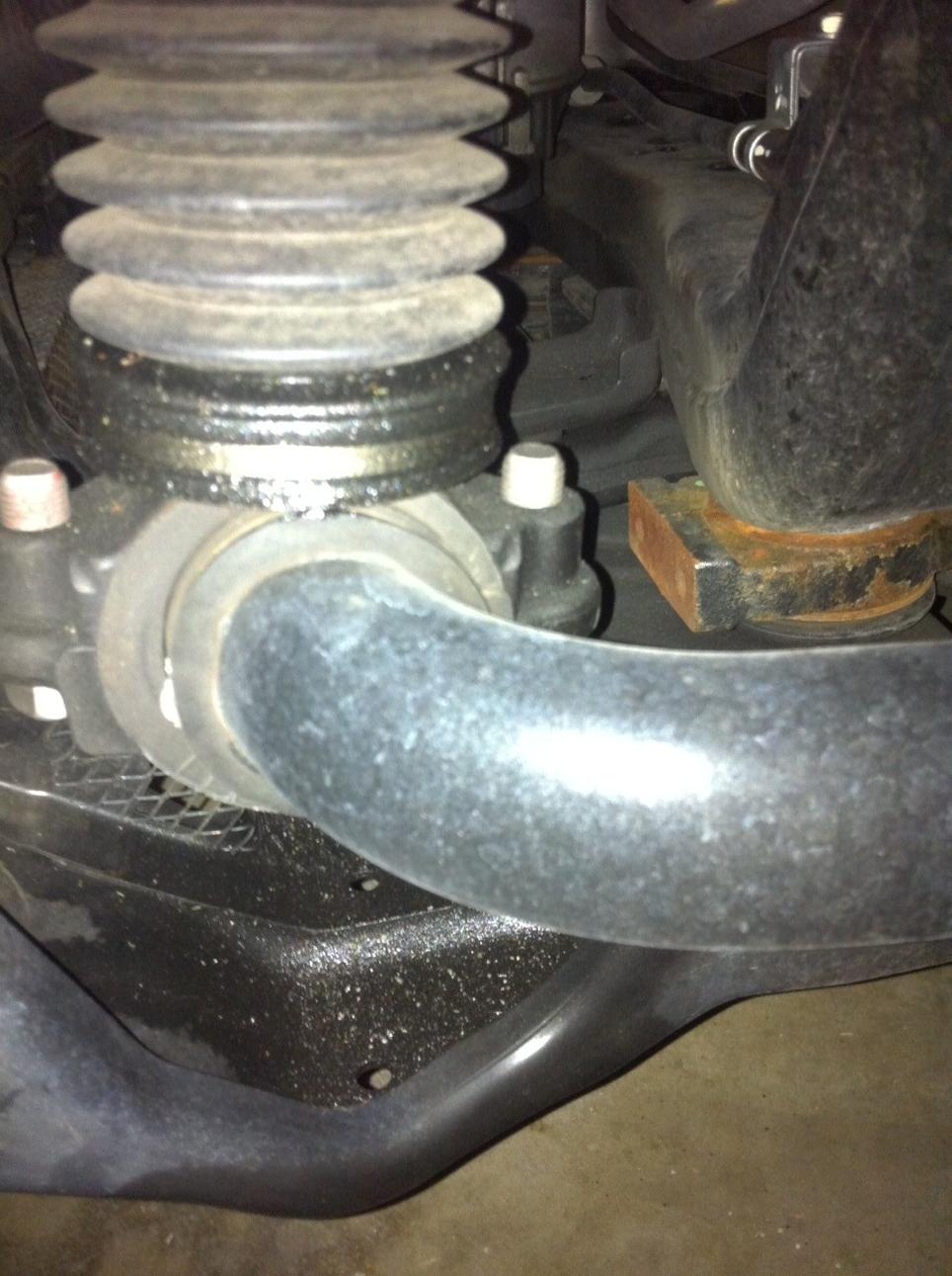

I have a 2010 Trail KDSS with 21K miles. The front cylinder is leaking hydraulic fluid. Does anyone know what is involved in the repair?

It won't be a repair if the actual unit is leaking it will be a replace. Like ATL4R said take it to a dealer who has experience in these repairs because this is uncommon and requires specific tools and training. Basically in this unit you have nitrogen gas precharged to a specific pressure on one side and hydraulic fluid on the other side.

Took it back to the Toyota dealer I bought it from. They have the KDSS pump and ordered parts. Covered under warranty of course. I'm also getting the drive shaft TSB and Headlight TSB. Parts are back ordered.
They had a look at my front KDSS cylinder today too. The service advisor stated that he was told that unless there is a noticeable "drip" as opposed to seepage his supervisor won't sign off on the warranty repair.

Parts came in, front KDSS cylinder was replaced along with Drive Shaft TSB, Headlight TSB, and last free oil change. Found out every dealer has the KDSS pump automatically shipped to them.

According to Toyota its normal for parts like shocks and such to "sweat a little" for the previous generation Camrys there is a campaign that dictates how much "Sweating" is too much and requires replacement (usually past the spring perch if anyone cares...)
I personally agree with you, its a gas charged system; if fluid is getting out, so is the gas charge and it needs to be dealt with.
In regards to the KDSS, if its leaking at all noticably have it taken care of. If the Dealer doesn't want to do the work, take it up with Toyota Customer Support.
As for the person asking about what a regular shop would charge to do the repair, more than likely they won't touch the system at all. Many 4th gen guys have issues with shops just trying to get their XREAS system repaired or more often than not removed. They also will most likely lack the proper Special Service Tools to perform the repair and will advise to take it to a dealership (hopefully before the screw it up).
