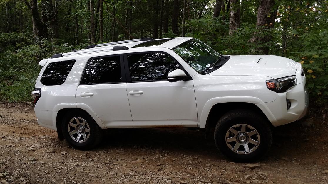

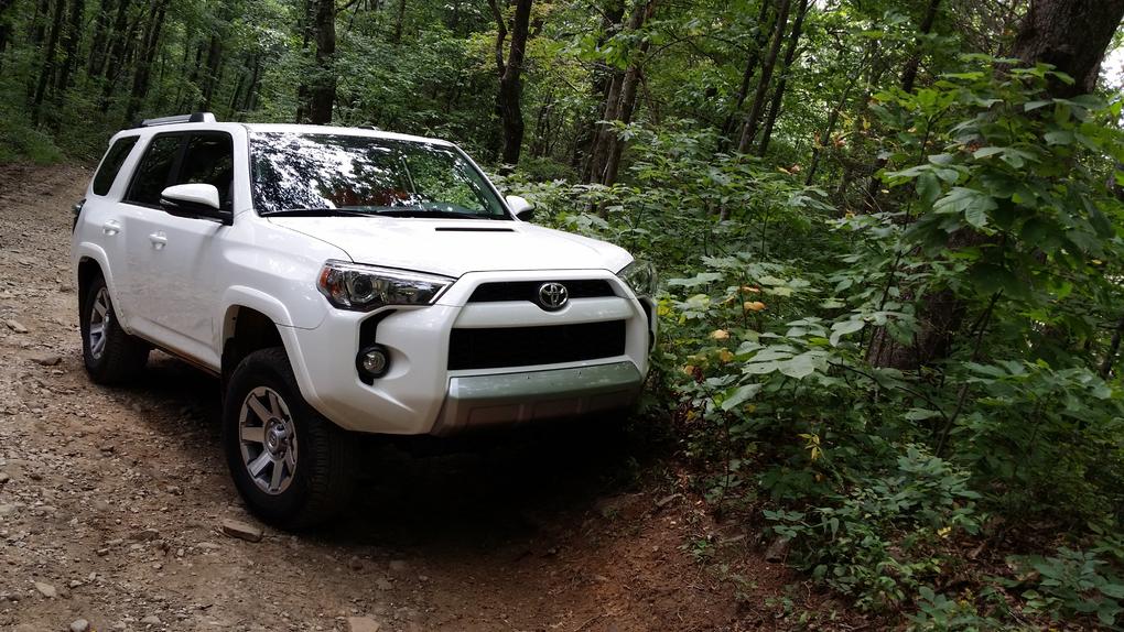

Guys, thanks a ton for all your help. Found a killer deal on a 2014 Super White Trail Premium with KDSS, and snatched it up.
After all the debate, I think everyone is was spot on. I love the KDSS, and in the stock ride it really adds a lot, but for the right price I could have definitely lived without it.
Pics so the thread isn't worthless. It's not much, but I wanted to take it off road immediately and putz around a bit. :laser:
