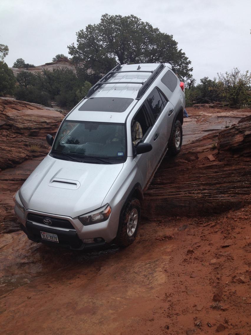

Over 100,000 miles on my lifted KDSS 2011 and zero issues with it. Oh, and numerous Colorado passes, back roads, and east coast trails thrown in.
