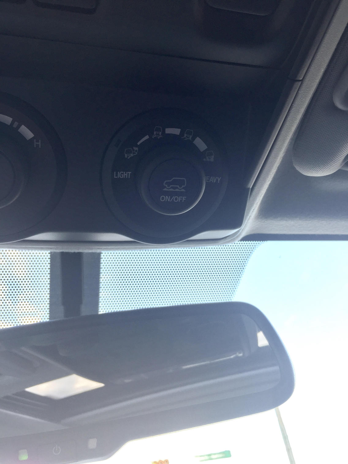

I have a '14 Trail Edition I'm about to purchase a lift for. I was always under the impression it had KDSS suspension. Then I started searching the forums and found that not all TE actually come with KDSS. So I looked under the rear driver side tire and did not see what appeared to be the kdss systems. I also checked under the driver side door along the frame and did not see the KDSS pump and lines as was mentioned in another thread. Nor do I have a KDSS light on my gauge cluster that lights up when the key is turned.
So it appears as if I do not in fact have KDSS, which leads me to my question, if I don't have KDSS, then what are these controls up near my reading lamps for? I thought that was for KDSS settings. See attached photo.

Those are crawl control settings. KDSS cannot be turned on or off.

Honestly, I didn't even know what it was when I was buying the vehicle lol. I just really liked my friends TE. I'm still not even sure what it does lol. From what I've read it sounds like a replacement to sway bars that can adjust on the go. I just want to make sure I order the right lift since there is one for KDSS and one for without KDSS.

I don't have a picture, but there is a quick check. Park, and turn all the way to the left so you can see in front of the front tire. Look at the stabilizer bar.
If it's really thick, attached directly to the lower control arm, and there's a rubber boot between it and the frame then KDSS.
If thinner (~1"), connected with a link to the steering knuckle, and mounted directly to the frame, then not KDSS.
