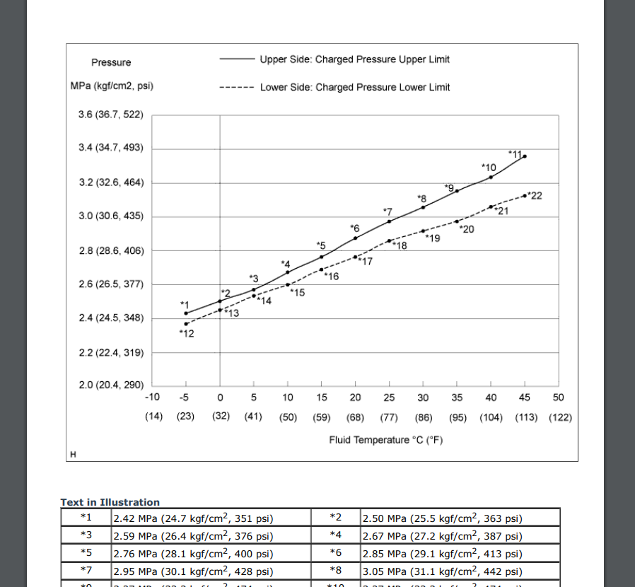

Im stuck on the instructions. Am I reading this right?
Bleed all parts to 1015psi.
Then back down the pressure based on this fluid temp chart (attached), 415-420psi?

Yes, that's what I have done the two times I've bled the system.
