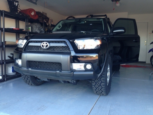

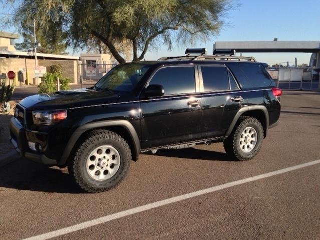

Here are some pics of the Duratrac 285/70/17's on stock rims and stock height on the TE. Billstein 5100 installation next week.
So far only a tiny amount of rubbing on the Mud Flap (I did the front fender Mod). My plan is to have them add some caster when they do the alignment after installing the 5100's
So, we're waiting for the after photos!
