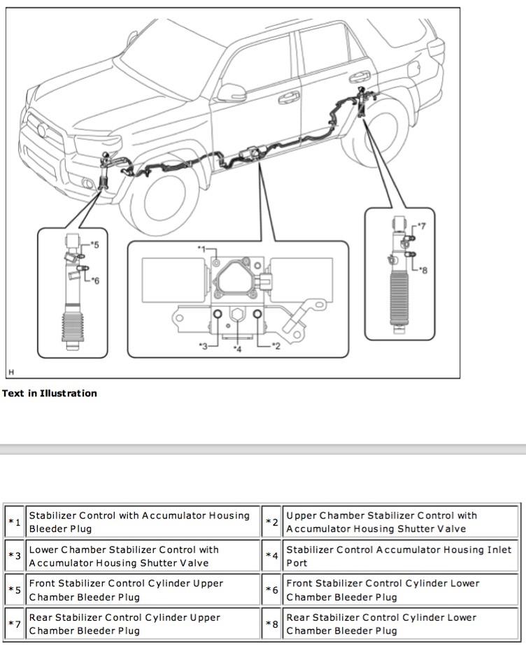

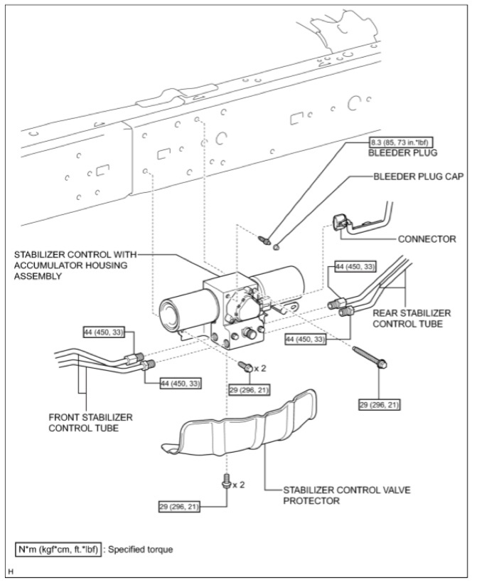

have you taken a look at it yourself yet? it's easy to do: just two 12mm bolts to remove the skid and get your own eyes on it.
the wiring connector fastens to the KDSS Stabilizer Control with Accumulator Housing Assembly at its center, on the opposite side of the bleeder plug (see diagram below).
no, you don't have to remove the accumulator. i would definitely do a reality check on the dealer's assessment.

so if it's really only corroded electrical contacts in the harness or connector—and not the control/accumulator itself (pressure sensor or ECU)—i would take my time and clean the whole assembly up with a wire brush, a nylon bristle brush, and some firm enough to be effective (but gentle enough not to break anything) effort. don't go at it hard, pick away at it—patience!
then, depending on the connectors' state, i'd clean them up as best i could and hit the electrical contacts with WD40 or electrical contact cleaner of your choice. let dry completely; clean up; repeat.
you'll likely know if you've made enough of an improvement to have any positive effect based solely upon how they look post-cleaning. living on the Maine seacoast, it's easy for me to imagine what this mess looks like at the moment. this is the reality of the "Salt Life" :ohwell:
with luck, you should be able to plug it back in, have the dealer clear the DTC Code, and see what happens. if you have a ScanGauge or copy of TIS TechStream and cable you could do this part yourself too.
you could also have the dealer try to clean it up as per [MENTION=66316]1engineer[/MENTION]'s recommendation but, as he advised, definitely don't let them mess with the hydraulic fluid's tubing connections!! then you'll truly be looking at the whole-hog repair.

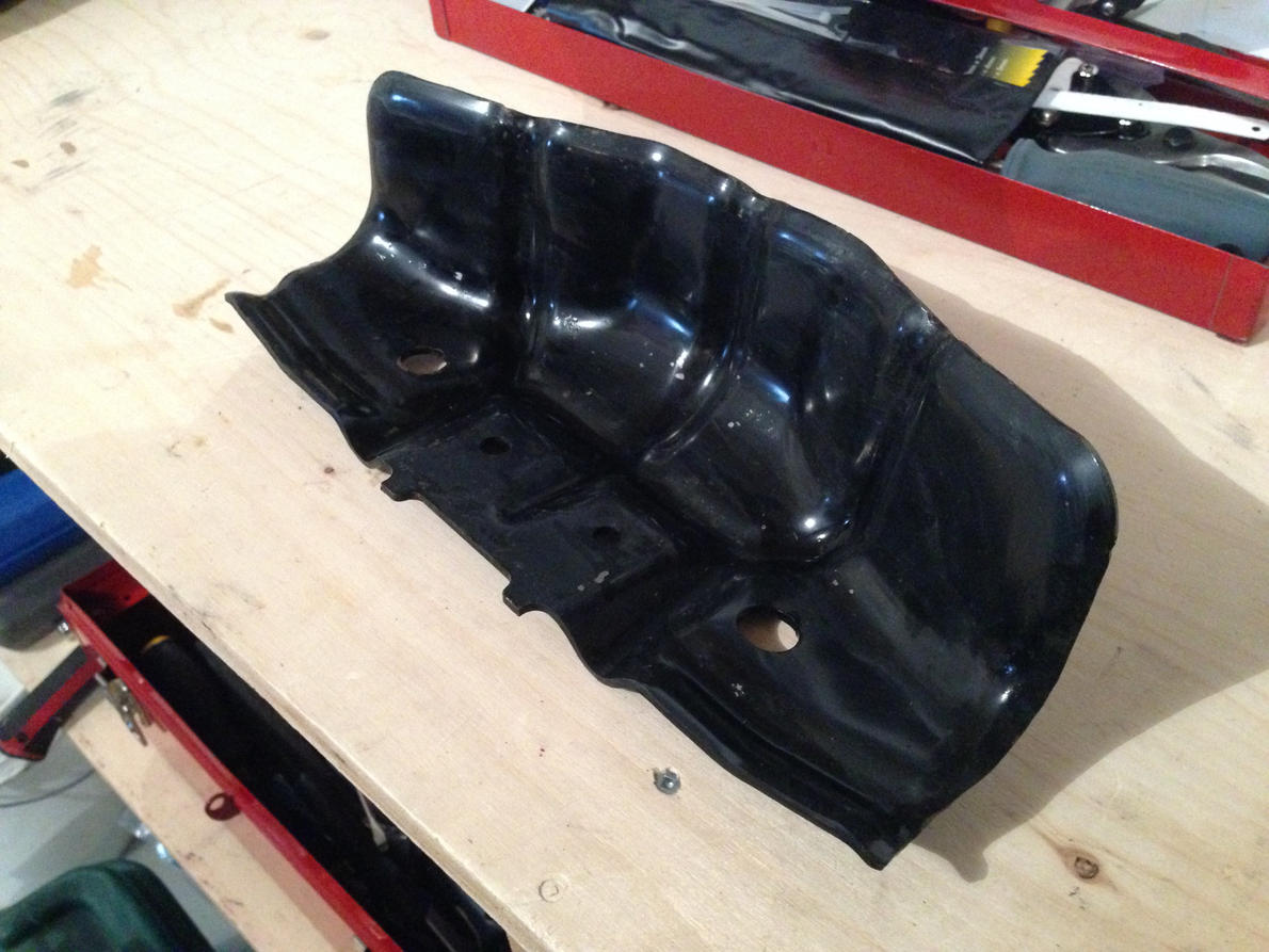

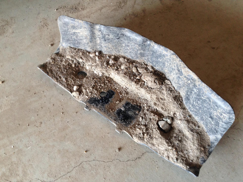

After going through this thread I took off my KDSS skid plate and found it packed with dirt and rocks. There was also a bunch of mud on top of the lines and accumulator assembly. I spent about 15 minutes with a shop vac, a brass bristle brush and a few small picks and managed to get everything cleaned up. I then coated it all with some Fluid Film to prevent any further corrosion.
One thing of note, the main body of the accumulator assembly is aluminum, unlike on the LC200 where it is steel. So while the assembly itself won't rust, there was definitely some galvanic corrosion going on where the steel bolts and bleeder valve thread in to the aluminum body.

Yes, yes it does (see below).
nice! that actually looks quite decent to me.
salt on the roads is bad enough, but living in a marine environment 24/7/365 exacerbates/accelerates the corrosion something awful; salt literally in the air, every day of the year.
i'd be curious to know if any of this is what inspired the differences in control/accumulator assembly design between the LC 200 and the Prado 150 lines.
As far as opening the shutter valves go.. to perform the tilt cabibration.. Here is the trick. Read the instructions and note how they measure the distance for opening the shutter valves. They specify 10-12mm, but they measure that from the outer most surface of the bolt to the mounting flange. I've never seen such confusing instructions before and it is the sole reason everyone screws it up. Besides those poorly written instructions it is super simple and easy to do.
I despise working on a truck with KDSS. Really don't like the way it is designed.
I never realized the 4Runner was different than the LC200 in this regard. It does sound confusing and extermely easy to accidently open up the system if simply exercising these valves to ensure they don't seize...10-12 mm is like 3/8"-1/2".... maybe it's not such a good idea on the 4runner and it's better to just lather them up with some protectant grease or fluid film and leave them shut?
