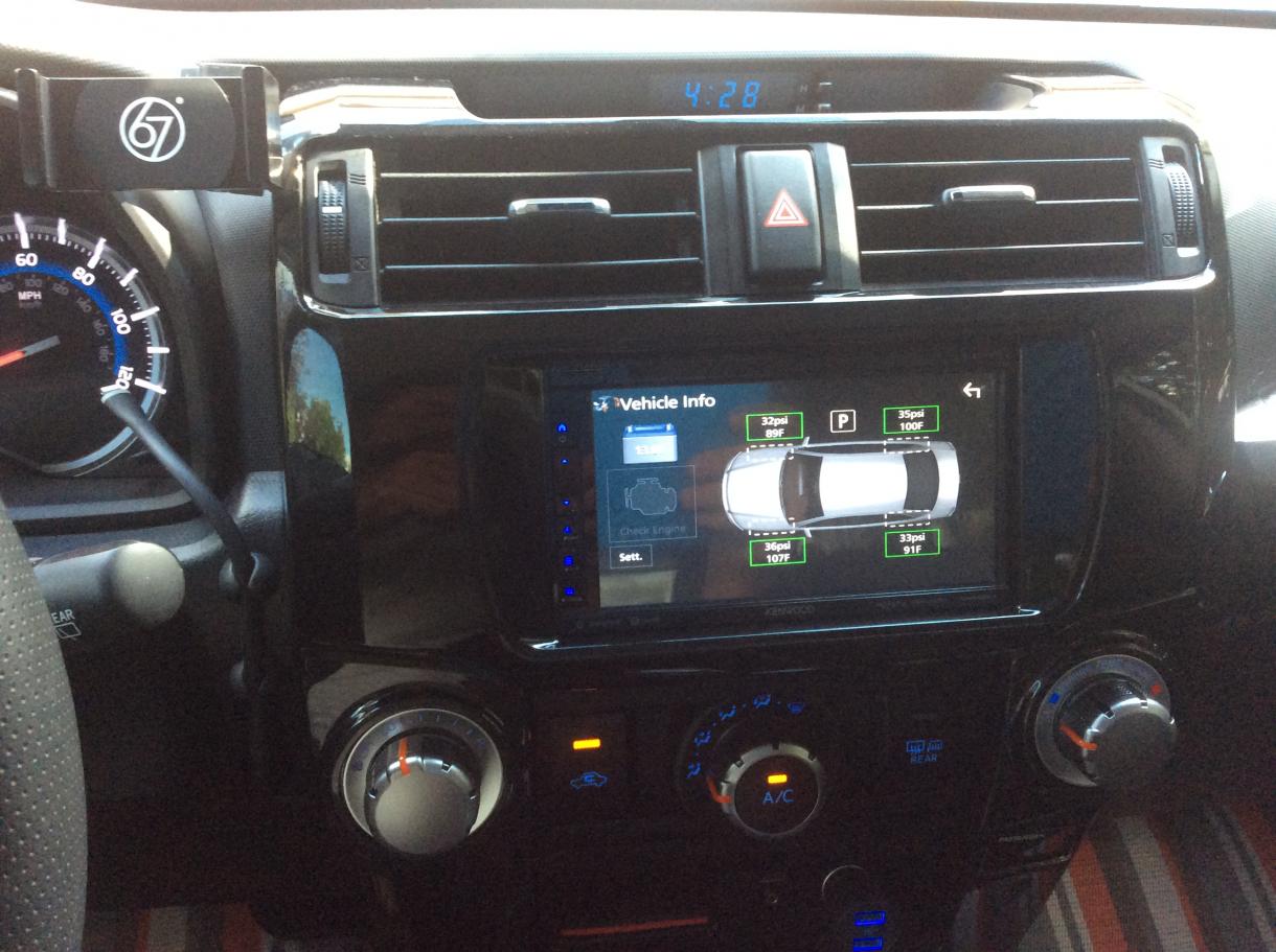

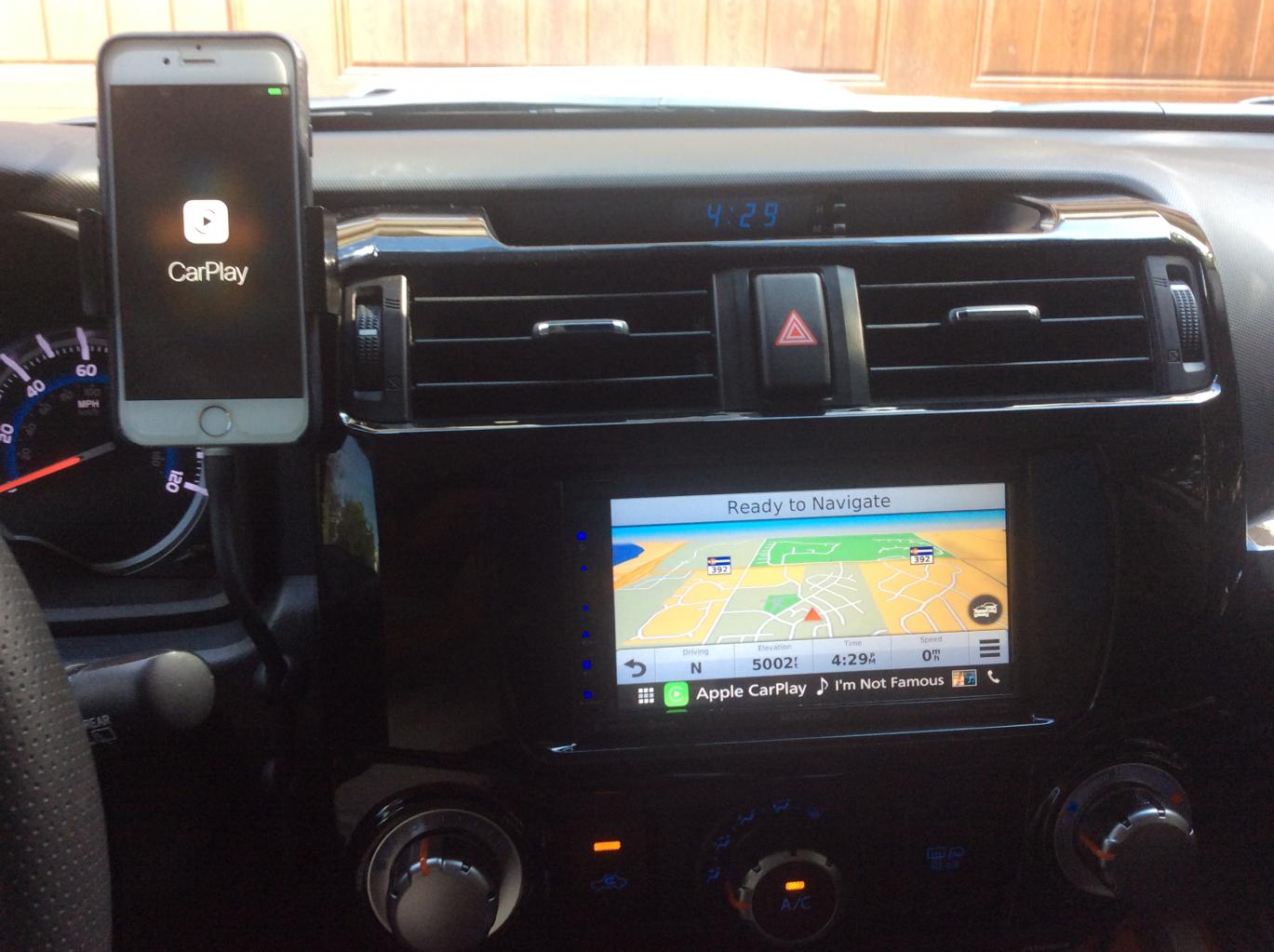

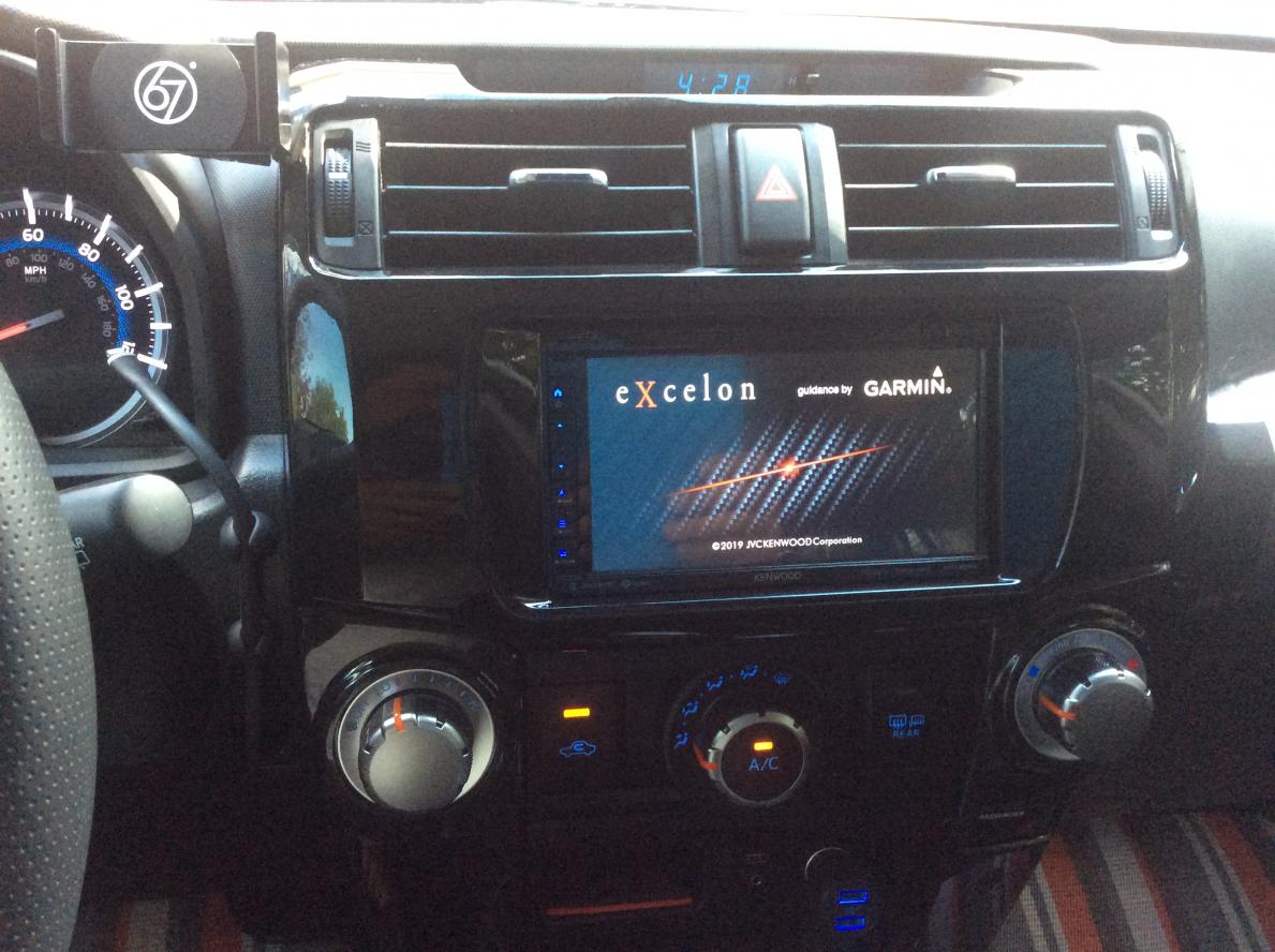

I installed a Kenwood Echelon with iData Link this summer and love it.
Crutchfield does have and adapter kit for the factory GPS and satellite antennas. They didn’t know until I told them they had it. Ug. So the only thing you need to deal with is the mic. I installed mine behind the rear view mirror, works great and out of sight
Bought USB plugs that snap into Toyota factory switch locations. Replaced the factory one in the center console and the blank right below the ignition for the Apple Car Play, phone mount right above it (very convenient)
MUCH better nav and maps
Easier updates to maps, no dealer required
Apple car play
Bigger better screen
Dynamic backup lines that are adjustable
TPMS pressure for each tire!
Passenger can enter a address while moving
Really so much better in every way
