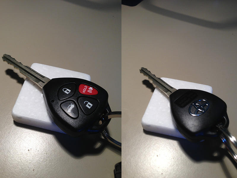

Lately I have been thinking about replacing the remote with a all-in-one key/remote combo unit like the later Toyota models. I browsed through several eBay listings and found one that "might" work and was relatively reasonable priced....
purchased last Wednesday and received this morning...
Got the remote portion programmed successfully on the 2nd try and spent $2 to get the key cut... programmed the transponder key... and everything seem to work quite nicely except the red "panic" button, which I don't use for the past 9 years..
Here's the link to the item over at eBay:
New Toyota 4Runner Sequoia Keyless Entry Key Remote Fob Combo Uncut 4 Button | eBay
I am not affiliate with the seller and nor does I benefit from posting the link here.
I hope this is related to the discussion here and it helps someone looking for a replacement remote or key/remote combo.

Can there be multiple CopperX keys used (programmed one at a time)?
I guess in other words can there be two remotes programmed or does the truck only support one?
I think you can program at least 2 because after I programmed the new key, the other remote still works.
