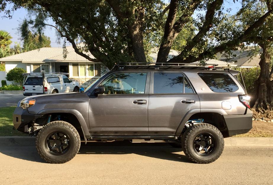

Your rig looks great! I’m looking to get some new tires, and the Ridge Grapplers are on my short list. How many miles do you have on them, and how have they worn? I’ve heard nothing but good things about their performance, but it’s divided opinion on wear.

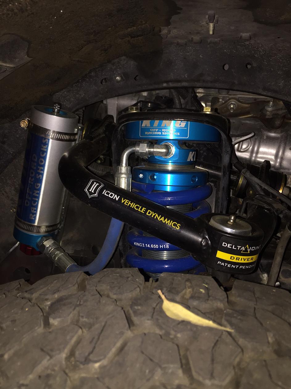

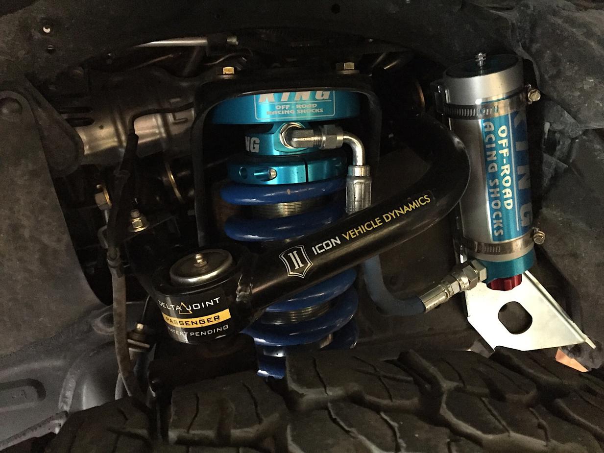

Here’s some measurements I took today, measured from the ground to the bottom of the fender.
I think its important to include spring rate front and rear, tire size and pressure (or height as installed on the vehicle), just to provide some context.
BFG KO2 275/75-17 - tire height measured on vehicle - 31-1/4” tall
Preload on passenger side: 2.5 threads
Preload on drivers side: 0
Front coilover spring rate: 650
Rear spring rate: 315
Passenger front:
37-3/4” @ 230bar approx. 32psi
Driver side front:
37-1/4” @ 230bar approx. 32psi
Passenger rear: 39-5/8” @ 240bar approx. 35psi
Driver rear: 39-1/4” @ 240bar approx. 35psi

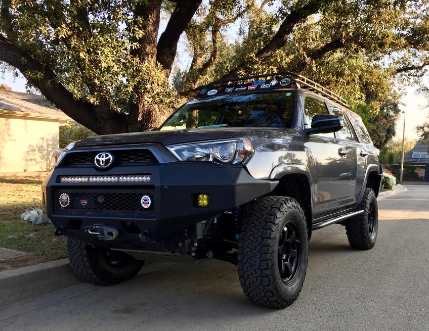

Truck looks fantastic. How does it ride?? I went with the King and have a front SSO slimline bumper and Winch, RCI sliders and Skids. The folks I ordered from didn't think I needed higher spring rates. They are 550. I had to crank major preload in, like 12+ threads, and still its got major rake. I get crazy nose dive, worse than my TRD set up.
IO have the 650 springs and I'm putting them on this eve.
I have a full aluminum bumper, winch, and skids, and 650 seems just perfect to me. I had 600s before and was still sagging/adding preload and nose diving. So you should be very happy with 650s. 12 threads of preload seems like a lot to me. You’ll probably ride a lot smoother when you can take it down.
I was thrilled to not have to add any preload to the passenger side, and just a bit (but still need 2.5 turns more) on the drivers side. It rides much much better than before. I need a bit of rake due to heavy loads during camping so I can level out on the trail, but I don’t really notice the rake at all as a DD.
The one thing I DID notice is that my tires look so small now, lol!! Just waiting for a good sale to pick up some 285/75s and fill out that wheel well!
