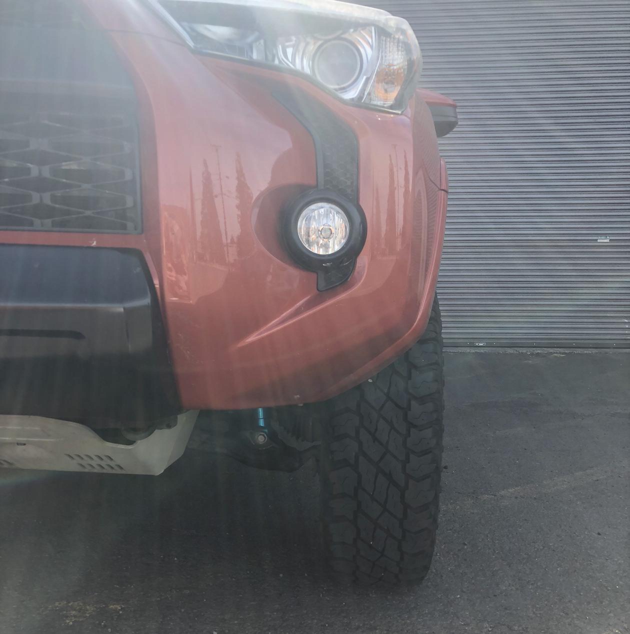

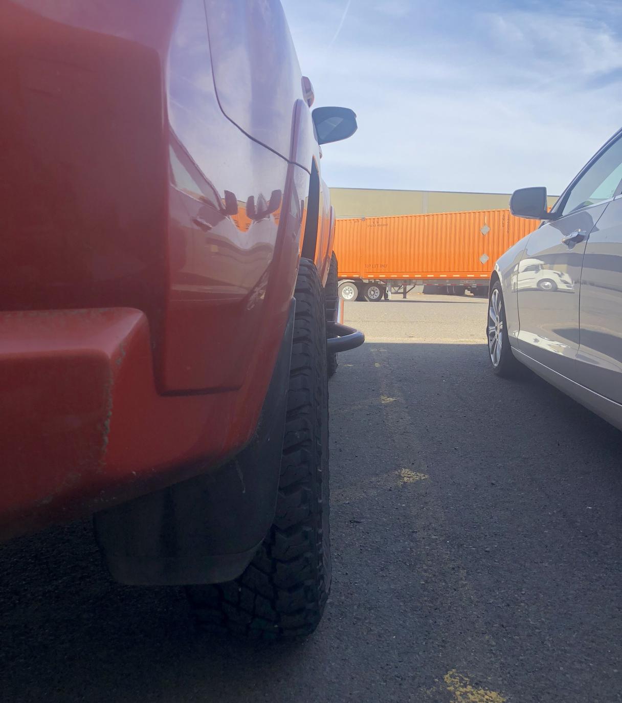

I love the tire size, but you're right they do look a bit sucked in with a lift. I have spidertrax so mine sit right about flush with the fender. If I get a chance later I can update this with a picture from the front to give you an idea, if you're not opposed to spacers it might be a good option for you. On another side note, I've just started to notice some of the outside lugs chunking off after 30k miles and about two years... I expected these to last quite a bit longer but I have been pretty rough on them.
[MENTION=208941]ChrisJHarney[/MENTION]; added pics here, couldn’t send attachment in PM
No problem!
I think any tire is going to chunk after some serious wheeling in the rocks, regardless the size, I have some good size pieces missing myself.
I’m not necessarily opposed to spacers. It’s just unfortunate that I can’t find a decent 17” wheel with the backspacing I want to push the tire out without moving up to an 8”-9” width. IMO, that’s way too wide for a 255, it’ll just get thrashed.
Yes please either post a pic or PM me a pick of your rig (so we aren’t thread jacking) head on so I can see the tires flush with the wheel wells.
