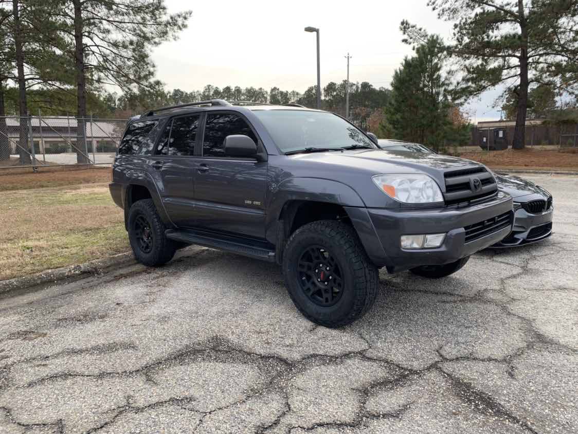

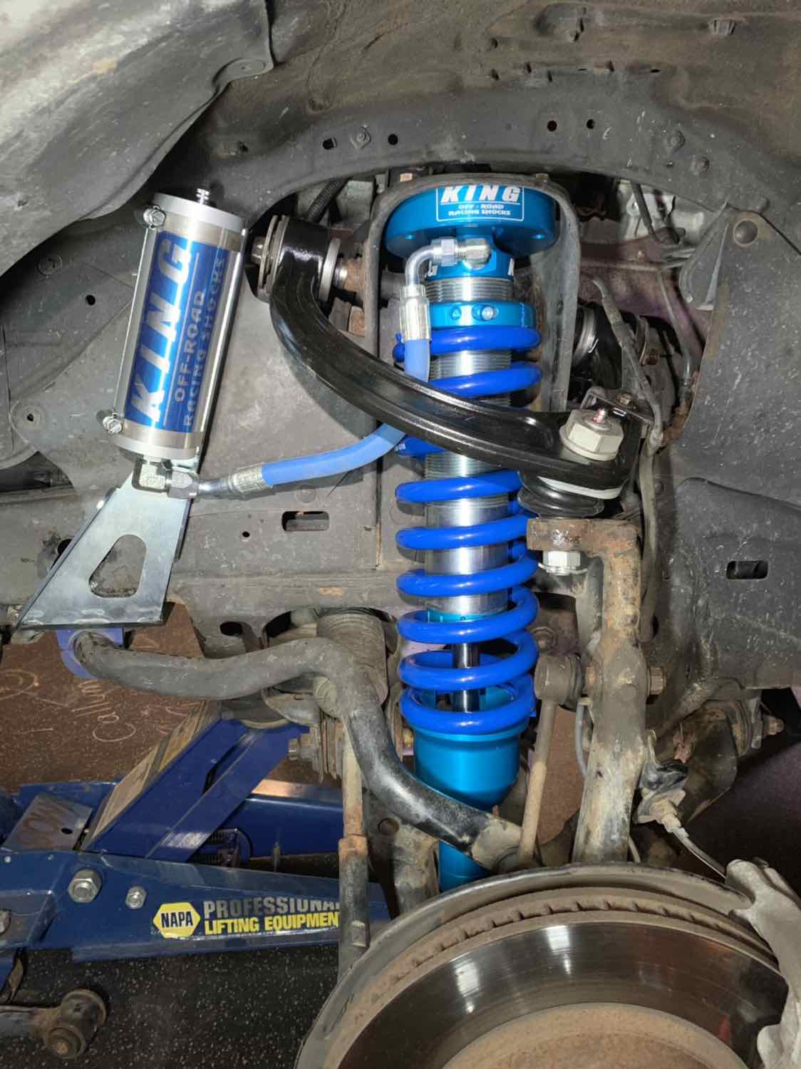

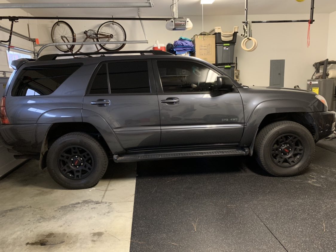

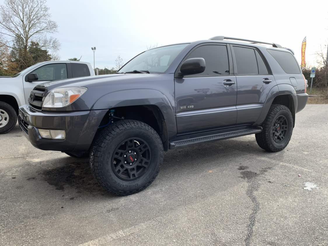

Finally got my kings delivered and installed it all myself in my garage. It was a long garage project as I was alone, but It was a blast and I’m extremely happy with the final product and stance. New tires are being put on today and I’ll post pics with those.
Data:
Up front - King 2.5’s with SPC UCA. 6 threads showing on the adjuster.
Rear - King 2.5’s with 1.5” spring spacer (I do not regularly carry a lot of weight so the bigger spring wouldn’t have been necessary yet).
Tires (not in this pic yet) 275/70/R17 Cooper discover A/T3.
I did not take measurements before and after but I am very pleased with the ride height and stance now. The new tires that I’m getting will give the final touch that I am looking for and then it’s time to go play.

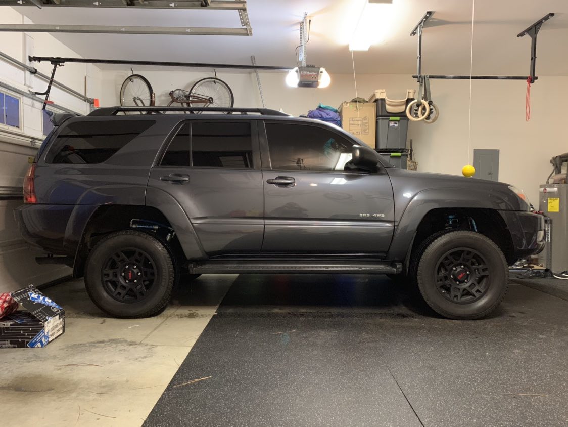

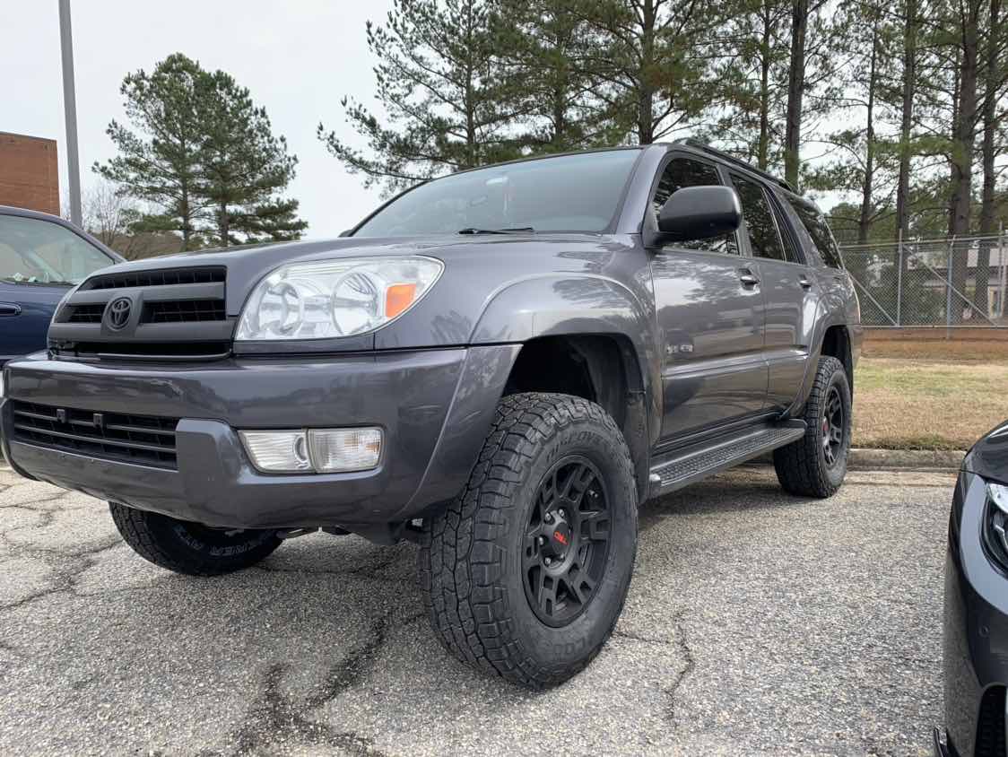

Cooper discover AT3 275/70/R17. Final product and I am crazy excited with the way it turned out. All the work done in my garage minus the tires.

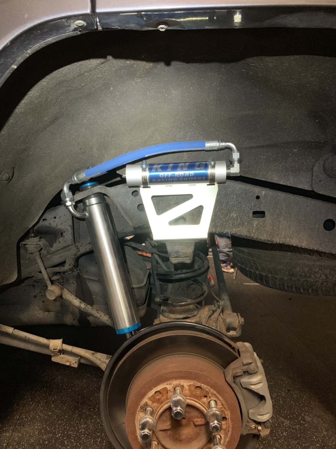

KING extended travel setup w/ adjusters
650lb coil front w/ superbumps bump stops + JBA UCAs
Rear Icon overland 3” coils w/ hydraulic bump stops
Truck flies over things now..
