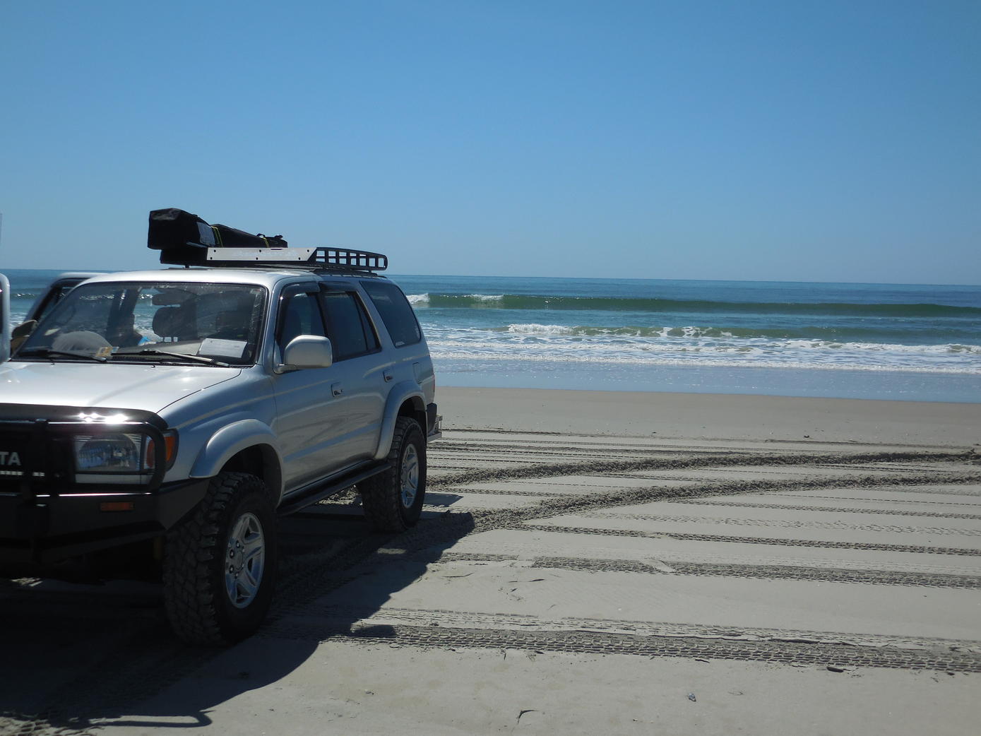

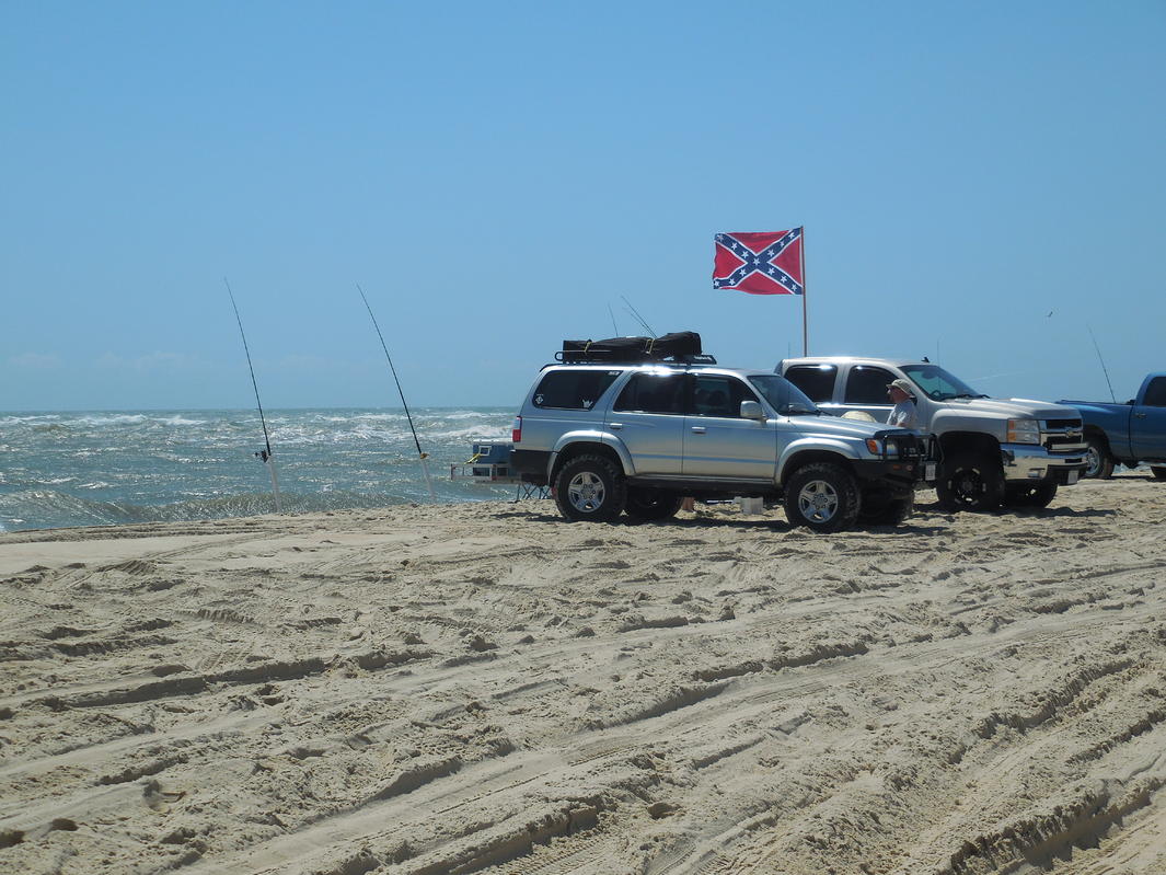

Some random pics from my last trip to the Outer Banks...
