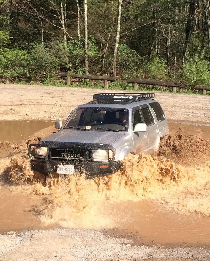

Hit some trails this weekend and got the truck muddy. My engine bay is filthy so I'm going to detail it over the next few days.

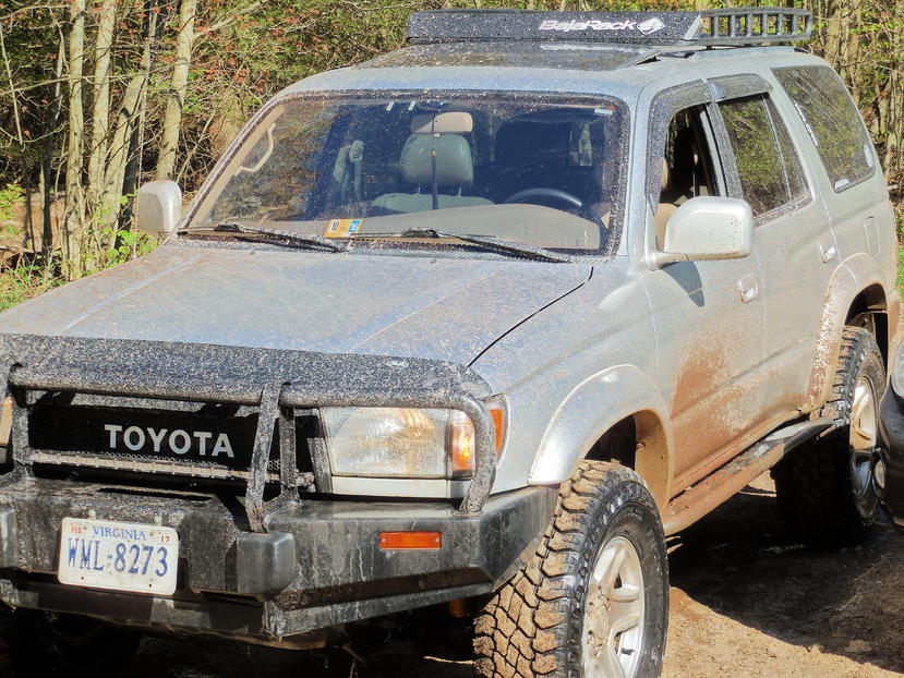

Gave her a good bath today and detailed the interior. Also installed Weathertech floor liners in the front and back.

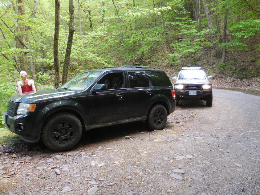

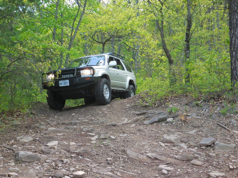

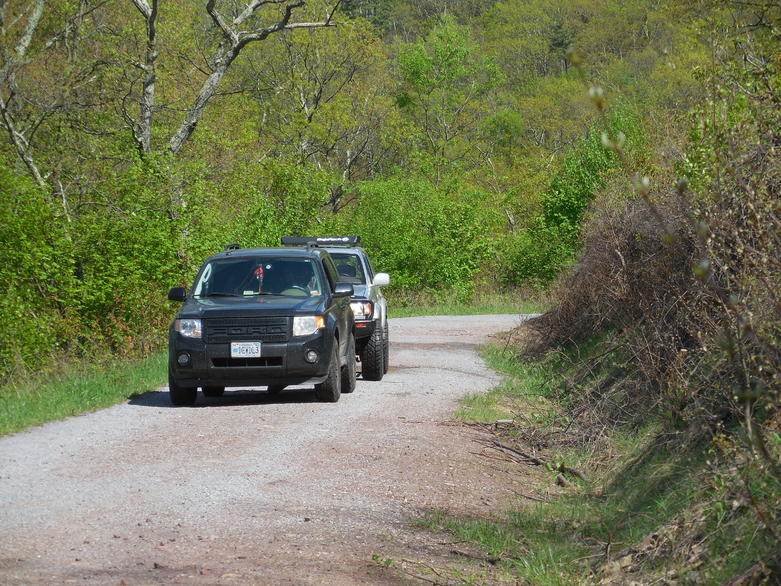

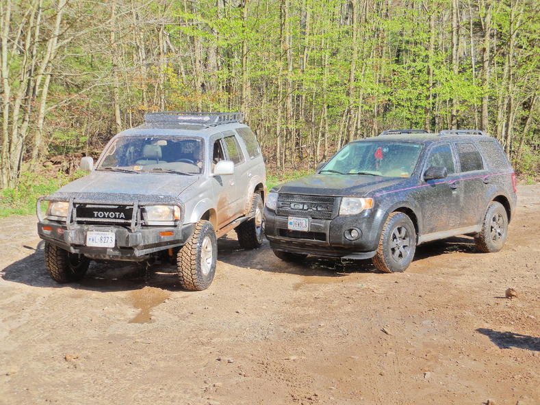

My best friend brought out her Ford Escape equipped with BFG Rugged Terrains. It seemed to do alright through the different mud holes we hit. I did hear the front end bottom out multiple times though haha

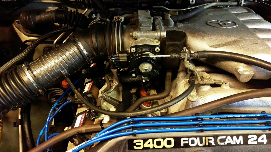

Today I did the ISR mod (Intake Silencer Removal) and took the opportunity to clean the throttle body.
Intake silencer removed:
Lots of carbon build-up on my throttle body:
Throttle body cleaned:
Used some vacuum hose we had laying around to connect the FPR to the rear of the plenum
Cut my piece of metal tubing (5.5" x 2.75") and painted it
Reset my EFI map and voilà!

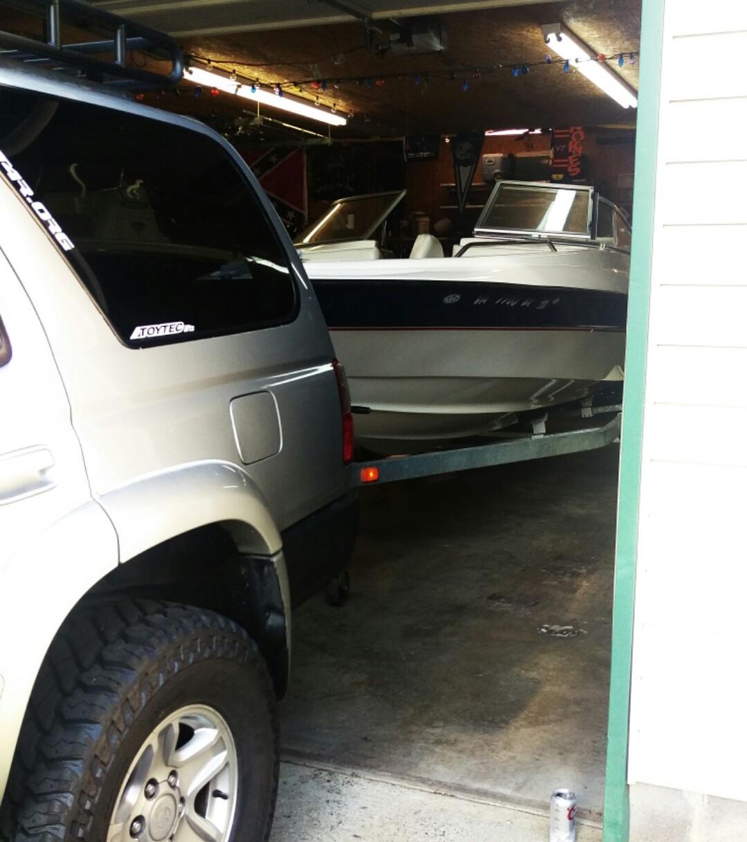

In less than a month I'll be leaving for the US Navy. I'm planning on parking the 4Runner at my grandparent's garage so that it has a roof over it and is out of the way. I have a new Koyo radiator I'm installing before I park it.
My father said he's going to take her out for a drive every now and then and keep the oil changed for me. He also said he's going to take it mudding and do jumps with it (joking of course). I said "that's cool just don't put any dents in it and if you blow my shocks replace them with Billy 5100's".

Today my father said "did you do something to your truck? I can smell gas in the exhaust". It had to have been how I routed the hose from the FPR to the rear of the plenum during the ISR mod. The truck was running rich.
I re-routed the hose from the FPR back to it's original destination (to the intake BEFORE the plenum). I feel better about it now. No more gas smell

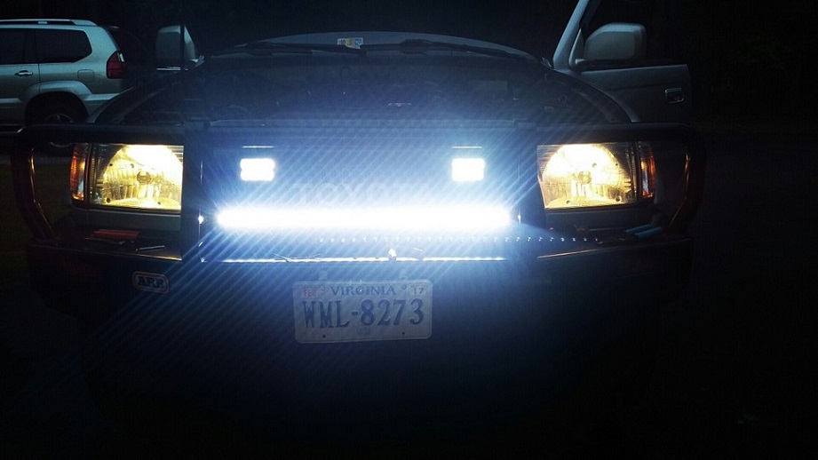

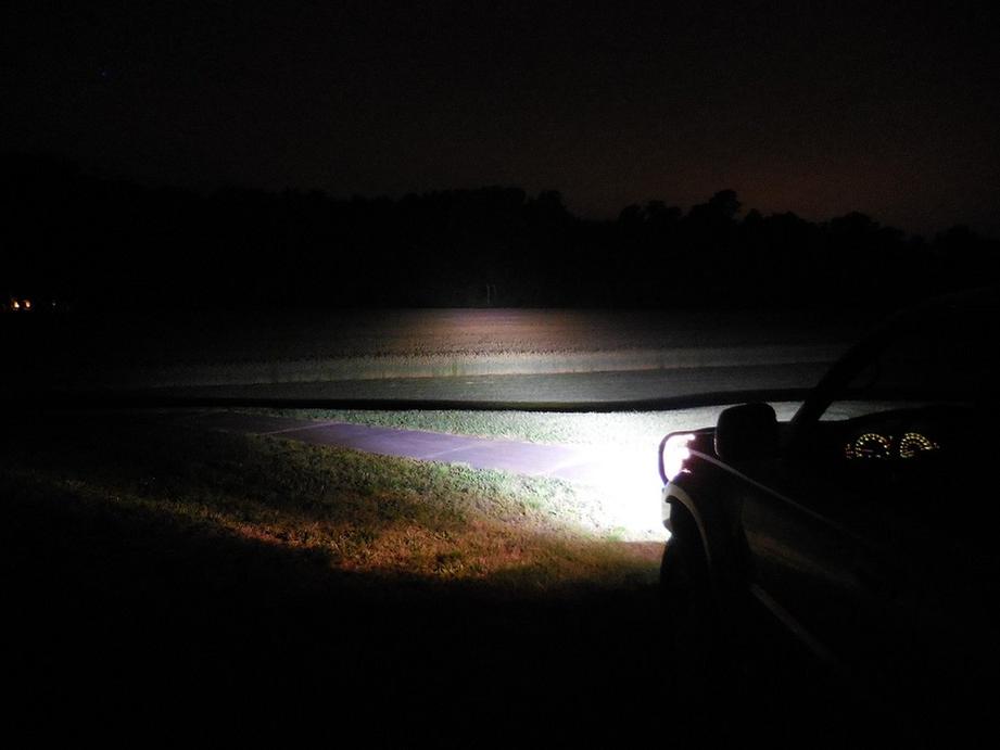

Installed two Avec LED spot lights to my ARB. I rigged them up to the same switch that my light bar is connected to. Everything comes on with the single switch :)
