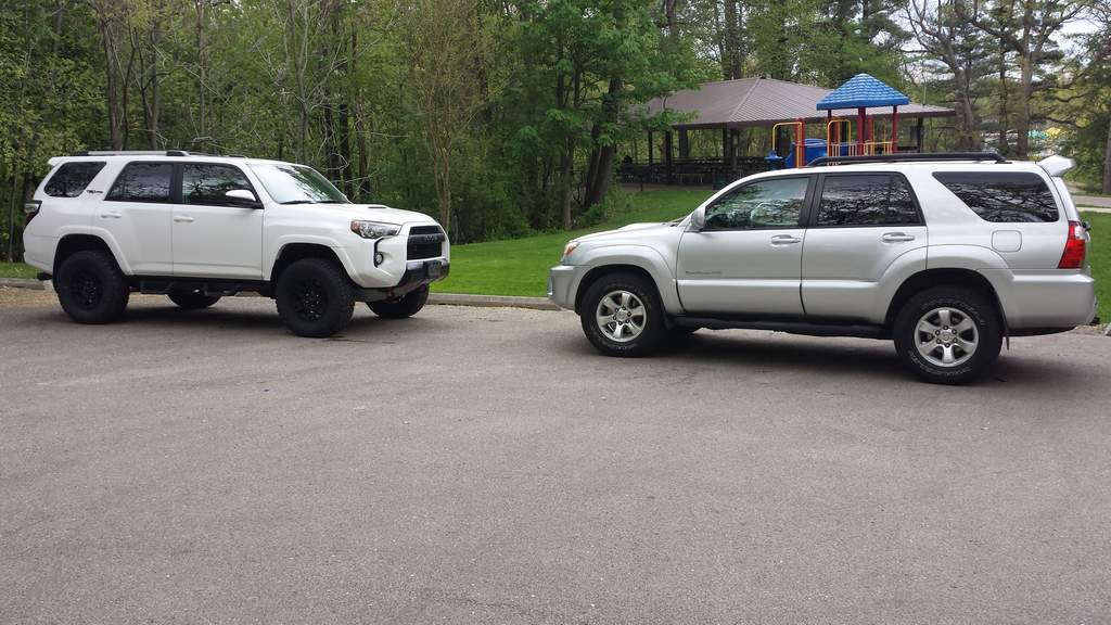

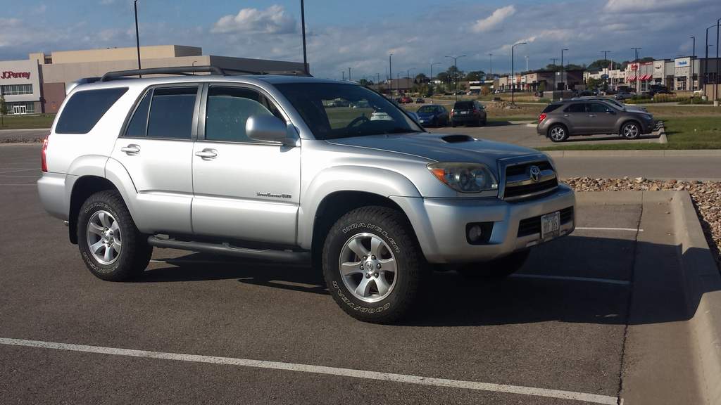

BEFORE KYB:
AFTER KYB:
So the before image is with a blown strut on the stock suspension with 200k miles.
The after is with the KYB shocks installed in the front and back. With the same rubber, different rims. No spacers, all suspension lift.
It resulted in a significant lift and level for the front. I didn't bother measuring unfortunately. But that can give you a bit of an example of what you may get on your rig.

yes the kyb did add some lift to the front, mostly due to the 10% stiffer than stock new springs vs the 145k originals.
the lift from the KYB doesnt totally level the front but does raise it back to new height plus a little more. the pics above are a good estimate of the lift & here are a couple pics of mine (after & before) last year about 1000+ miles after the lift & it still looks & measures the same today so any settling is minimal & will happen in the first 500-1000 miles. same 265/70/17 tires & no other changes to suspension. stock rear springs.
if you want a true level i would suggest installing the kyb's without the front spacers to see how you like it after a couple months, then since its so easy to reinstall the spacers, do that if you want more lift.
