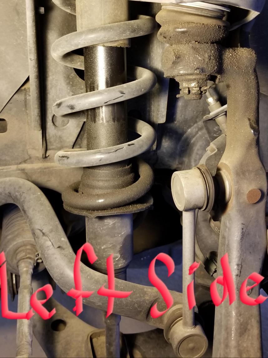

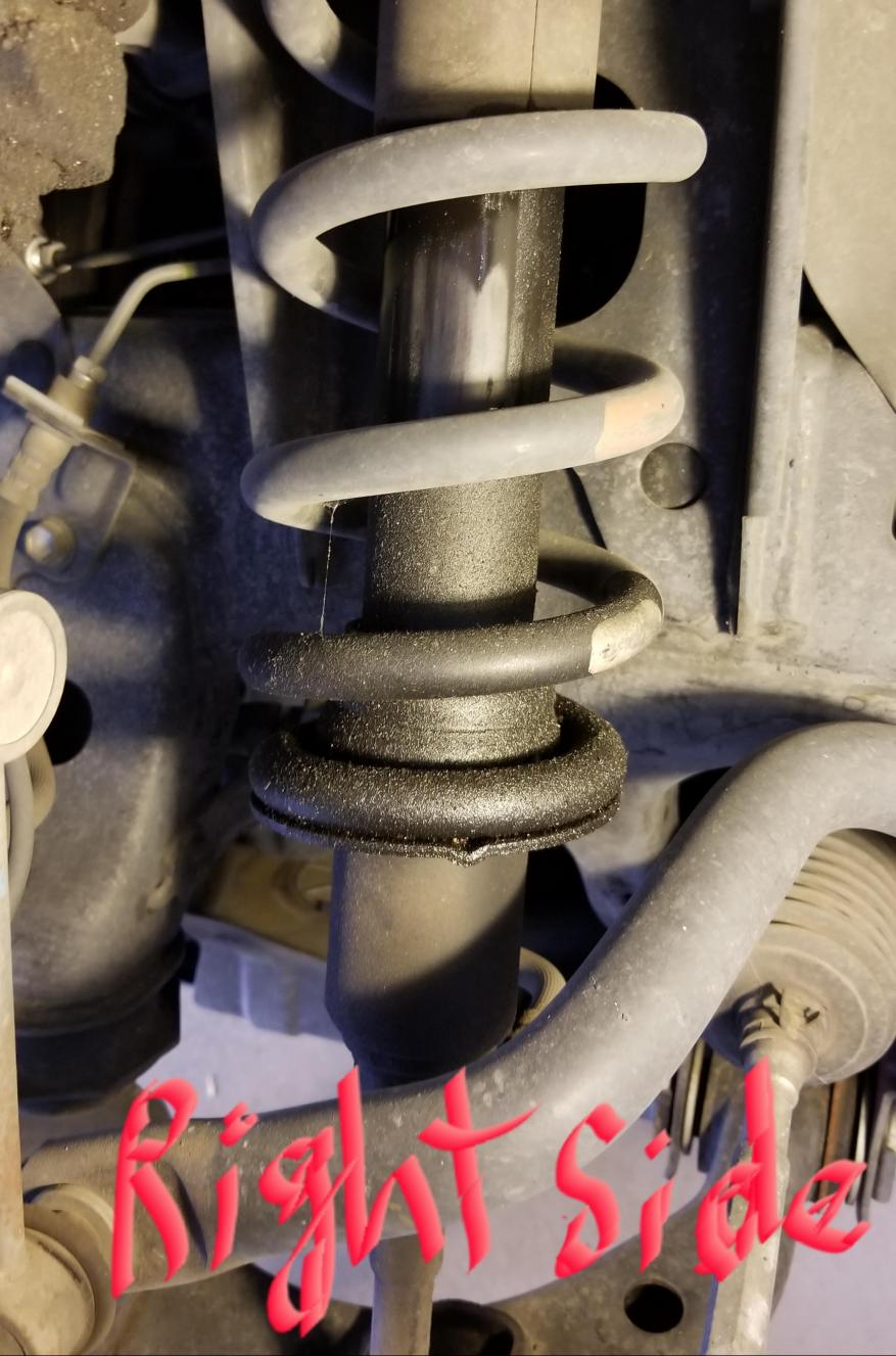

When I went on Amazon to search for KYBs, they showed shocks without the coils for my truck. Do I not need coils? Some websites show shocks and coil as a single unit. I also read somewhere that KYBs were stiffer than Bilsteins, which is not what this thread says.
I don't do any off road driving and no such plans. I need a comfortable ride that's composed and not bumpy! So if someone would advise as to what would work for my truck, or if I even need new shocks, I'd be very appreciative.

I also have the XREAS 2WD. On my fronts, it's very noticeable where clearance between fender edge and tire is like 3" but on rears it's like 6.5," and I'm wondering if my shocks are shot. I've attached pictures showing front shocks. The right side has more "sweating" than left. The ride feels balanced, but I'm relatively new to this truck and not sure what the norm is.

i will try to address most your questions: the difference in height you have is from the original worn out front springs sagging & looking at your pics the shocks are definitely leaking, not sweating, they are shot & need to be replaced. most people & even some dealers suggest removing the xreas & using standard shocks. new xreas system is $2000+ as you found... just not worth it. you can convert to factory toyota non xreas shocks, many people pull their stock ones to upgrade & they sell for cheap. or you can get aftermarket like KYB, monroe or bilstein. monroe & kyb are very close to stock ride & are not harsh at all, bilstein are usually intended for off roading & are stiffer than stock. if you dont off road & its a 2WD then i would suggest finding low mile used toyota shocks or KYB. monroe get lots of bad reviews for being too soft & after some miles & time that just gets worse, the kyb are slightly stiffer than stock but still a very nice firm ride & will allow more time/miles before they start to sag or soften up.
you need new coils on the fronts, called coil over shocks, monroes term is quick struts but these 4runners dont use struts. if the rear sits high you dont need new rear coils, just the shocks.

One oddity I noticed...it rides higher on one side by 1/8inch. ..measured from tire to fender well.
A shop noted that can happen with shocks that are older, they said they always check to see if same age/lot. I didn't do that...ordered from rockauto and just put them on.
I guess other possibility is springs worn differently.
anyone experinece this? Maybe the installer is going nuts.
Driver side lean is a thing. Driver, fuel tank, battery, front diff are all on the driver side, so it will tend to sit a tad lower. Every off-road lift manufacturer makes their own flavor of lean correction spacer, usually like 15-25mm but some have needed more
