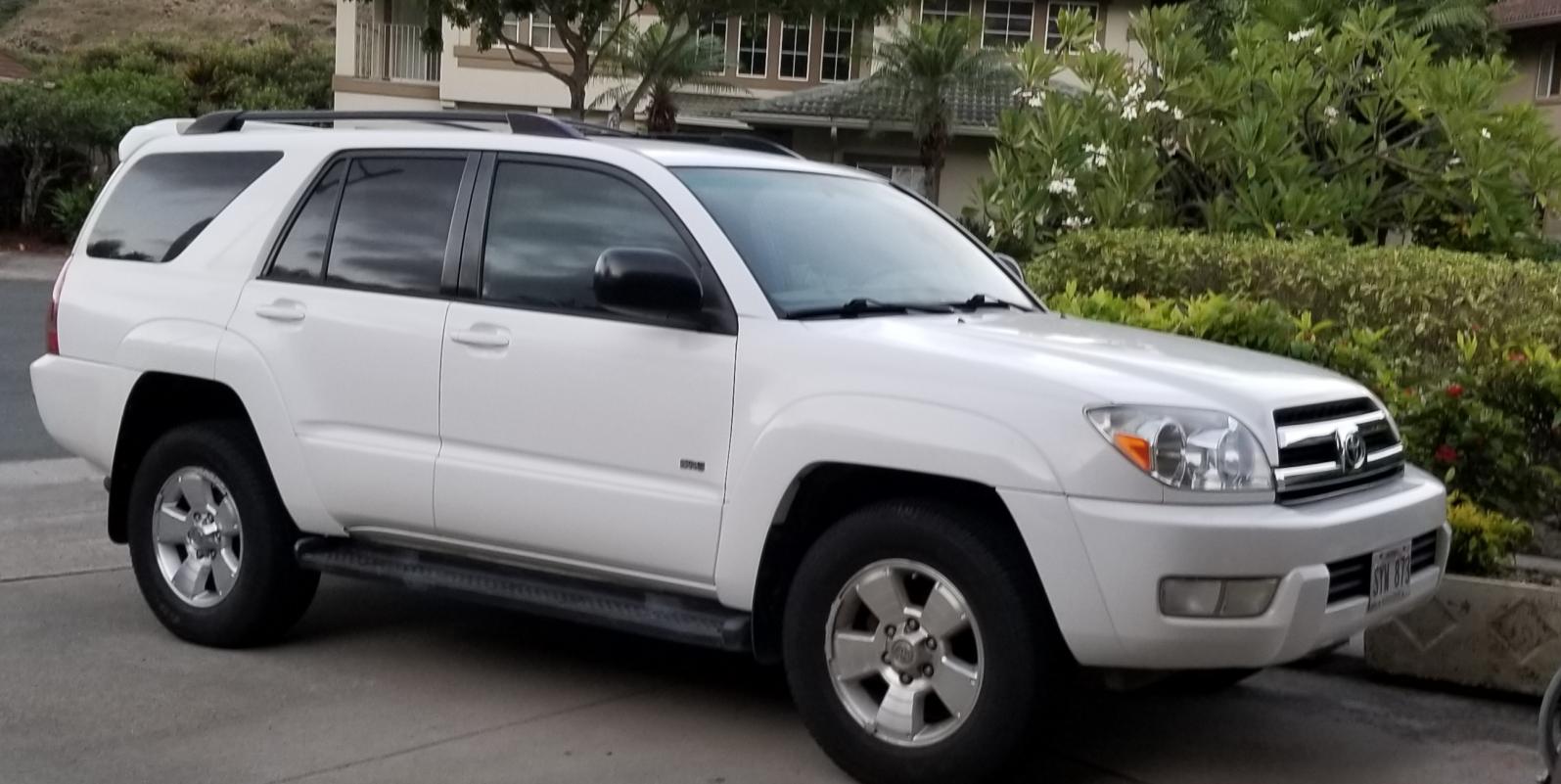

I have a 2005 t4r sr5 2wd and wanted to know If the kyb strut plus lifts the front? Not looking for a lift but hearing that it gives a lift upfront. Does anyone know how much? Don't want the front to be higher then the rear. I want to replace all 4 ahocks.
Thanks
This is stock with 188,000 miles

i think it will be ok with the 2wd. it takes about 500-1000 miles to get it to settle & after that its about a 1.5-2" lift at the front fender lip. it should sit close to level after.

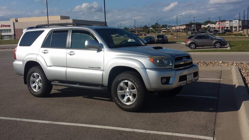

i just did all 4 shocks on my 08 with worn out xreas, im happy with the small lift & they ride surprisingly good.
