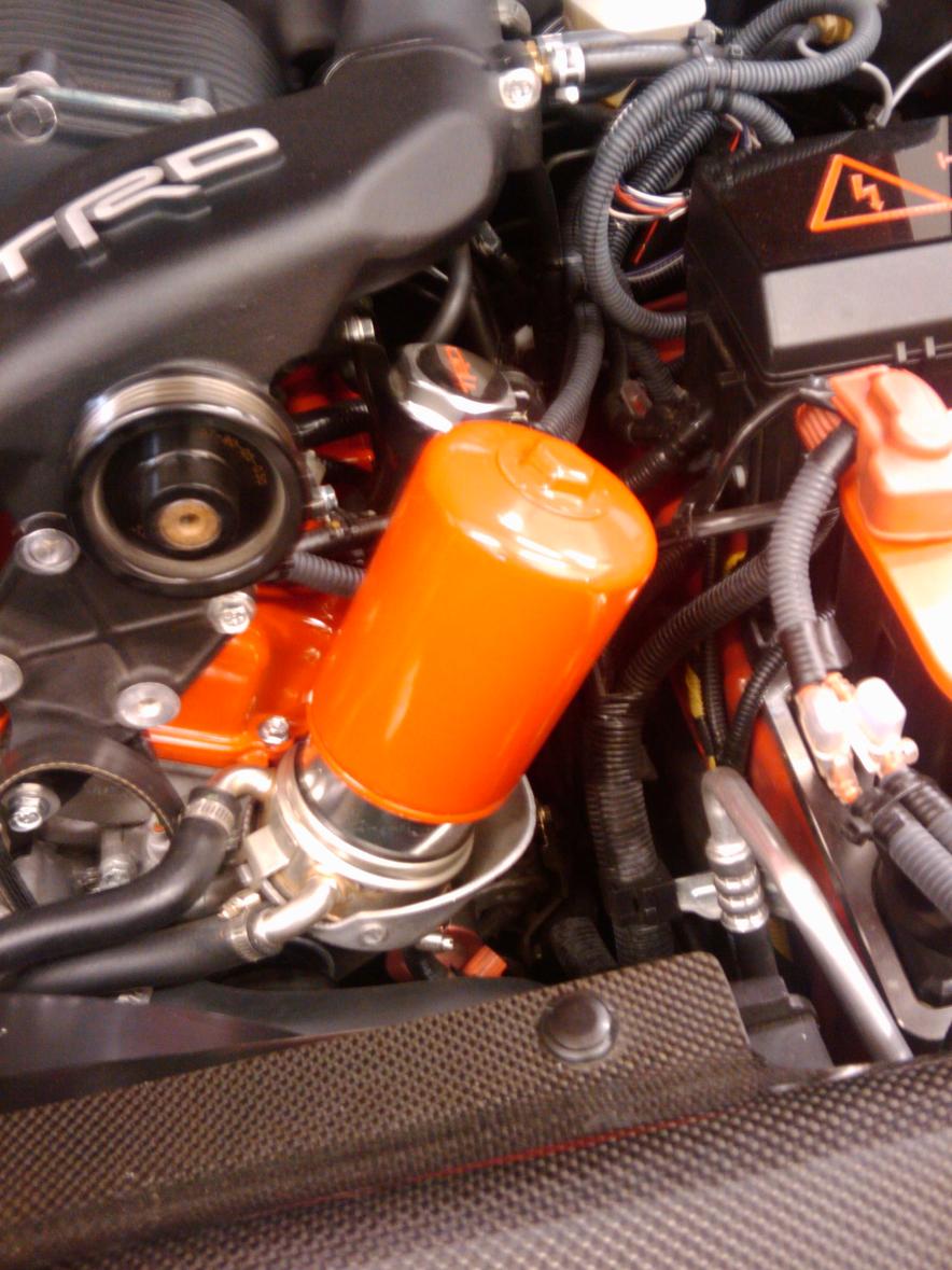

This ones for you CJ3Flyr. When I was putting my APR X1 on my truck I saw the tacoma with the V-8 oil filter. A got a pic for ya! The truck was in for a T-56 transmission. Hope it has some usefulness to you. If you want some more info I can talk to Mr. Phillips.
