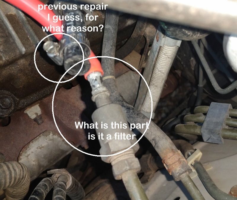

In my quest to find out if it was pumping, I located a line under the hood I guessed to be the fuel line. It has what appears to be a filter on it where it goes from steel line to rubber. It appears to have been worked on before because it has a screw clamp. I will try to add a picture here of what I am referring to.
We took the connection apart and connected the red fuel line to it to see if we cranked the engine, if it was the fuel line, and if we would get anything.

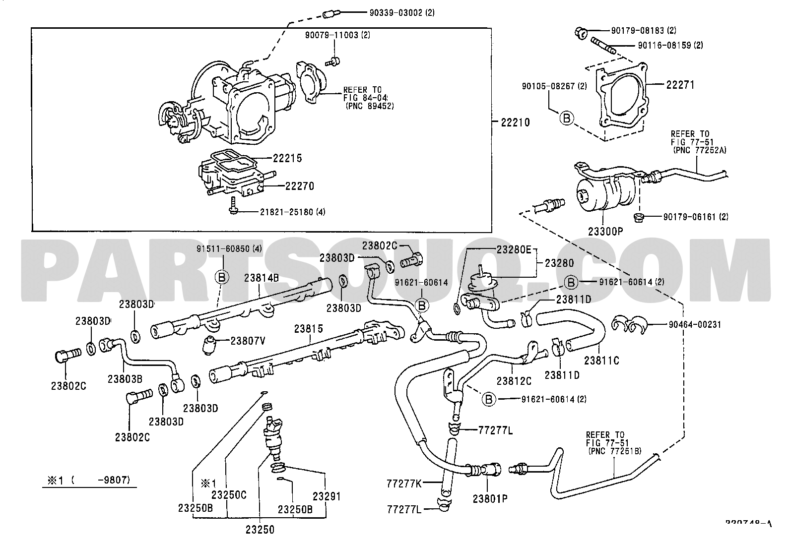

What you show in the circle in the above post should not have that clamp. It is a pressure line and should be like a power steering pressure line. Replace that hose with an OEM fuel pressure line (item 23801 P at bottom) Check these part numbers 23801-62070 or 23801-62071.

I can see in your diagram, that what looked like a filter on the line was really the end of the line from the fuel rails.

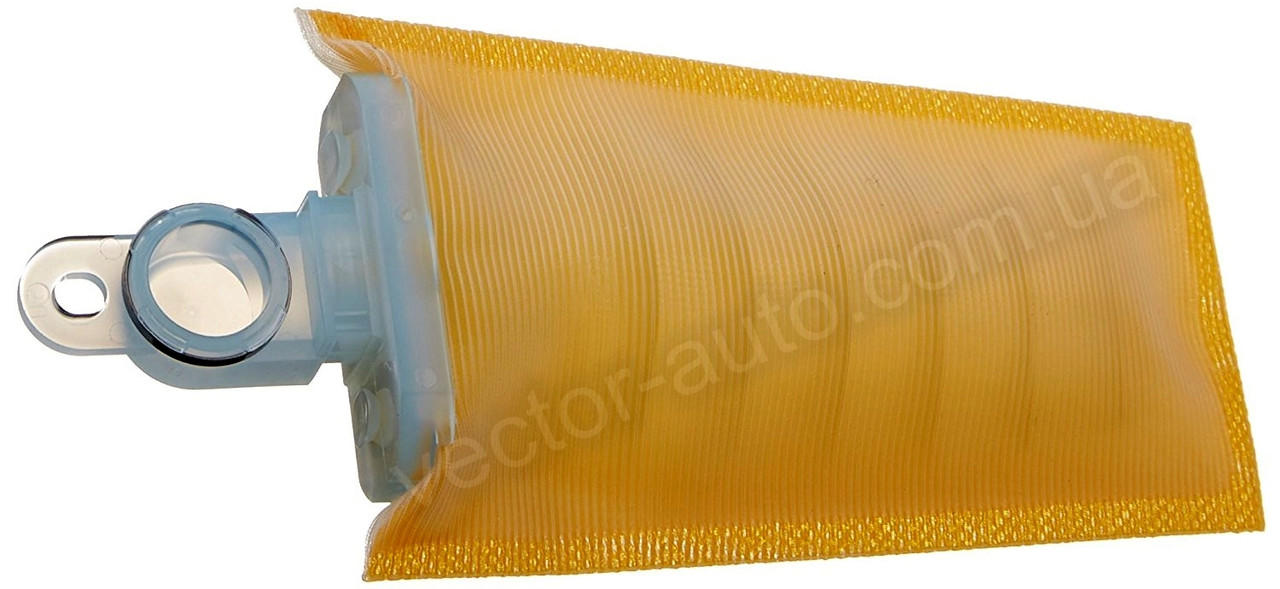

But, to answer your question, that strainer is pretty fine, and if you got cruddy gas, say from the bottom of a rusty station tank, I can see it getting plugged up:
