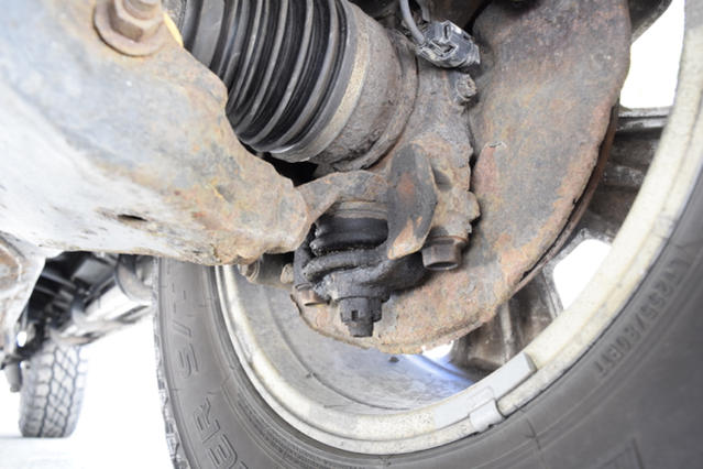

One of my front lower ball joints is torn, the rubber part, and some fluid/grease has leaked/is leaking. I assume it will need to be replaced at some point.

With all that said, what is the harm of driving with the torn ball joint for the time being until replacement? When it gets to the point of "failure" what exactly could/would happen? I'd think not, but would failure of the ball joint harm any other parts? Thanks everyone

Complete vall joint failure. You have no idea what's going on underneath the boot.

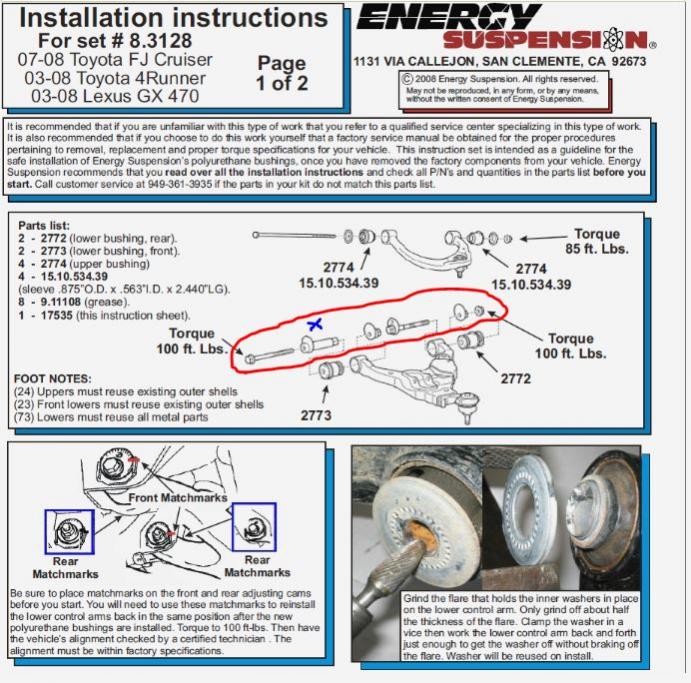

Can anyone confirm the cam bolt parts needed for this? I ordered the SPC replacement ones and I feel like they are different than the ones circled in red in this picture. The part marked with the Blue X is what I'm unsure of.
You may want to call Energy Suspension and ask them what that item is for, that diagram doesn't look the same as the diagram for OEM does, if you look at the diagram at the link below you will see what I'm saying.
Scroll down to the bottom of the page to see the diagram with the cam bolt.
Front Suspension for 2004 Toyota 4Runner | Toyota Parts
So the kit that I got from SPC looks like the Mevotech kit in this link at Rock Auto. Notice that some of the other kits on Rock Auto show sleeves (assuming greasable), but the one I have does not. Without a sleeve there is a lot of play in the UCA where the bolt slides into the arm. So I'm not sure what I'm missing. But Rock Auto, Wheeler's, Amazon, etc all show the camber kit that I have as being compatible.
